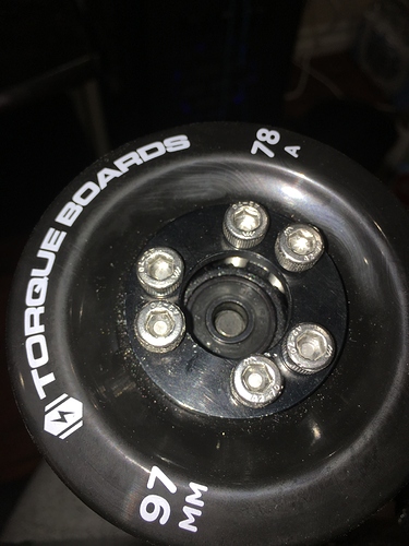

Hi ya’ll, first time DIYer here. It’s taken me a while to try to solve this problem on my own but I cannot figure out a solution.
I put on my bearings and spacer in my motor wheel correctly (I hope?). But when I am trying to put the motor wheel onto the truck, it takes a lot of force. I can slide the belt on pretty easily by turning the wheel pulleys a few times and it latches on. My problem comes from trying to push the wheel in further onto the truck.
In the picture, you can see the point where I can put the wheel on the truck fine up until the truck bolt reaches halfway through the wheel. Right about there is where lots of force needs to be used to squeeze the wheel onto the truck. (This could be the problem - why do I need so much force onto the wheel?) You can see that I took off the wheel halfway through the installation and the bearing is already out.
Previous times, I’ve put the wheel and belt 100% on and installed and after about 10-50 full turns of the wheel, the bearing clicks again (I’m assuming it’s the bearing since when I disassemble it and turn the motor alone, it is fine).
I’m thinking I am doing something wrong with (1) applying so much force to install the wheel on the truck or (2) the 280mm belt is really f**king tight when fully installed. Maybe it is pulling back on the wheel and popping the bearing out?
I get clicking when my belt is too tight. Does the wheel go all the way in without the belt? If it’s not that, have you tried putting just a single bearing onto the truck? Possibly a bad fit?
If you put the wheel without the belt on the axle and spin it does the pulley seem to wobble? Maybe unbalanced pulley with tight belt makes that sound?
Belt is definitely too tight. I made this mistake when I built my first board

Looks like your wheel pulley is a bit crooked. Adjust it to make it parallel to the wheel. Try not to over tighten it either. It’ll work the core.
it does wobble a bit but I would try to loosen the belt a bit first.
maybe if you overtighten a bit too much some of those 6 screws it compresses the area where the bearing seat is and could be an issue but I am not an expert either. I would try to re install the pulley tightening the screws firmly but not so much that it would wobble like that. and use loctite which needs to cure 24 hrs (or was it 48? never remember)

yeah fix the belt first, it might solve the clicking issue
The belt should have about 1/8"-1/4" of give is you push on it lightly.
