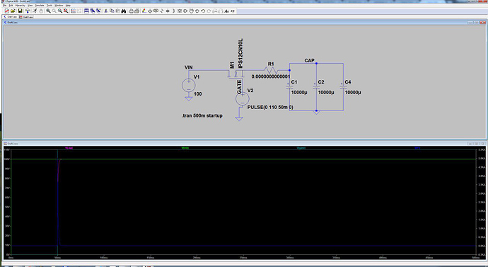

Inrush current has nothing to do with motors and etc, it depends on capacitance at power stage on ESC. When you power on the ESC because of super low resistance in the capacitors current in rush to charge them. In my previous calculations I don’t remember now exact but I think inrush without any limiting can be up to 1.5kA - 2kA for less than 100ms. That is time when switches die because of mosfets working in out of SOA (Safe operating area) range.
You can simulate this by using any spice
EDIT: I lied it can reach even 5kA :smiley:
