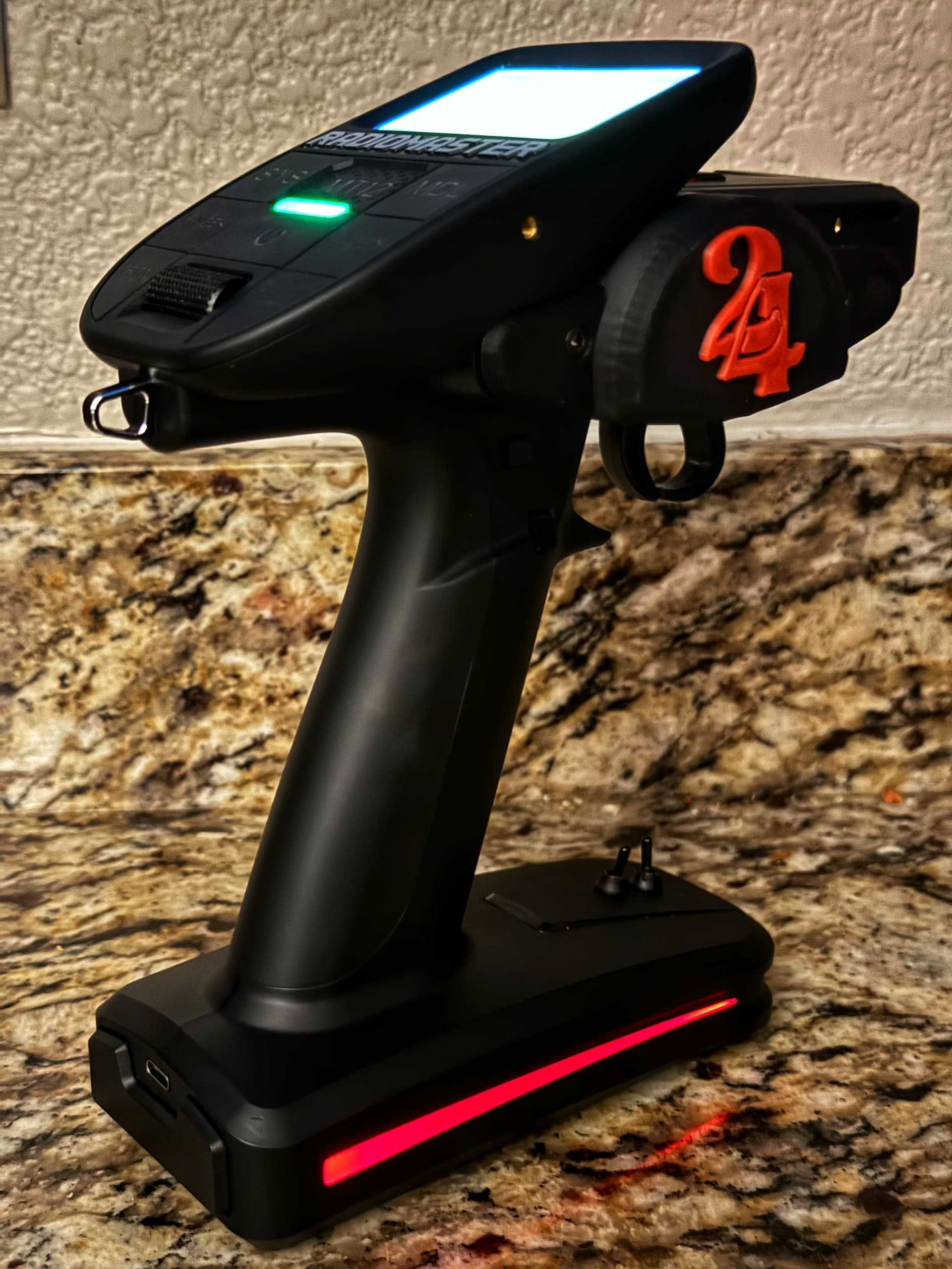

To be fair I feel like there just isn’t much info on the remotes currently available.
Frequency hopping makes too much sense to not do, so I would lean towards most remotes doing that, but to find that in writing I think is impossible.
I think a good example is the Puck and how its bascially the #1 choice for most people and no one knows what the t button does, and doing research on it wont give you an answer either.
Its like all the good remotes come in smaller batches/companies and less info and the worse remotes come from larger companies and with more info
think some people were having issues with the vx4 at qualifying. fortunately never had issues with my zmote, not sure if anyone else did tho

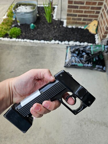

Today I turned too hard and stumbled off the board. My initial reaction made me almost drop the remote, but then since I almost let go of the remote I could not break and the board hit the curb, getting a scratch.
If I had a wired remote that provided some support for itself a bit like the TLT board it would have been harder to lose grip on remote and control of the board.
See this clip
then you can connect it to the steering so you can use your hands to turn and have something to hold on to

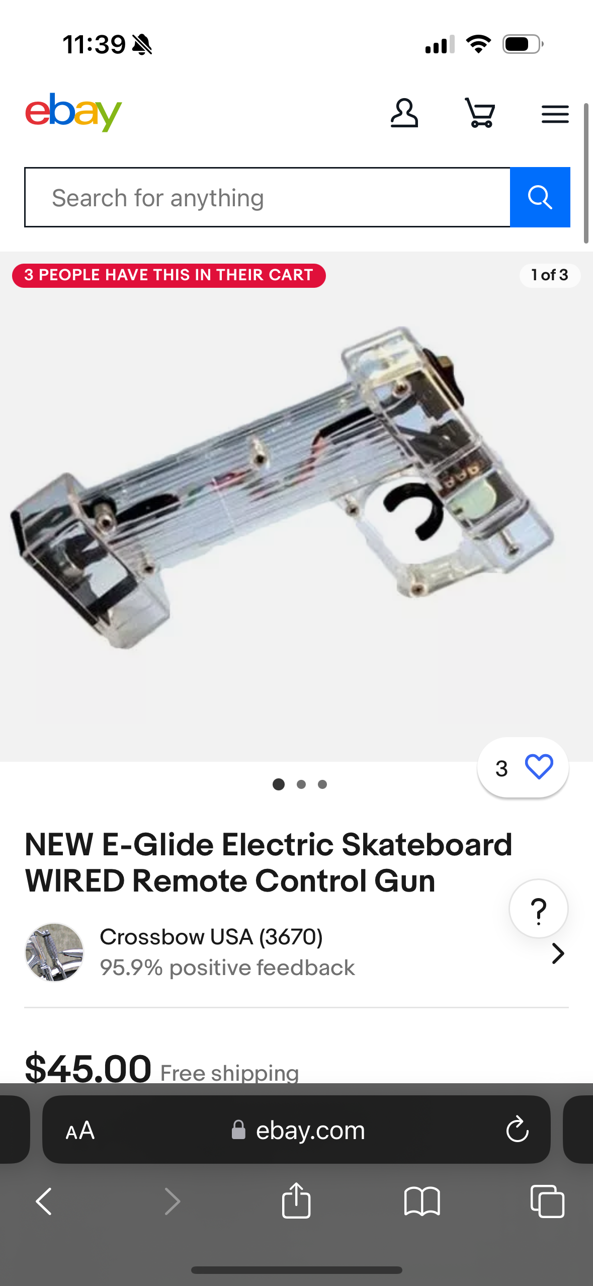

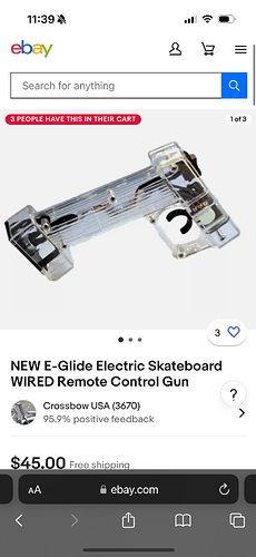

Anyone ever use a eglide remote and know the connection type?
Hey… That mold looks familiar
Is it vesc based?
he’s got castle.
been thinking about the lack of ADC…
he’s gonna need a analog to pwm output.
Like Fess said I’m on castles and mamba XLX2 and I’m pretty sure the eglide wasn’t vesc.
I am looking for one of these, or a way to do a conversion. I have an E-Glide Dewey Weber I want to get running. I just wanted a cool old electric board but it looks like I bought a project.
