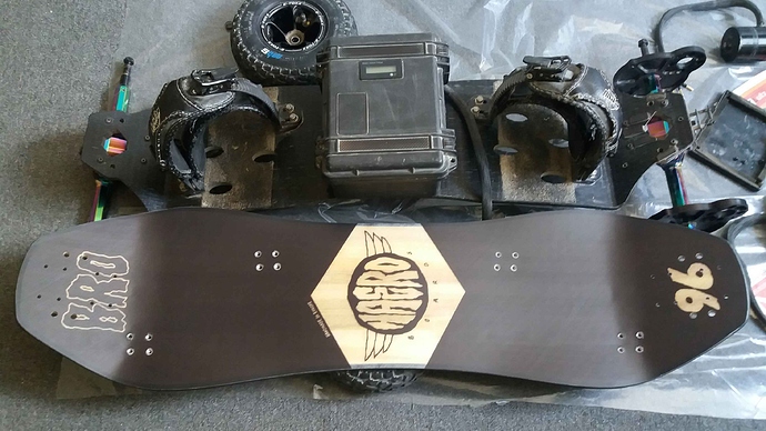

Enough pics? :laughing:

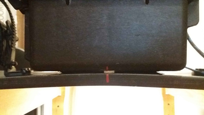

I use just 2x 3.5cm velcro stripes and can lift the 19kg board holding the enclosure only, it’s very strong and not easy to separate. I made the mistake to cut them the same length on the enclosure. When separate them the velcro on the deck starts to peel off. If the velcro is slightly shorter on the enclosure this won’t happen.
Due to the camber it is important not to have velcro exactly in the middle otherwise the Pelicase would wiggle. I tried different spacings and 3cm gap worked best.
