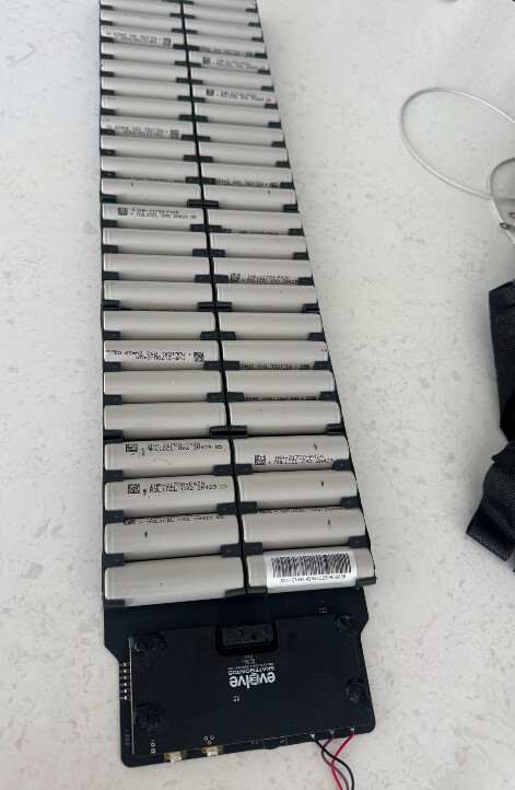

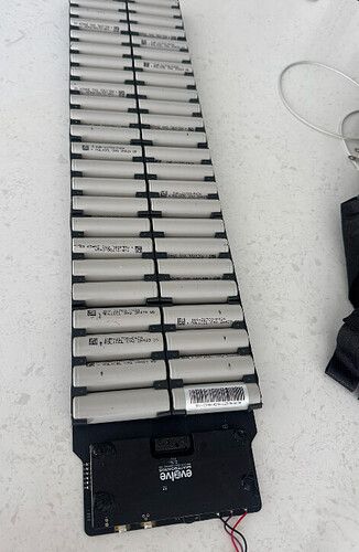

  • 12S4P won’t fit with the BMS and makerX- tried everything and finished with 12S3P. Evolve did it as a multi layer of PCB *

Thanks Guy. I was thinking of keeping the 12s4p and adding a home made “module” on to the battery/esc moulding.

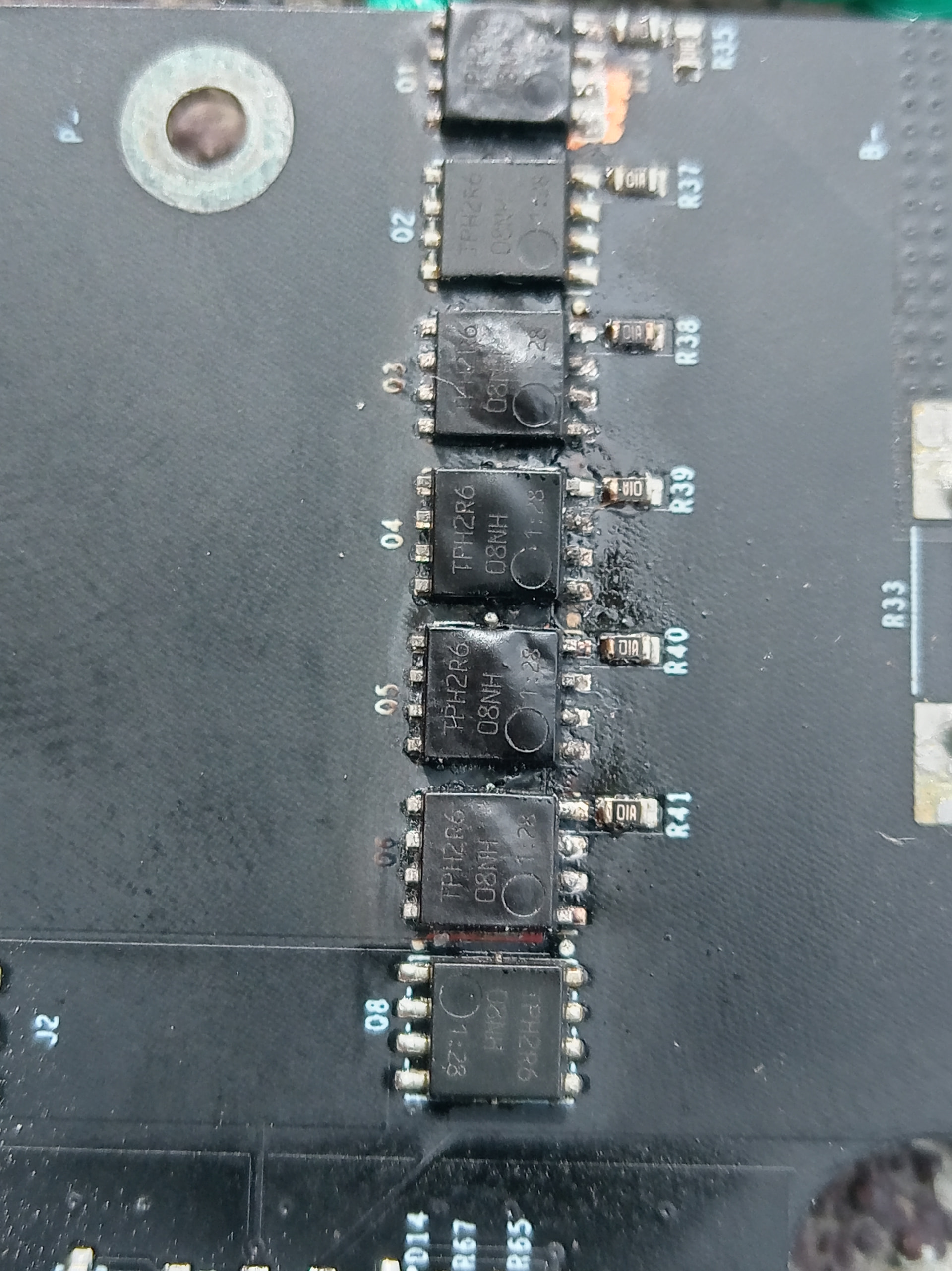

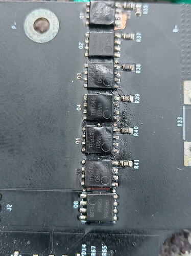

Basically, going to bypass the Evolve BMS and remove the BMS PCB (I think it is damaged anyway, it’s not working at all, and pretty sure most of the Mosfets are damaged), as well as the ESC pcb (i think the esc pcb might still be ok just not receiving power from the BMS) and the LED board (not particularly concerned with the LEDs). With those parts removed and some moulding removed I think I can just fit the MakerX. And just put the Bluetooth module and fuse and new BMS in the new compartment.

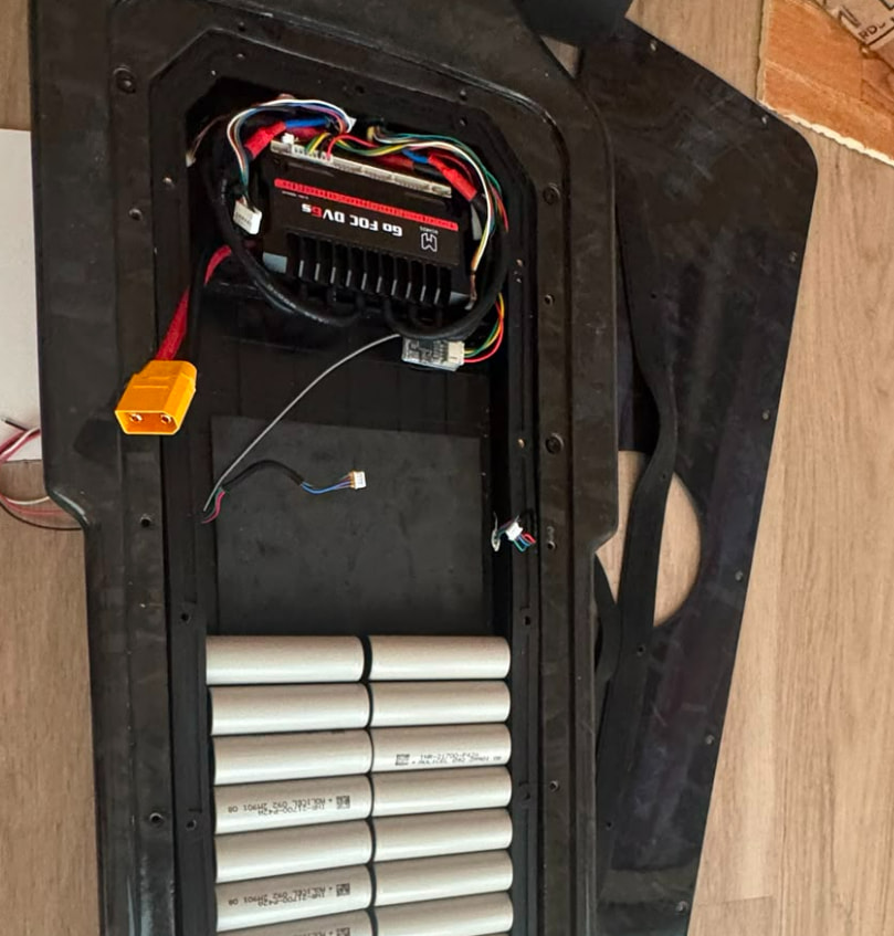

Adding a picture ot the original Evolve battery, and the Hadean with the maker X
as you can see the makerX is located where there is a stack of the battery PCB, BMS, and Evolve ESC.
it mean that the Maker X will collide with the battery PCB when you try to close it.
