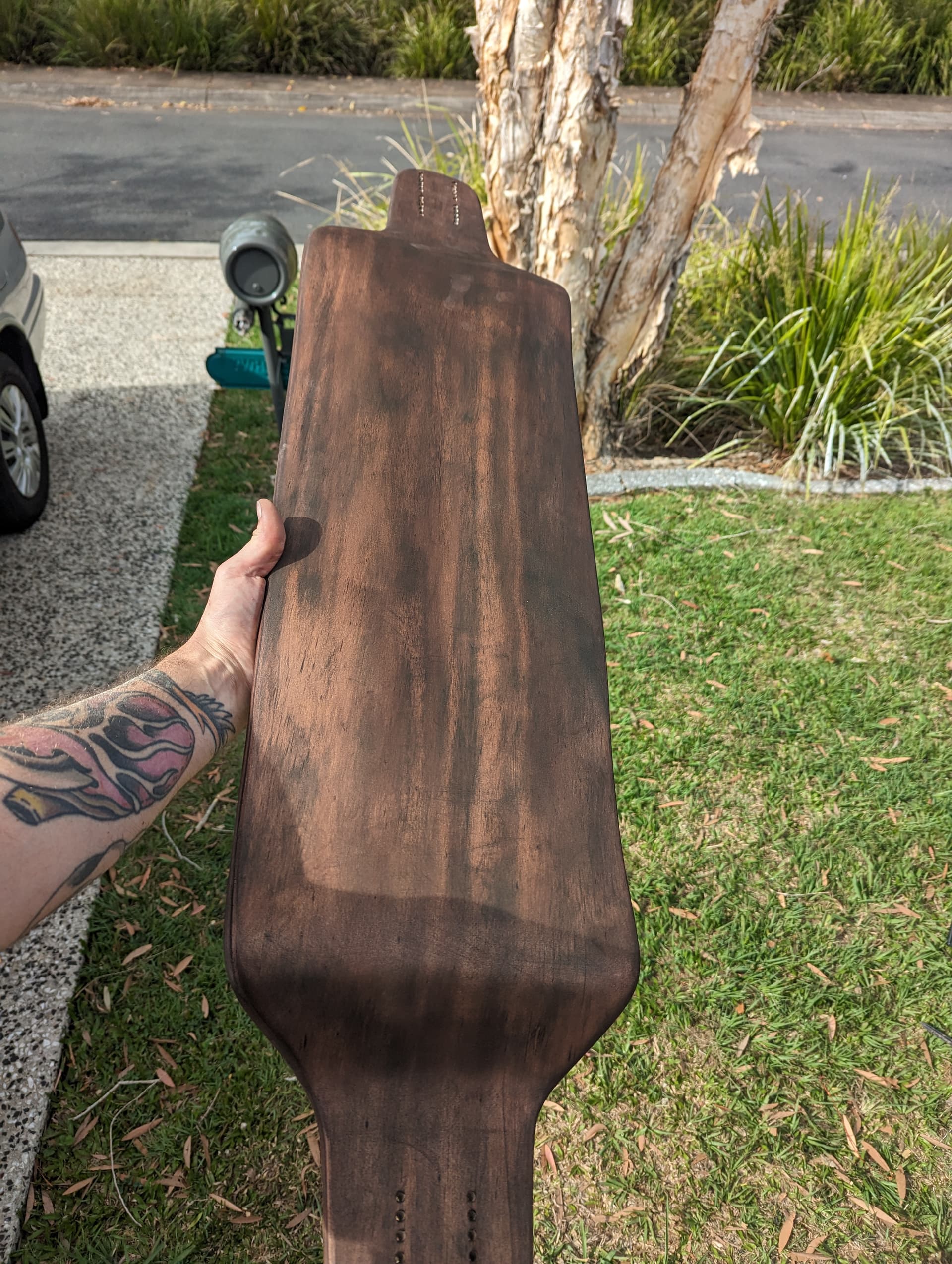

The deck
Bustin Royce pro 37’
This things super nice to ride it’s a great size board yet is way smaller than I usually ride so it’s a totally different ride style for me and I’m digging it. It’s also sneaky powerful on full power hehe.
