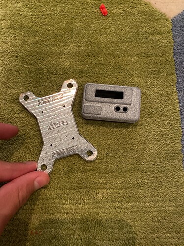

Let’s start off here with the GROUND CONTROL updates! (Pics included as well)

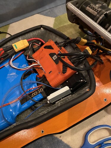

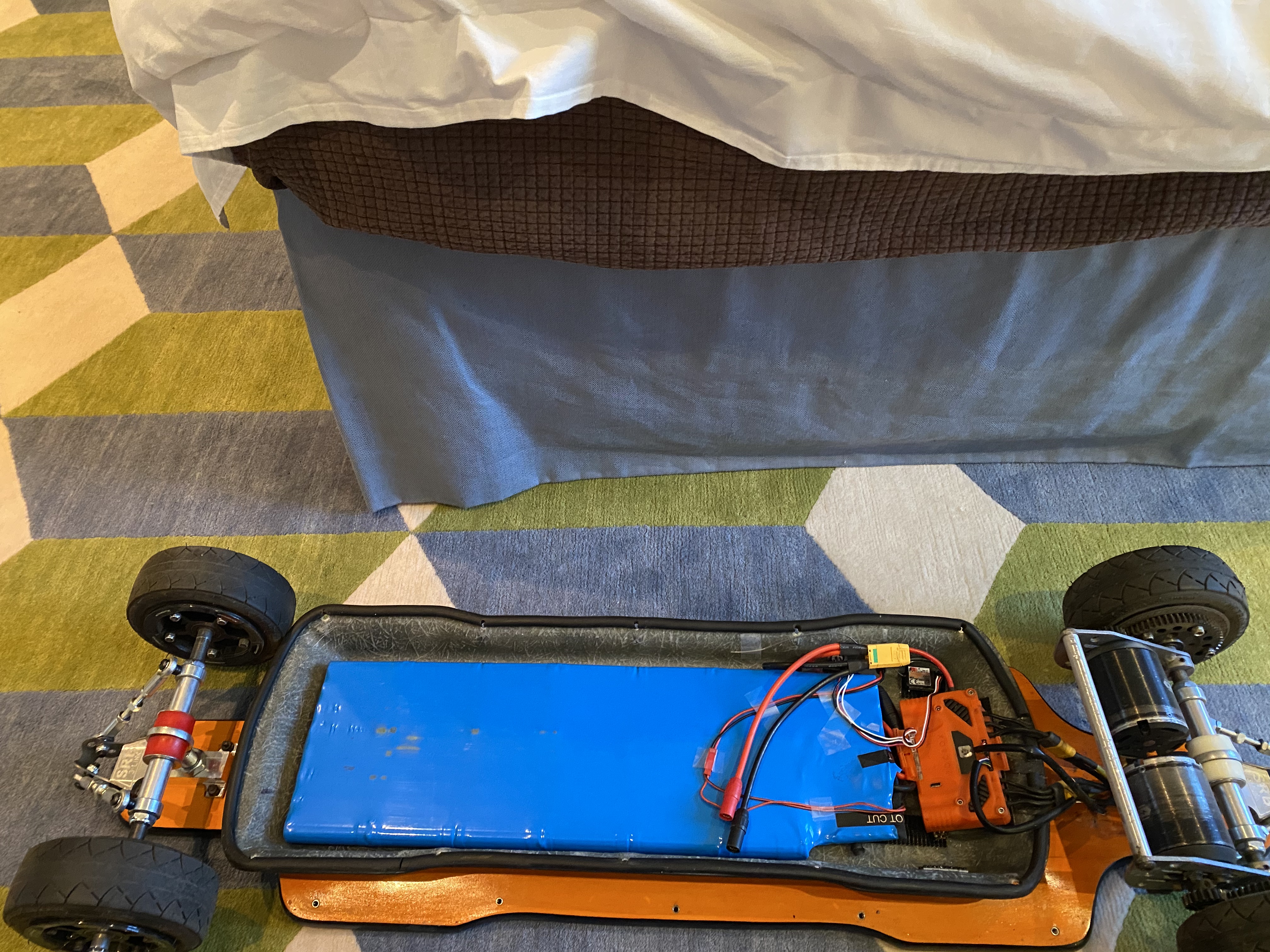

So ground control has been on the bench the past two weeks, I was getting around to cleaning it and setting it up for Barrett. Like usual I was lazy and kept putting it off. Finally it was Saturday and since Barrett is this weekend I had no choice but to get to working on it.
I opened her up and started checking all the soldering etc. Then I glanced over at the Robogotchi (@DRI @DerelictRobot) I thought to myself, ā€œHey it’ll be an easy plug n play swap.ā€ Boy was I wrong. I didnt realize that Robo only ran on 5.0 and higher.
So I popped out the Metr I had sitting in there, and plugged the Robo + GPS Module in. Now I ran into a roadblock. I only had the download for 5.2, which is not yet supported by Robogotchi. Luckily @SeanHacker @poastoast and @BillGordon all sent me a DW link for a Vesc tool with FW 5.1. If you were wondering, I used @BillGordon’s download link.
Now I haven’t ran Vesc tool in awhile, and Ive actually never ran the official Vesc Tool. Only Ackmaniac in the past. Popped onto the wizards and got the board running in a couple of minutes. Checked Robo and everything was running alright! Success!
Well I have a Beta Gotchi enclosure from a little while back as you can see in the photos above. I had asked @DerelictRobot for one of the MJF ones a couple days ago, and being the amazing vendor he is, he sent me an MJF enclosure + a beta X brace that Renee made.
I kid you not, 5 minutes after putting the last screw in the enclosure the doorbell rings and my mom yells theirs a package for me. I run downstairs and pop it open, much to the excitement of seeing a STELLAR looking MJF case and an X Brace. Buttttttt I have to wait until after Barrett to put it in because I didnt have much time left.
Now I haven’t test rode the board since putting FW 5.1 on it, but I’ve been told its a pretty safe FW as long as s DC is at 85%. This scares me a little but I have zero time whatsoever to test ride the board until Thursday, and of course its meant to rain on Thursday. So I’m a little scared about that…

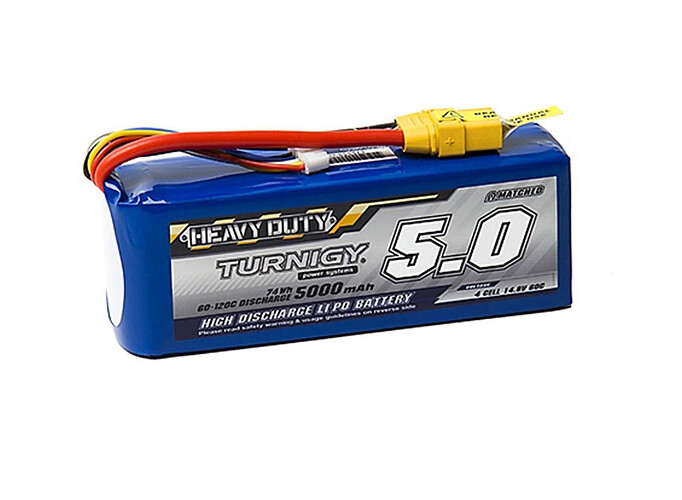

This is where I need your guys help… I would like to have a Range + a Jump battery, so I’m guessing one set of high AH Lipo’s and a set of Lightweight Low AH Lipo’s. What do you guys recommend Lipo wise? Along with that, EMTB dudes like @Rich @Venom121212 and @Andy87 would Velcro work to secure lipos to the deck?

I had a good result with those
Mine are 6s, but seems they don’t sell them anymore :cry:
Even in 1p config there is like no voltage sag at all. They do get a bit buffy over time, but in my case they are still ok.
Probably not as good and long lasting as the graphens or tattus, but they are also a good amount cheaper (speaking of regular prices).

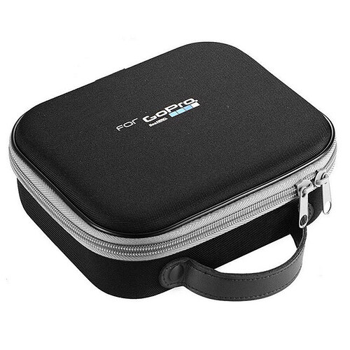

They do fit as well just right into those GoPro cases.
They are not really waterproof, but it’s fine.
I did fix those boxes with velcro and personally never had issues or something come lose. Just make sure the velcro sticks good enough to the box.
My suggestion would be, either you go multiple lipos in parallel. Like that you can split the pack if you want to get on a short jump session.
Or you just get a set of high C lipos in the 5-6.5Ah range for light weight and get a LiIon pack for range.
8p vtc6 or 6p p42 should be a nice pack and still jumpable with a bit practice.
