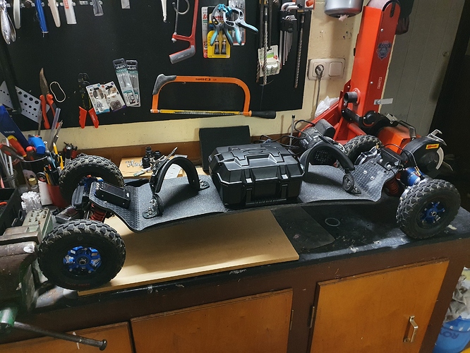

Enclosure upgrade, really like this drybox it looks pretty sexy IMO compared to the normal peli kind cases. Took me a while to find one I liked, glad I got something :slight_smile:

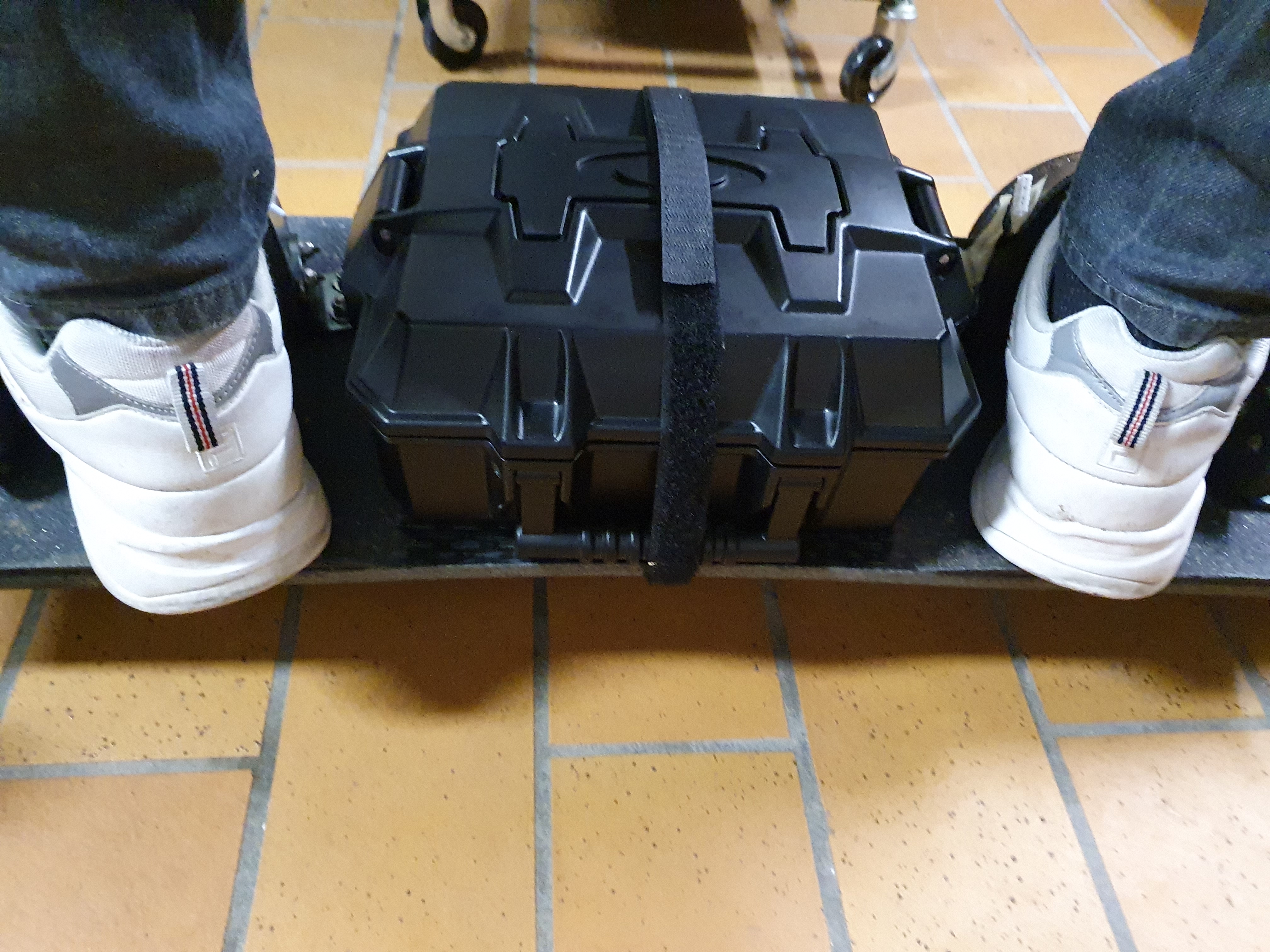

Still looking at what orientation to choose
ORIENTATION NR 1.
ORIENTATION NR 2.

Pictures are merely ordered differently, numbers stay the same for each orientation :wink:
I had the same dilemma. I went with option 2 on mine, but reckon yours looks better in option 1.
What case is that? I like it!
I’m gonna look at the foot clearance tonight to make a decision, but I like the looks of option 1 better.
I really like it aswell! its very good quality, feels and looks premium. It the Oakley Strongbox, they are not easy to find and mostly overpriced but I found one in a optics store where they sell oakley sunglasses aswell. I think it can even fit a 18650 12s8p setup (considering a seperated rear vesc enclosure).
I like it. Looks “aggressively” cool. Great for the Grizzly :wink:
feet pushed all the way inwards and still enough clearance so I guess im going with orientation Nr. 1
