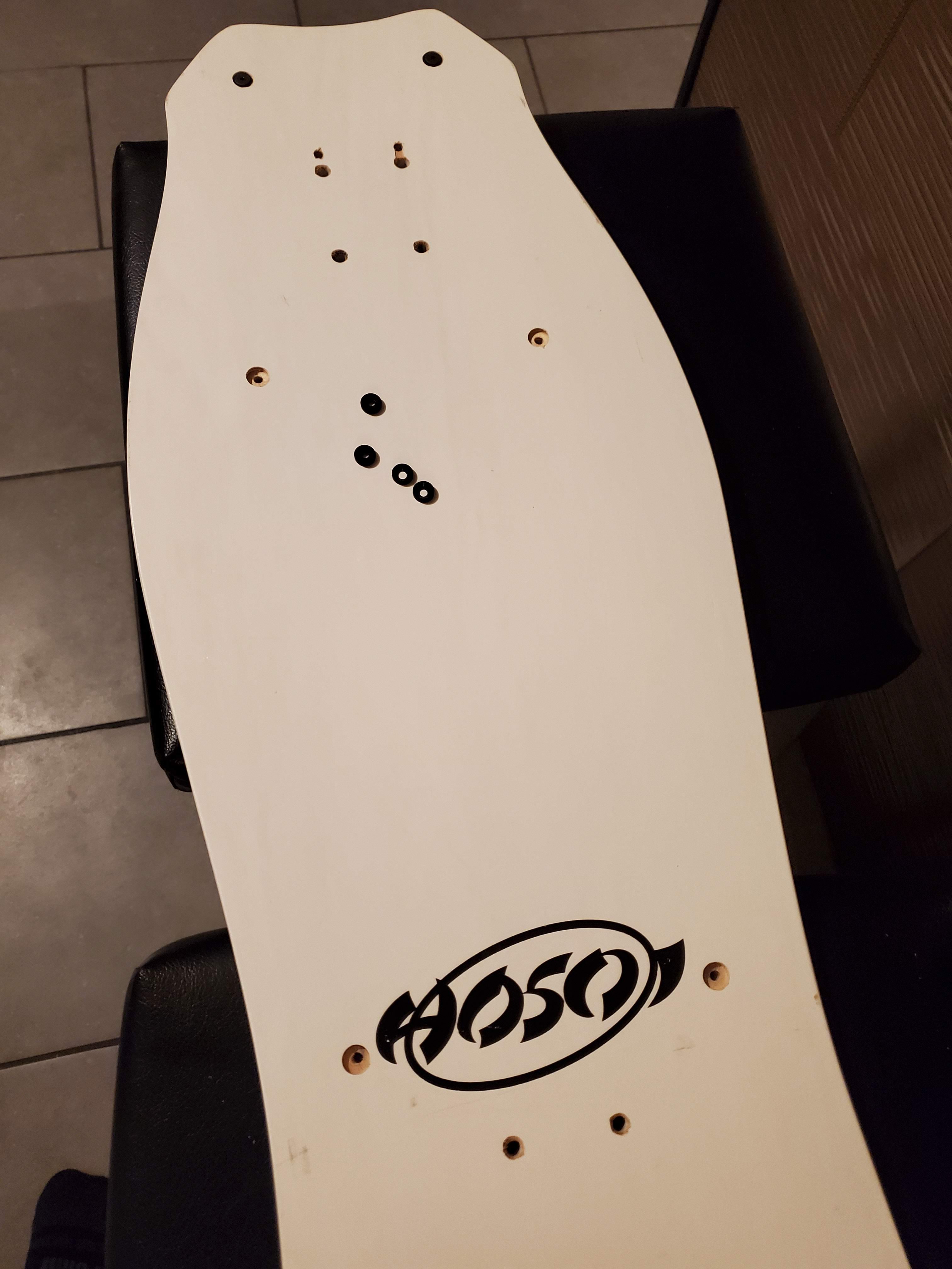

Countersink fender washers into the deck so it’s still flush and your feet won’t feel them
Then you can just cut the grip tape around the circles.

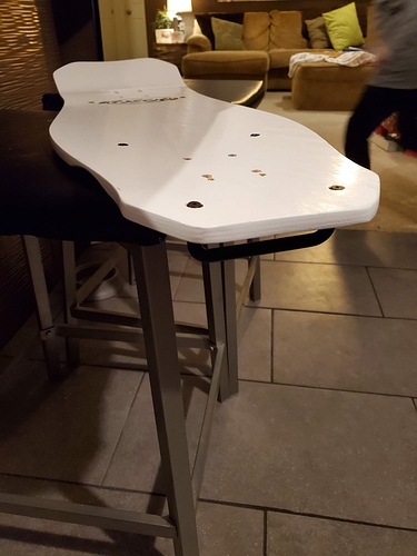

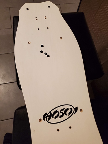

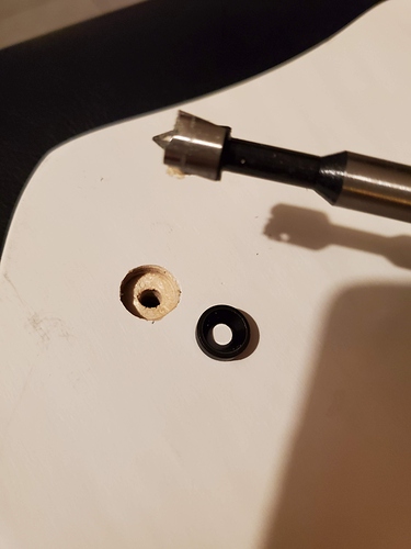

Why countersink fender washers if you can just countersink flat heads into the deck? Less material removed from the deck, still sits flush and the bolt head grabs to almost the very top layer?

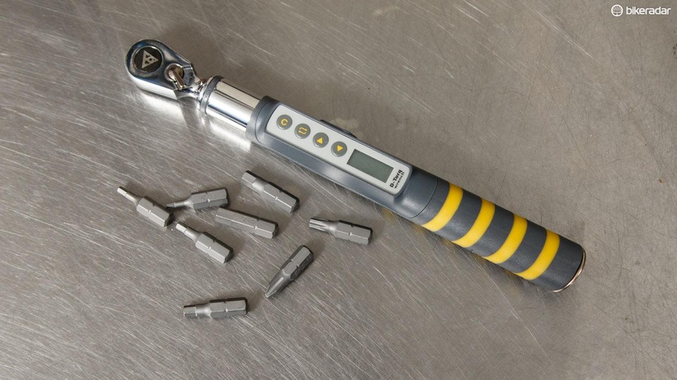

Over torque would pull the bolt head into the deck. Same reason I use an x thing.
Yes I know over torque would also pull a fender washer through so don’t even say it. DON’T. EVEN.
I was pulling washers into the deck on my drop mount so I just asked @akhlut to make me some cheaper versions of https://www.riptidesports.com/backing-frames-102/
hoping like $10 a pair or so
I need some of these or moon’s beams for my hummie. It’s cf on the bottom so probably the cf ones duh.
I have seen this a few times but have been worried that it would be more prone to splits. Really interested to see how it holds up.
They’re really shallow, only 2.1mm. The deck is petty thick too and definitely a hard wood so I’m not worried about it. I’ll let you know first if it splits underneath me though.

I have a torque function on my drill as well though.
