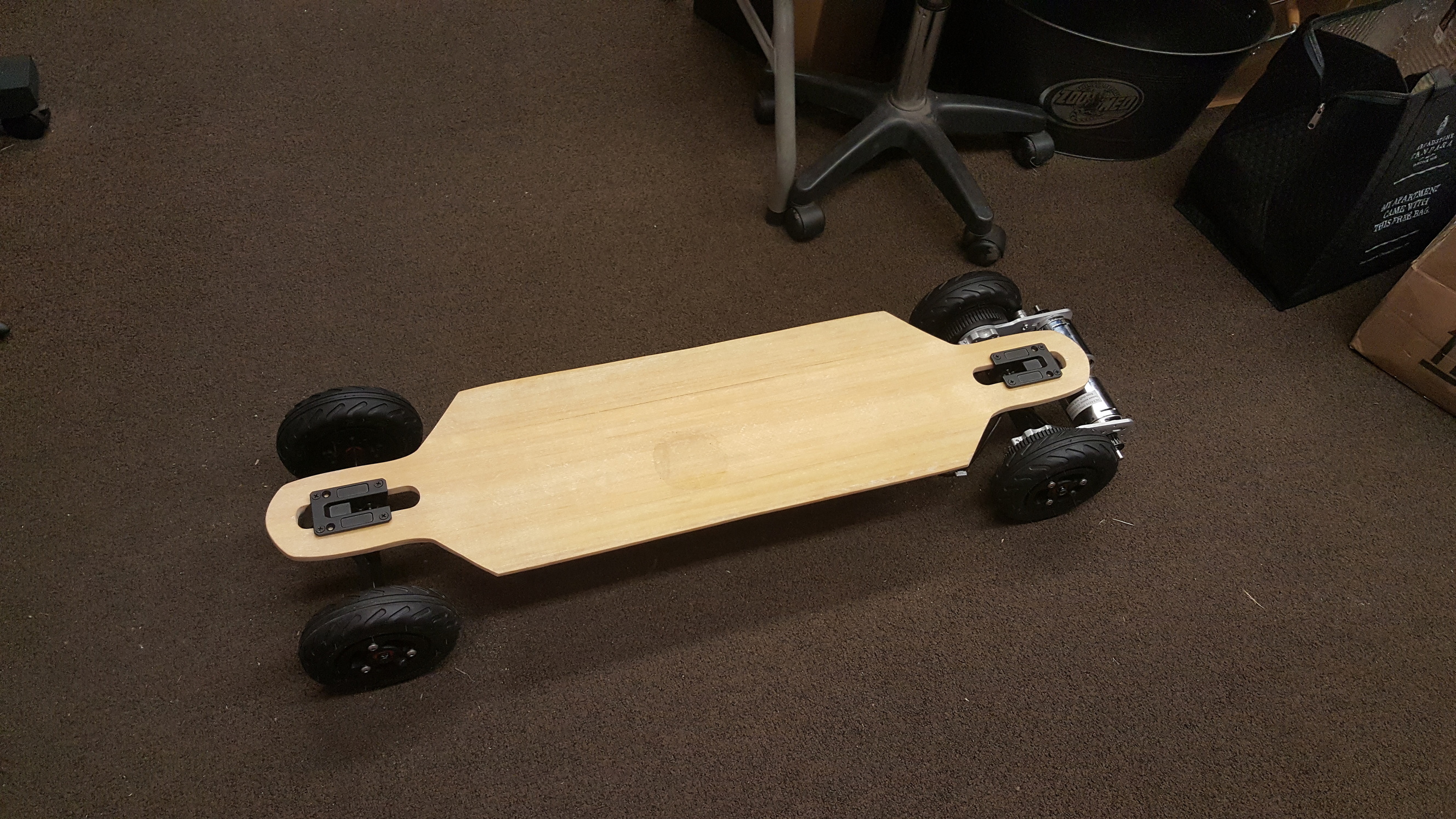

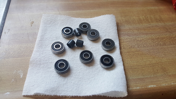

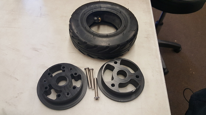

First I put together the wheels,
Then I powered the VESCS, updated the firmware, and selected some basic settings. Then I assembled the drivetrain and slapped it all on the board for fit adjustment.

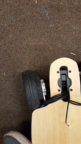

Lol what a fucking idiot, look @ 2018 me putting the wheels on backwards hahaha
So I stood on that backwards-tread having ninny muggins, and holy wheel-bite Batman, not gonna work. Switched the trucks to top-mount. Still no bueno.

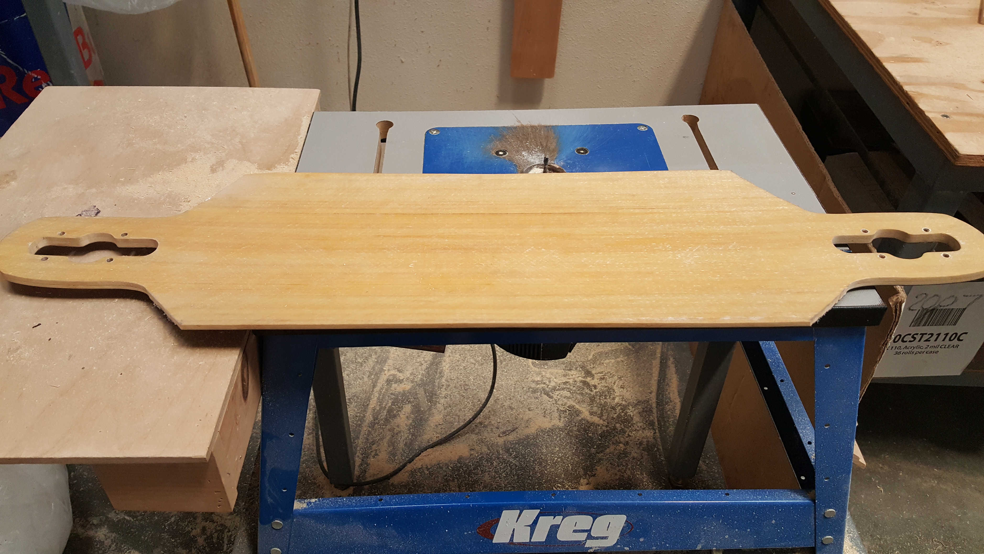

Alright back to work ya lazy bum. Lets fix that wheelbite and get back to drop-through heights. I used a router to shave the corners off my deck then sanded all the rough edges
Liiiike a glove!

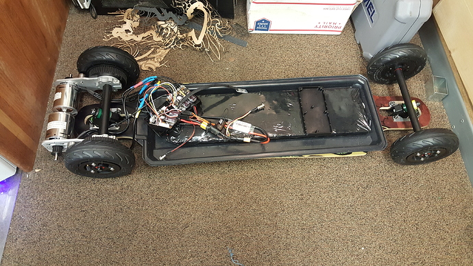

Electronics programming o’clock. Got it all hooked up, don’t remember putting that bluetooth module in but hey it still works to this day 2 years later. Ran my motor detections, set my throttle curve, yadda yadda

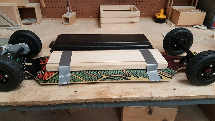

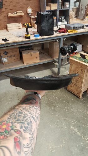

Now lets mold this enclosure a bit. Don’t get me wrong, the fit was, but it needed some love to feel at home. Made a wooden “battery”, whipped out the heat gun and the clamps, and burnt the shit out of my hand

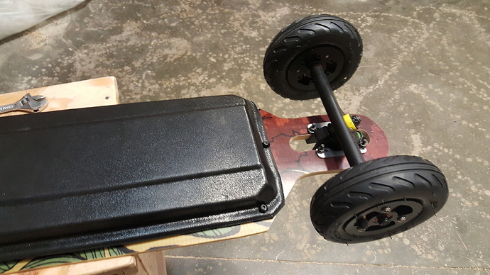

Fit the enclosure to the deck, drilled small holes (not all the way through) to match enclosure screw placement to screw inserts in the deck, then re-drilled the right size in the deck and added the inserts. Time to secure the enclosure for the first time
Added a cutout for the dual finned housing to feel some air. Gotta utilize that heat sink baby
Got everything assembled, quick test ride blew my socks off (it was my first time on a non-prebuilt board. Re-reading this old build thread I can literally still feel the excitement). Later on I drilled some holes in the bottom of the dual housing, added matching screw inserts in the deck, and bolted the housing to the board. I also added neoprene rubber all around the inside of the enclosure perimeter.
Apparently I also re-did the wiring to sit inside some braided cable sleeves. Go me, but bad me for not documenting the process.
