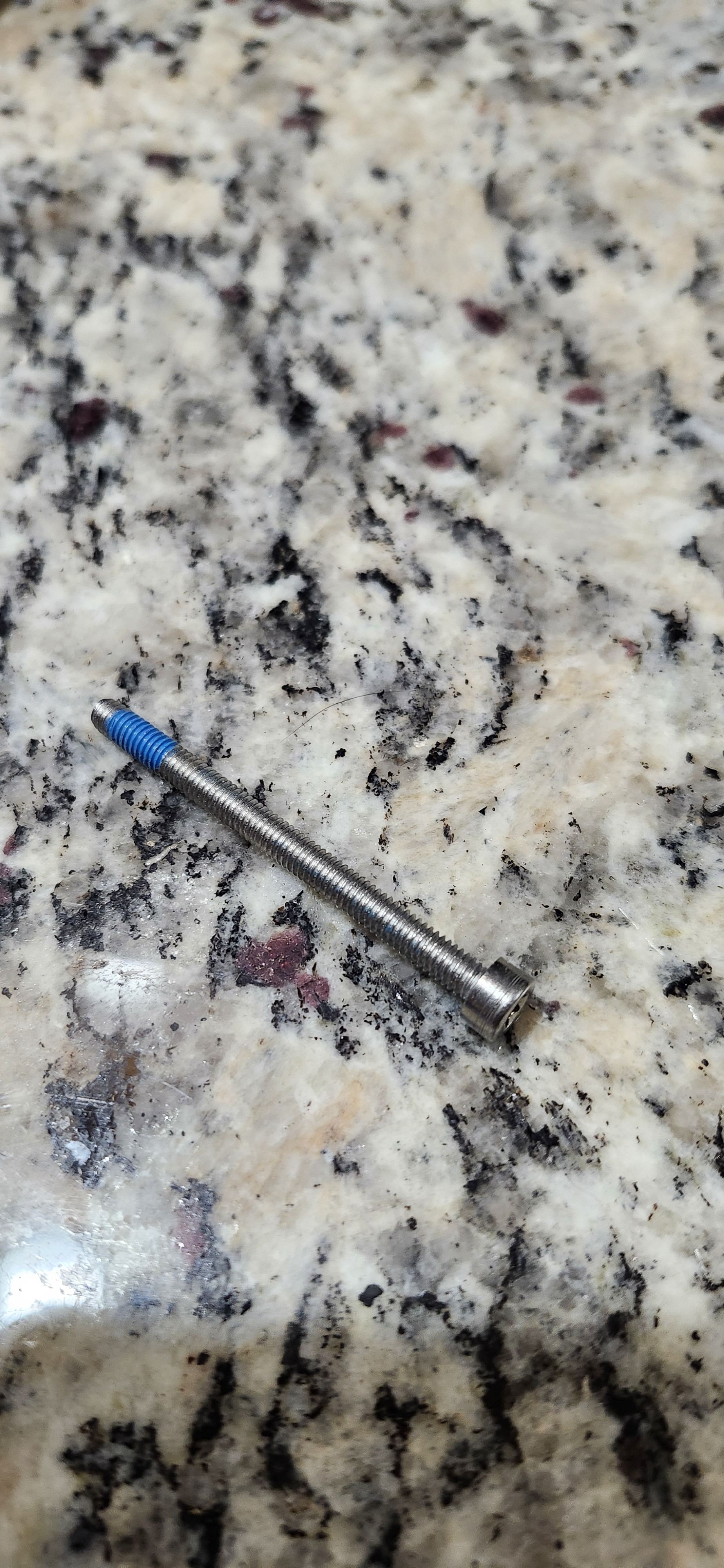

Trying to find these screws for my trampa rims but longer to connect to my bn gd. Any suggestions for a good deal?

I’ve given up on buying anything besides high quality graded hardware from reputable vendors like McMaster. Bad hardware is a liability, and mid-grade is a waste of time. Particularly for high-stress safety-critical applications like esk8, if you’re not buying graded hardware you’re asking for trouble.

What material/grade you recommend? I see quite a few options on the site. Which i agree on the high grade seeing how the wheels attach to the gd.

I only buy zinc-plated alloy steel hardware. Stainless is a waste of time. It’s way weaker, and even if the bolt doesn’t fail it’s likely to gall. Black-oxide alloy steel works fine and is cheaper, but it will rust if you whisper the word “moisture” anywhere near it.
Grade 12.9 is what I buy for metric hardware. For imperial hardware, grade 8 (they are not the same grading system, grade 8 is not 0.75x the strength of grade 12.9). McMaster makes this easier by just listing stuff as “low strength” “medium strength” and “high strength” with its relative grades.
