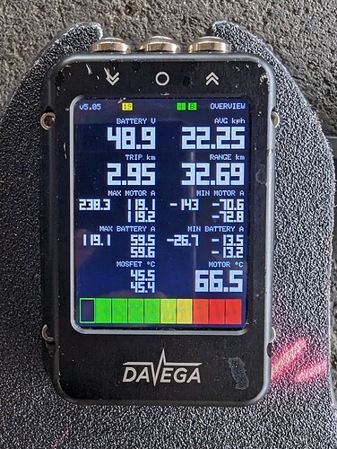

images (9)
Only the first run but this new dv6pro seems to be running sweet anyway :call_me_hand:
Temps stay stable. I’ve got no need to push it any harder.
