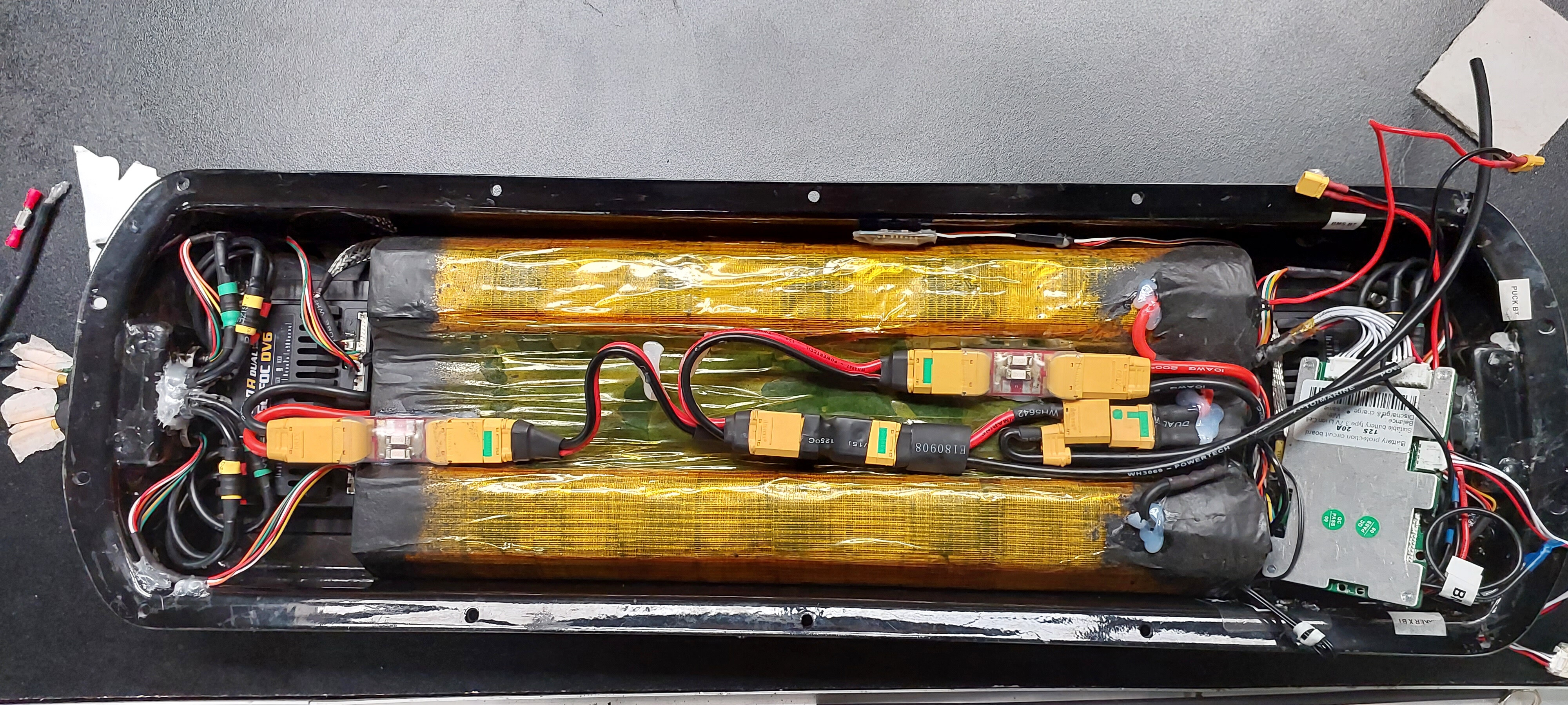

So if im correct, to run two DV6s’s id need a singular loopkey to power both, and for initial connection, disconnect the can cable, plug in power for both, then connect? From there, is there a way to use a single power button for both or do i have to use that loopkey?
As long as your esc’s are being connected to the battery at the exact same time, you are good.
For my 4wd with d100s’s, I soldered the ESC battery leads together, so I don’t have to worry about any accidental connect/disconnects while can is connected. I only have one xt90 so it’s impossible to blow up the can chips.
So if i get power to both of them, would i just use one power button for both of the vesc’s or would i have to have two? Definitely will be using a single loopkey to power both on at the same time whenever i need to use the loopkey, but what about when im just using the power button? If i have a single power button, would that be able to boot both of them simultaneously?
Can use either one or two buttons no problem
Gotcha so the power to both at the same time thing is just for the intial plugging in, past that i can boot them without issues. Thanks!
Like sug said, one power button or two, either is fine. There is no issue turning them on at separate times. The issue is when they are connected to power at different times. As long as that loopkey connect/interrupts power to both at the same time, you are ok.

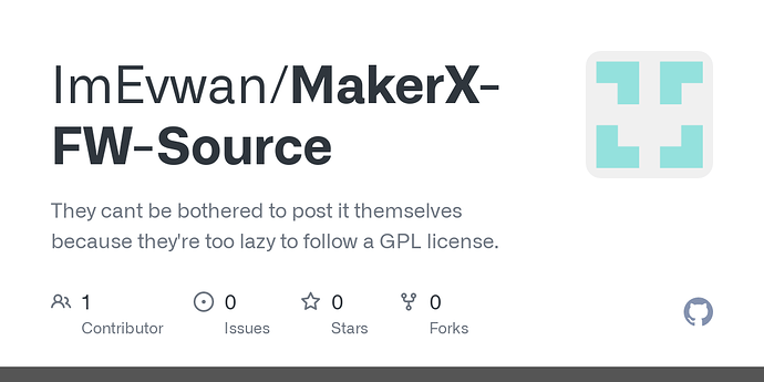

Since they cant be asked to make it publicly available.
Single battery output to XT90 splitter, loop key runs through negative
