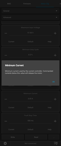

The way I read it that’s the threshold before the motors are released lowering that would mean if there is lower current input the motors would not release until it’s lower than 0.01a.
I might be way off too.
Can confirm what it claims to do, but I don’t think changing from 0.05 to 0.01 is gonna make a difference, feel free to try tho
I’m on current mode and haven’t seen this issue with my d100s at 16s
What gearing ratio? Sensored or sensorless?
4.8:1
Sensored
I tried @poastoast board and it doesn’t quite seem to be there. But he’s running sensorless, and I notice the transition actually starts to cog instead. Also, full current.
I just tested it by lowering the minimum current and it doesn’t seem to do anything.
This seems to have something to do with the 100250 firmware, not the hardware. In practice I don’t think it has much effect as the motor is released as the speed approaches 0.

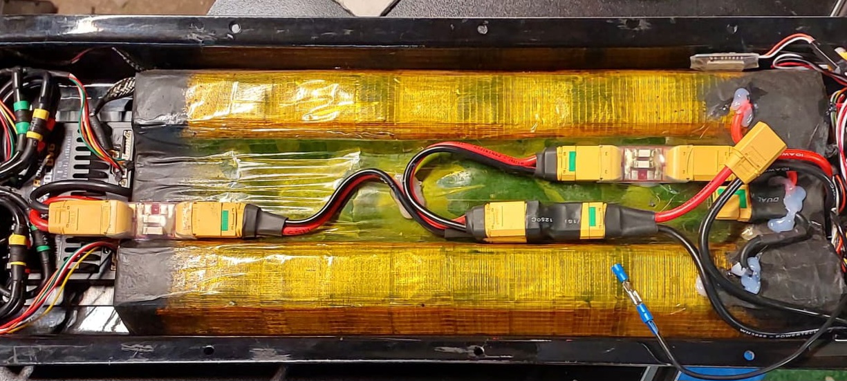

Reading through all this and it seems i have a pair of golden goose eggs… im running my DV6’s on the 4WD off 1 loop key, it all splits at the battery and the loop key is on the -battery side.
Lemme find a pic…
So am i just lucky and got through on ignorence?
If you’re breaking power to both at the same time its fine
