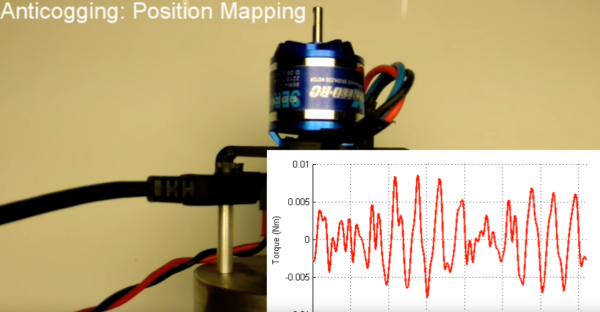

That article is for servo control…
The idea is to determine the voltage needed to at every single encoder pulse to produce a uniform torque.
or…for hobby brushless motors. ive seen similar also used for electric bikes.
