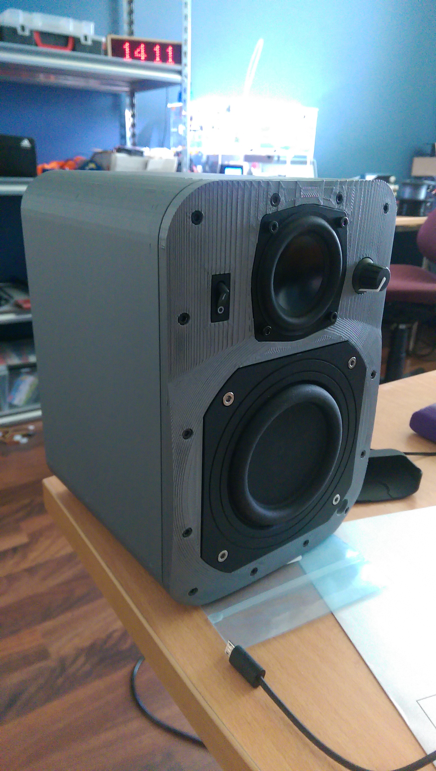

After many different iterations of port design and packaging I found a good compromise between port length, diameter and packaging. Now I could start designing a dedicated two-way amp for the speaker.
It might be packaged, but there are no electronics inside despite the volume and power button.
So okay, I need to design a new amp for the two-way speaker, I need to get more low-end and also more power/volume, but I still want to use a single lithium series cell pack, so I need to boost that voltage higher for the amp ICs, to get more power to the drivers…
So boost converter from 3,6V -> 12V, op-amp section to make an active cross-over for the high- and low-drivers and dedicated amps for both. Result is shown below.
No electrolytic caps fitted
And it works pretty dang well. It could do with another HW iteration, but once again I learned a lot from this small project and designing multi-way speaker and an active crossover. The boost converter starts to choke at higher powers, but it’s capable of driving the TB’s three incher in a very nice way.
