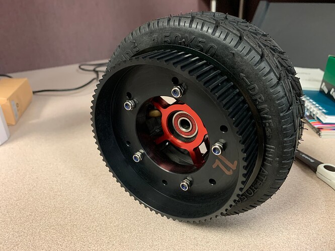

Is this a stupid setup?
170kv motor. 15T
150mm wheel. 72T
Gear ratio of 4.80. So calculates to 23mph. Which I’m okay with I guess. Plenty of torque for my fata$$. But how is the range affected compare to say 62 teeth wheel pulley? This looks weird. And yes I need longer bolts
