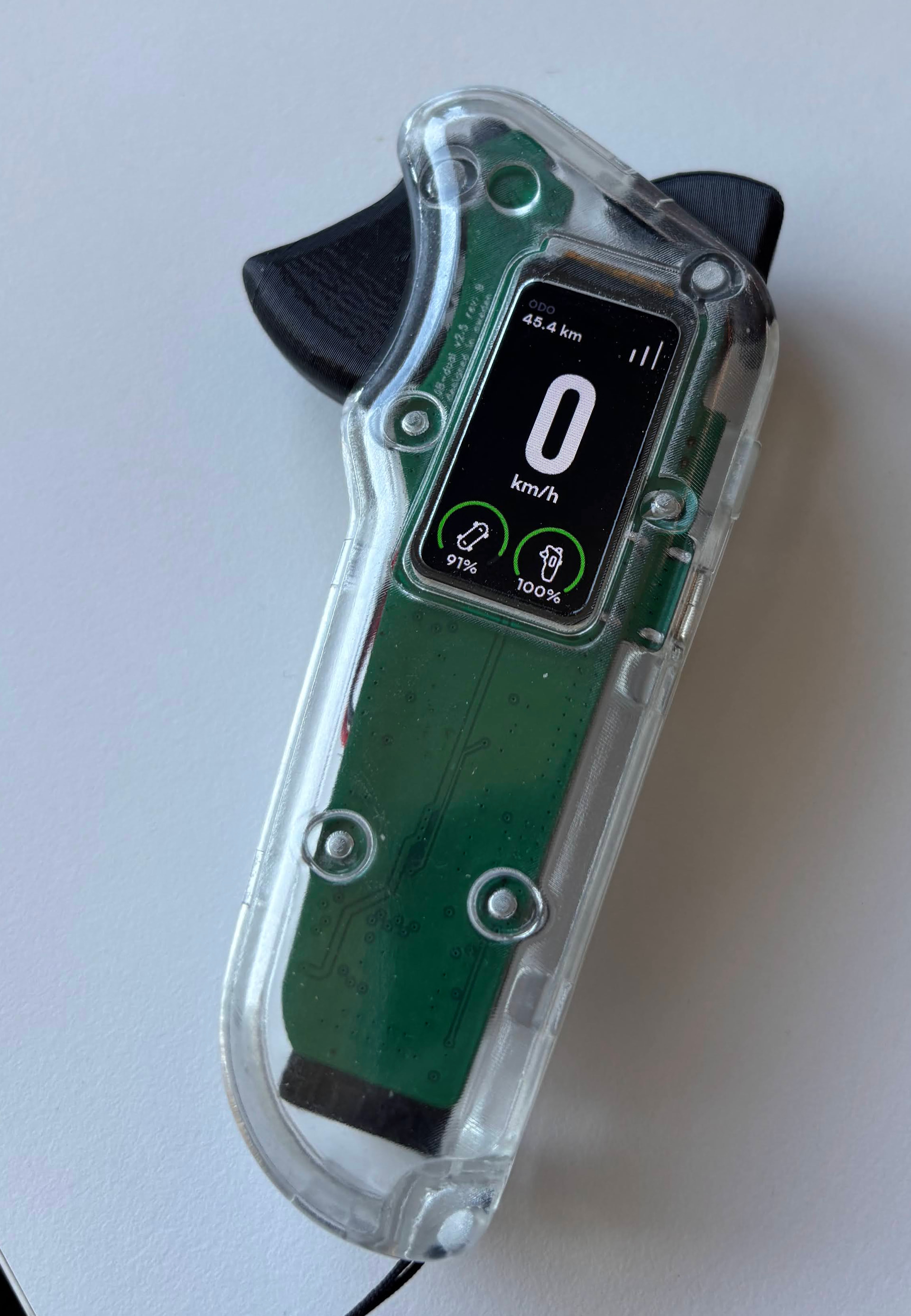

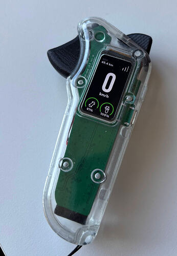

I runned out of transparent cases for the lite, I have a batch running in production (the transparent casing is pretty tricky to get it right and i’m struggling to keep up to quality, but will keep offering it since its so cool)
Soon I’ll send your remote!

not yet I don’t have dual black resin in stock, it should take around 2 weeks, then i’ll ship yours and @jack.luis

gb remote manual is live at gbengineering.se/products/lite/manual

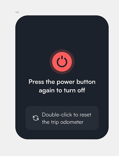

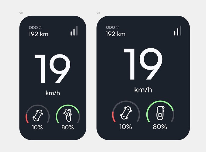

new UI is coming next week…

remote new UI is being released this week :slight_smile:
