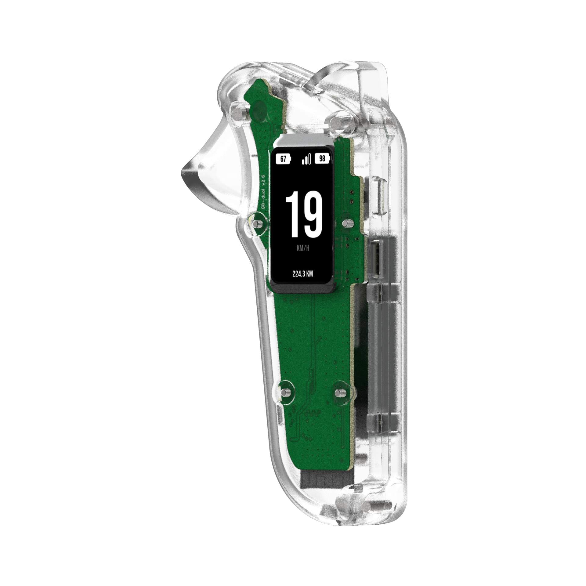

lite v2, this one is so responsive and rides so nicely!
totally unnecessary but maybe a cool party trick
pressing 3 times while on the boot screen launches the game. it’s available on latest firmware already
