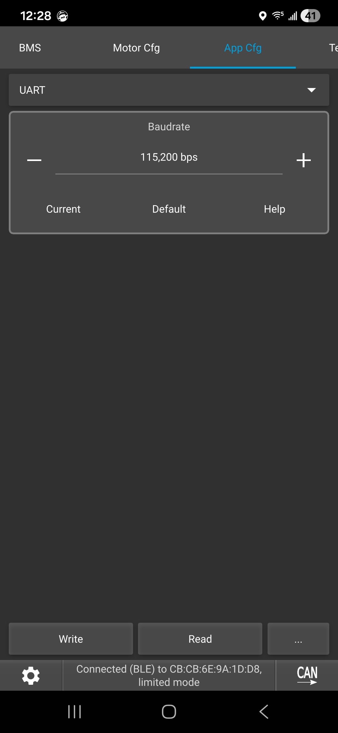

Baud rate?

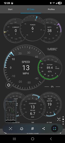

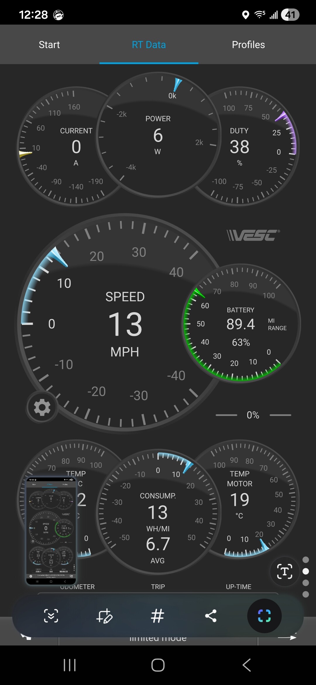

Vesc App shows data.
nope, if it was baud rate nothing would work

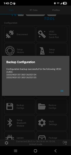

@rafaelinmissouri please export and send your vesc config, i might find something there in the meantime

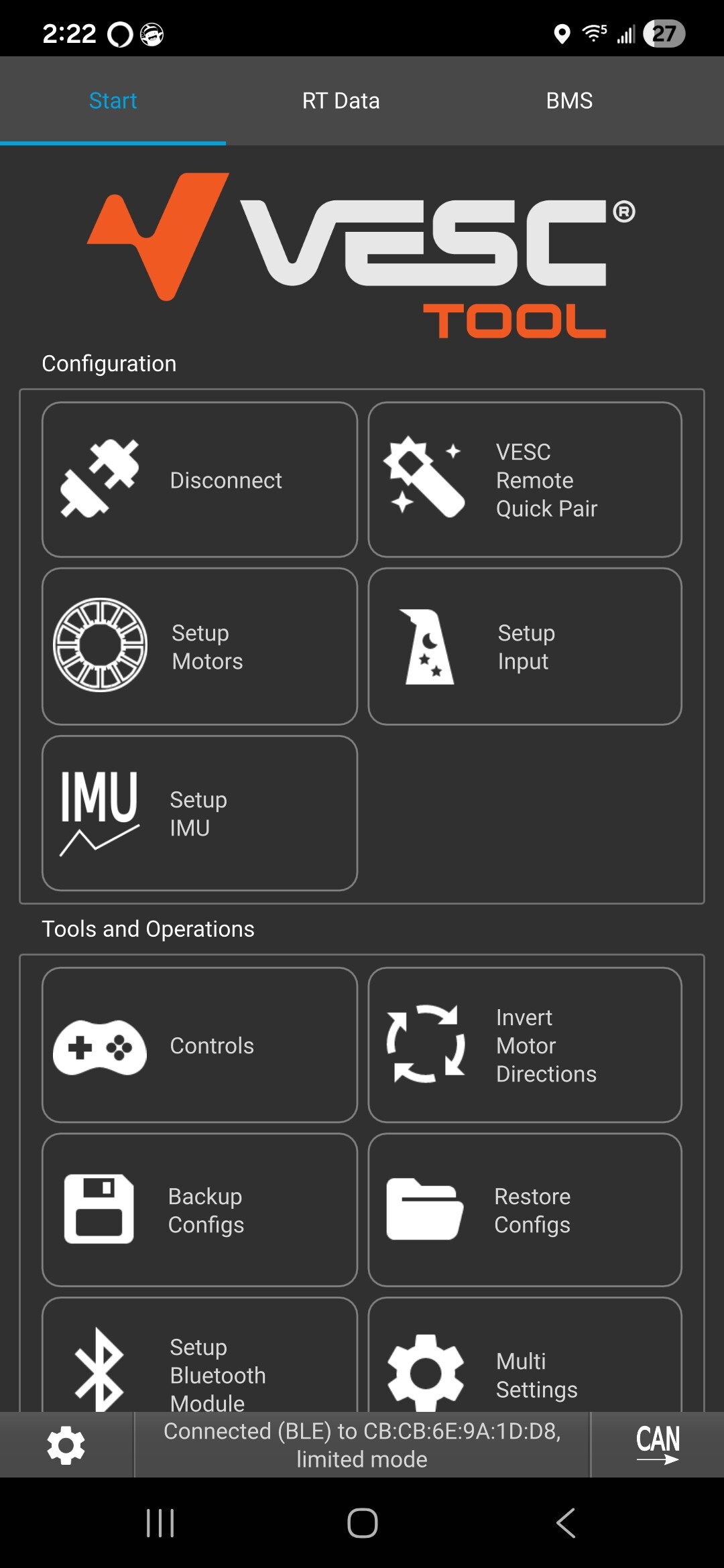

Sorry. I can’t seem to figure out how to do this from my phone and I can’t get tcp bridge to work …

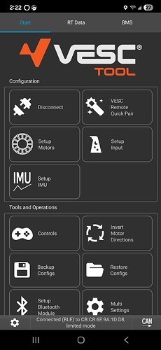

(pretty sure) from the “Start” page of VESC Tool, under Tools and Operations, “Backup Configs”. Once you have that done you should be able to share the file however works best for your situation
I don’t know where the file may have gone on my phone
Uh yeah, I just tried it on mine - good question. Thats actually really funny that its such a pain in the ass on mobile.

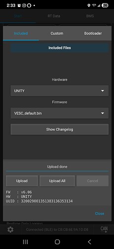

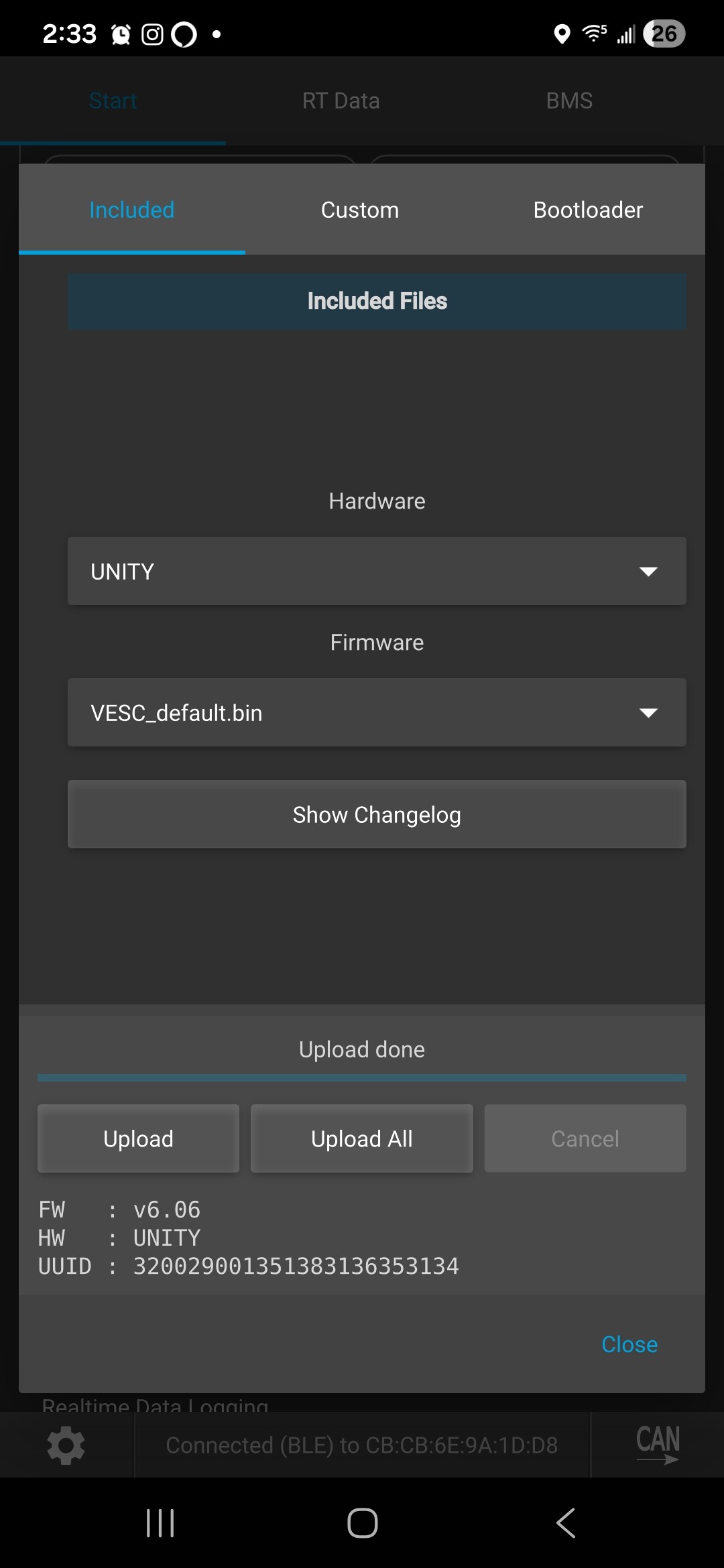

I was feeling dangerous so I just updated the Vesc App on Android and updated the firmware on the Unity to 6.06.
good news is the board still works.
The remote still works and feels good.
Unfortunately there is still no telemetry. So my universal fix did not work…

Yeah, desktop has an export config feature.
in addition to a newer separate backup/restore config feature. The backup/restore feature seems to just store the config internally i’m not sure you can find it and export it.
the export feature might be hidden somewhere in mobile, (same QT app.. ) but i haven’t found it.
