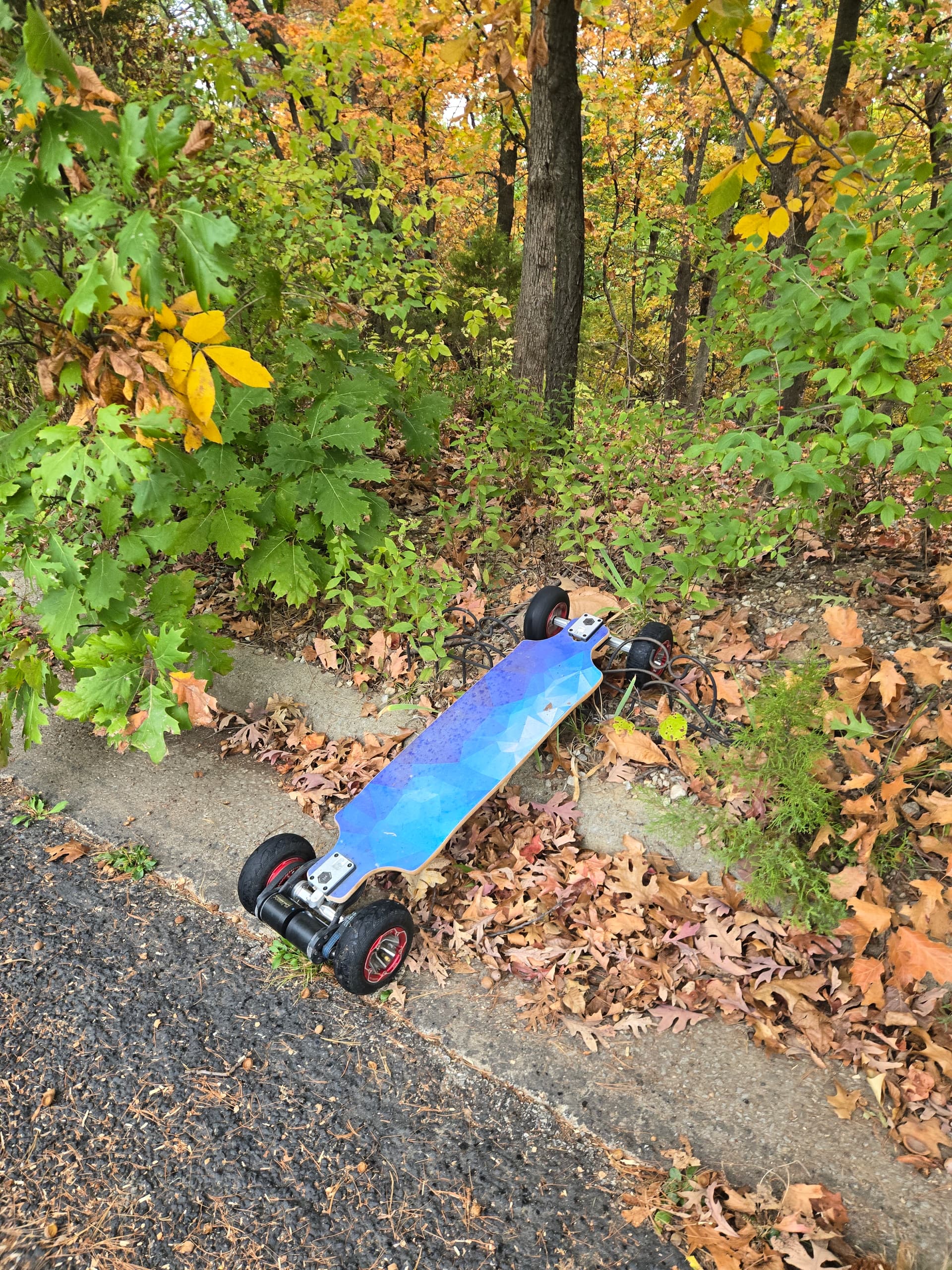

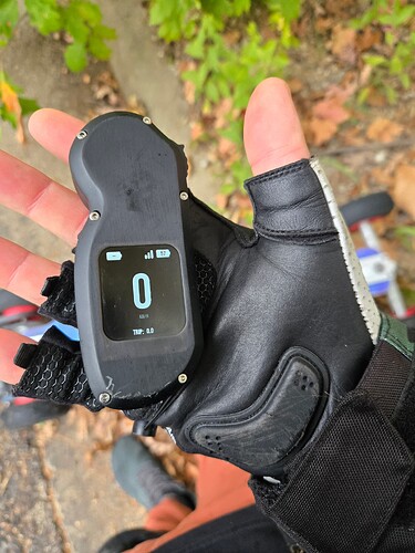

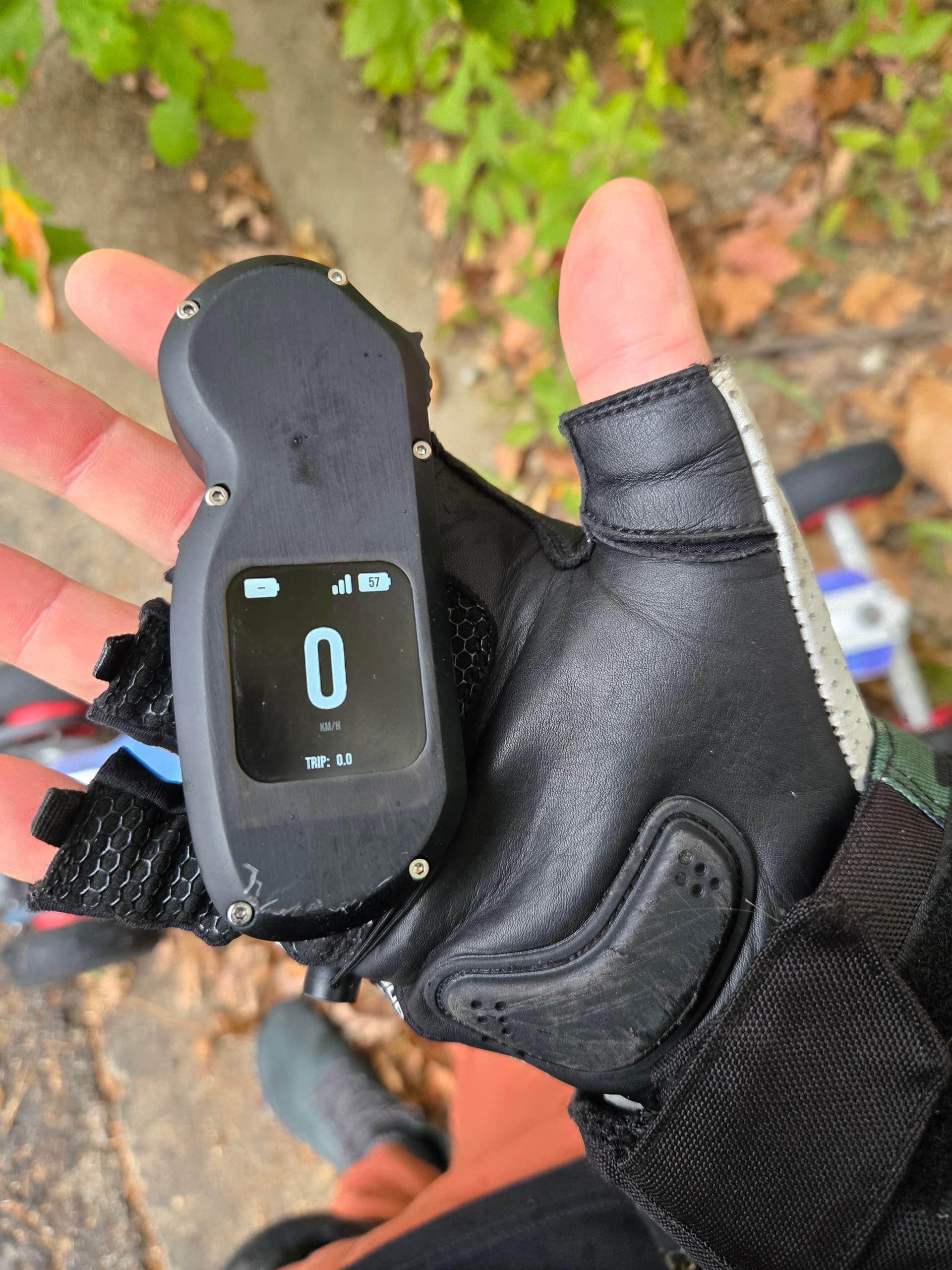

On other news @georgebenett I was playing in front of the house today on a wet road and the board slid out and I fell…
Happy to report the remote took it’s first hit and kept on ticking…

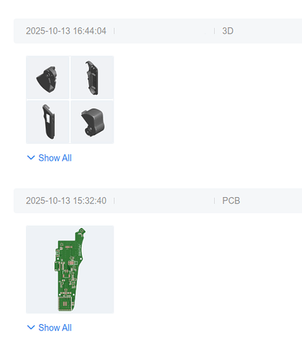

How do you get the PCB for your remote? Are you going to upload the schematics for the remote control build?
