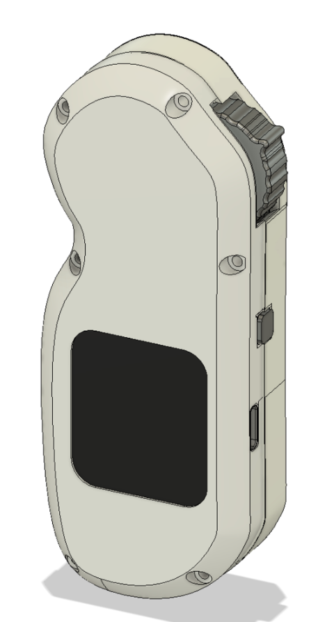

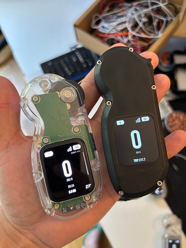

I’m excited to share something I’ve been pouring my heart into for the past 13 months during my free time - the GB Remote Lite, a complete open-source hand controller for electric skateboards.
What I’ve Built
This isn’t just another controller - it’s a full-featured, professional-grade solution that rivals commercial options. I’ve built it from the ground up using the ESP32 platform with real-time telemetry monitoring and a beautiful LCD interface.
Key Features:
  • High-precision analog throttle (HALL SENSOR) with automatic calibration (through firmware macro)
  • Real-time telemetry from your VESC and BMS systems
  • Modern LCD interface built with LVGL graphics library
  • Dual battery monitoring for both controller and skateboard
  • Trip distance tracking with persistent storage
  • Smart power management with sleep modes
  • Compatible with Jaiabaida and Kaly BMS systems
Technical Highlights:
  • Custom BLE SPP protocol for low-latency communication
  • FreeRTOS for real-time performance (No Arduino and platformIO BS)
  • NVS flash storage for persistent settings
  • Support for multiple ESP32 variants (ESP32-C2, ESP32-C3, ESP32-C6, ESP32-H2, ESP32-S3)
Why I’m Sharing This
After 13 months of development, countless late nights, and endless debugging sessions, I wanted to give back to the esk8 community that has inspired me so much. This project represents everything I’ve learned about embedded systems, wireless communication, and user interface design.
Current Status
The firmware is fully functional and ready to use! However, I want to be transparent about the current limitations:
  • Skateboard parameters (wheel size, pulley ratios) are embedded in the firmware, you have to change it in the code
  • No external configuration tool yet (parameters need to be modified in source code)
  • UI is developed with SquareLine Studio which is paid but you can use a free version to change stuff
Build Your Own
Everything you need is in the repository:
  • Complete source code
  • schematics will be uploaded soon
  • 3D printable enclosure files
  • Parts list
GitHub: https://github.com/georgebenett/gb_remote
Thingiverse: https://www.thingiverse.com/thing:7104863
Parts List: https://docs.google.com/spreadsheets/d/1dWc7UambJGHDQS4_GHVHaPw1IeZnQwx2AfN2q0adDvU/edit?usp=sharing
License
I’ve released this under a Creative Commons Attribution-NonCommercial-NoDerivatives 4.0 license. This means you can:
  • :white_check_mark: Build it for personal use
  • :white_check_mark: Share and modify for personal projects
  • :white_check_mark: Use it for educational purposes
But please respect that I’ve put a lot of work into this and don’t sell it commercially without my permission.
My Hope
I genuinely hope you enjoy building and using this controller as much as I enjoyed creating it. The esk8 community has been incredible, and I wanted to contribute something meaningful back.
Feel free to reach out with questions, suggestions, or just to share your builds. I’d love to see what you create with this!
Happy building! :skateboard:

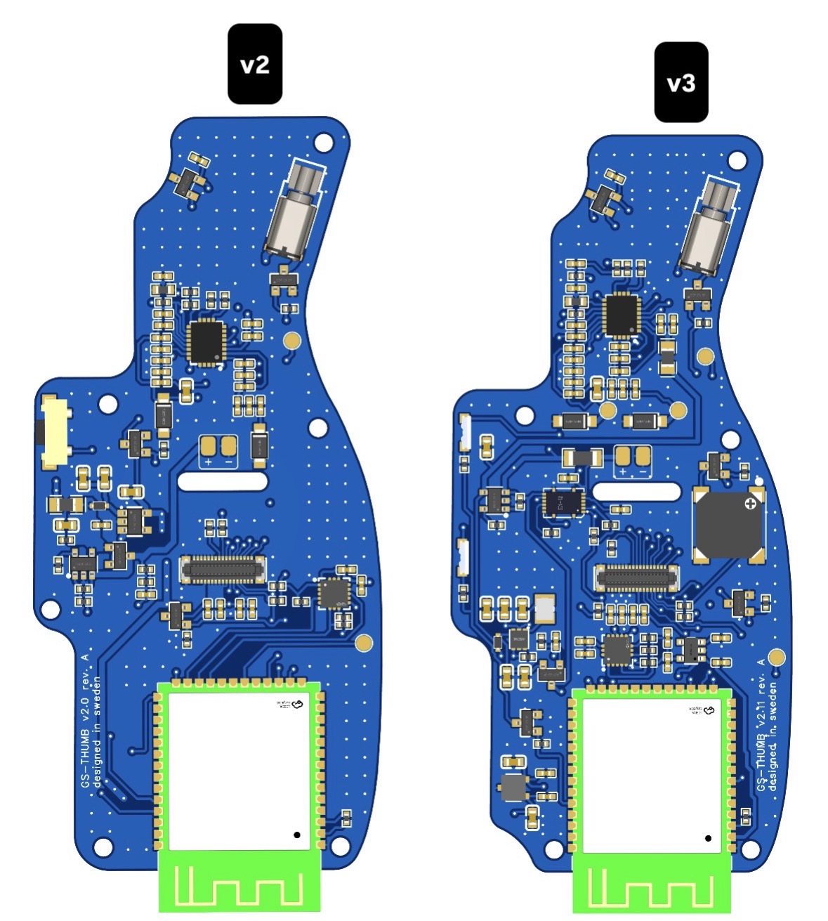

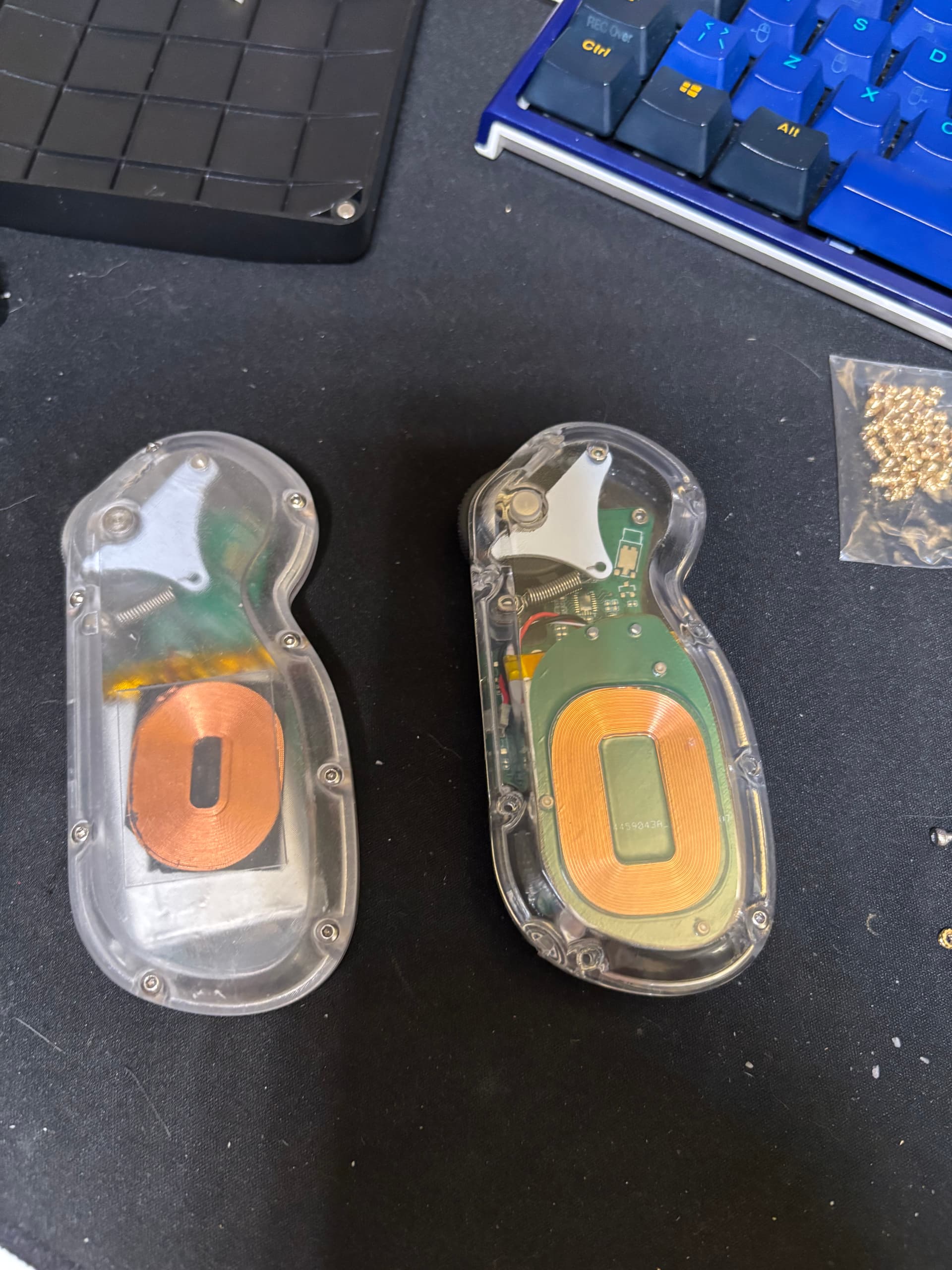

Cant wait to share the 2nd version of this (GB remote Pro), which wont be open sourced since Ive wasted a ton of money on it.
But will have capacitive amoled touchscreen, capacitive hand sensing, QI wireless fast charging, fuel gauge, IMU, light sensing (for automatic screen backlight control) with custom built pcb, and a ton of features I cant start describing here, and the UI will be beautiful as well.

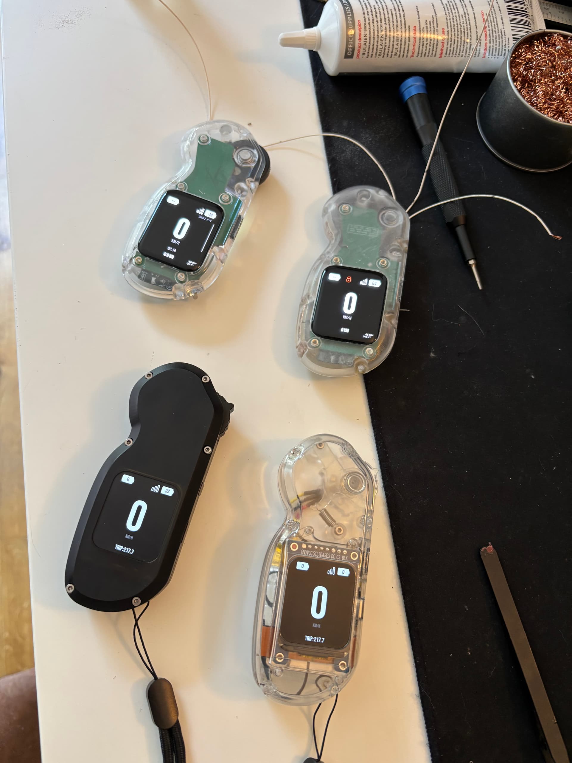

a small demo…
Im running most of my prints through my ratrig, so its a whole process (sorta my own fault). Takes about 30-40 minutes to preheat the printer for ASA due to how big the gantry is alas I’ve been so burnt out with work looking at the printer has been a drag :smiley:

You mentioned compatibility with the S3 - any plans or ideas on implementing into the S3 modules with built in displays? Or is that part of your closed source V2 plan?
EG: ESP32-S3 1.69
you can use the xiao esp32s3 without too much hassle, maybe fixing the fitting and adjusting a few things on the sdkconfig.

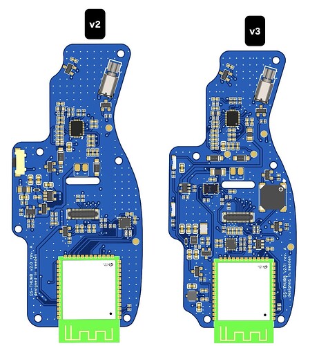

the next version won’t have any prebuilt modules like the link you sent, it’ll have my own pcb and the screen comes straight from the manufacturer
display is this one:
I spy with my little eye, haptics too. Neato burrito. Like I said, looking forward to how this progresses.

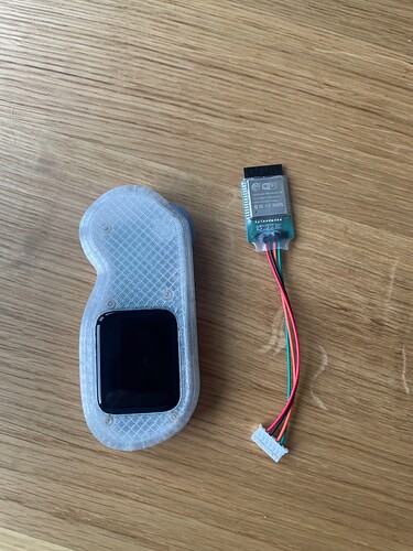

there is no compatibility with vesc express or any other right now since i’m running my own protocol between them. so you need the receiver also which can be another xiao esp32 or my custom board, will upload it soon
i’m thinking on putting up a small store and sell it so you guys can just plug and play, what do you say?
something like this, the receiver comes with the vesc connector in place
