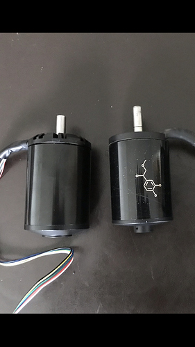

Honestly. Nazare and maytech 6396s are the same as far as I’m concerned
They are 6389, I thought. The stator might actually be shorter on the maytech if lacroix’s cans don’t have the extra support bearing.
Either way, They are physically bigger/longer.
Interesting
Idk man. Compare to 63100
I think what it is is that alex doesn’t take that huge bearing as being part of the actual motor. He’s probably going based off stator size rather than including the extra mms that bearings take inside the can.
Basically alex is giving us the actual size of the motor :man_shrugging:t2:
I can’t find the motor drawing I thought I’d found of the 6389, and may have to take that back, actually :zipper_mouth_face:
Haha. Idk man. I might be 100% wrong

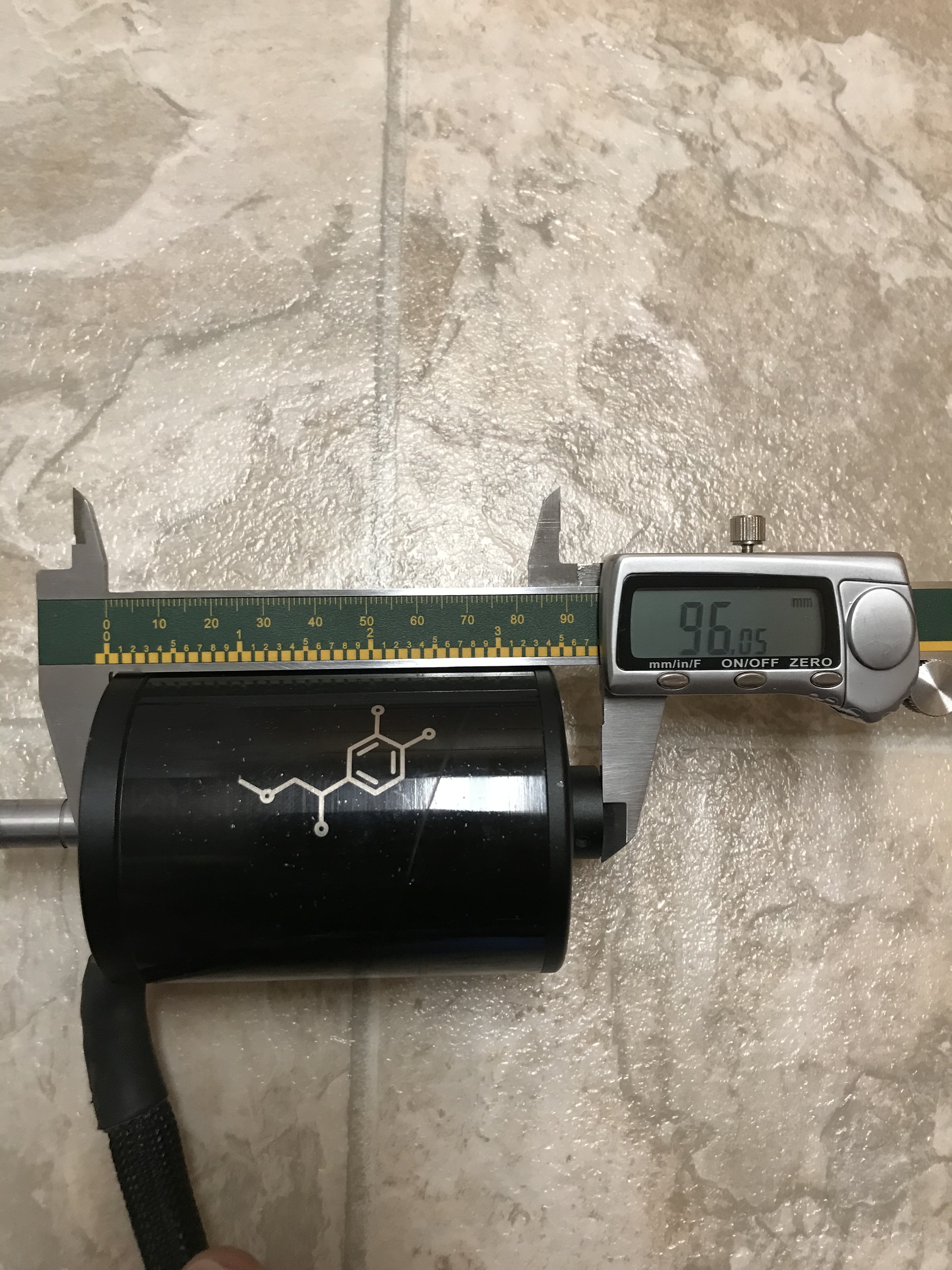

Alex “89” Number sort of make sense if you think about it
96mm over all
-2mm nipple at the end of the can
-5mm bearing
=89mm :exploding_head:
