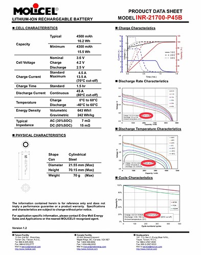

Hear lies the issue most BMS don’t but it is a requirement from cell manufacture that it is done. Bms manufactures say the bulk charger should terminate it and the bms just manages the balancing.
Commonly used battery
Commonly used BMS
Sorry only found a 10s best tech bms with a quick Google search so used a Dali one as well as there the 2 most common bms befor we go down smart bms root my point is both don’t have a charge cut off and it’s a requirement of lith-ion in cells.

Many “chargers” are not that at all. They’re just CC-CV power supplies and stay at their rated voltage, continuously charging the pack, until they are disconnected.

Total agree with you but it is a very large safety issue and a common for a huge amount of people unaware of not following manufactures advice. more throu been unaware and products not complying to all minimum requirements.
