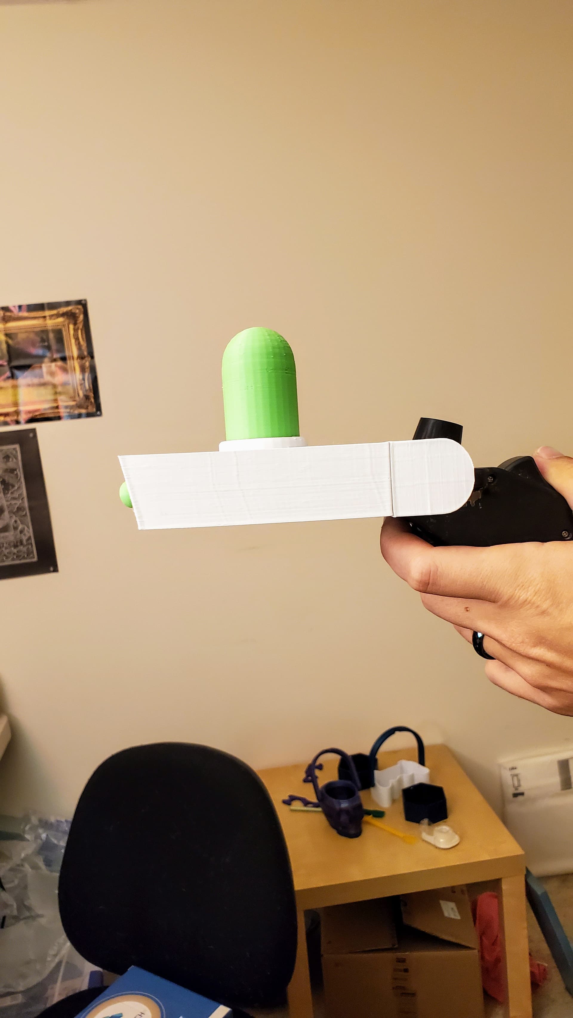

There exists 3d printed shells that make the puck into a trigger remote
Easier solution is to give thumb wheel a try
This is also biased advice because you work there :rofl: I don’t make any money from it, no matter which remote folks buy.
The only 3D printed shell I saw for that, looks like a pistol, and isn’t for sale anyway. In the USA I would never carry that even if it worked great, because it looks like a pistol. Also, not for sale.
In addition to that, things being used in the way they were primarily designed for often offers a better user experience, so given the choice between modifying something and using something else as intended, generally I would first try the thing whose design was created around an ergonomic finger control, and only then if that didn’t work, try modifying something else to have a better control.
At least it won’t send your board into traffic or disconnect
Also, your favorite remote was made to control a toy car, not a vehicle.

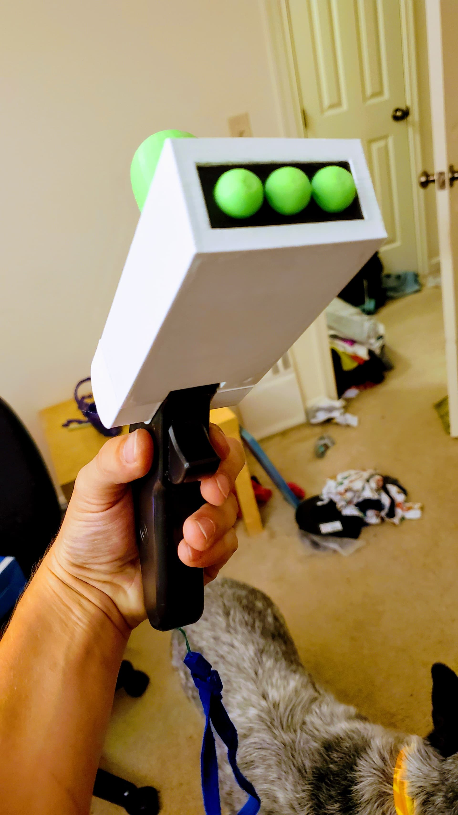

Then you haven’t seen this one:
It’s not for sale, but its fully open-source so anyone with a bit of determination can make one themselves. Heck, some enterprising go-getter could even make a bunch and sell them. The beauty of open-source.

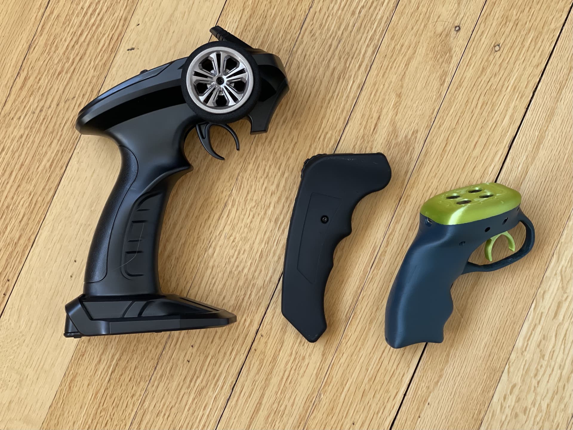

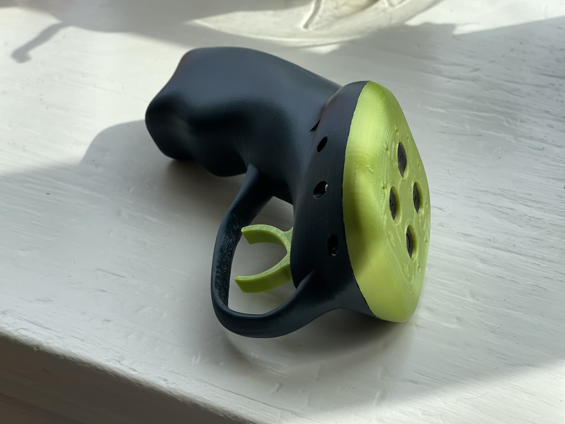

I am testing the Z.Mote at the moment.
Find me a trigger remote meant for electric skateboards with channel hopping and I’ll start recommending that.
No, you
This is what we want.
