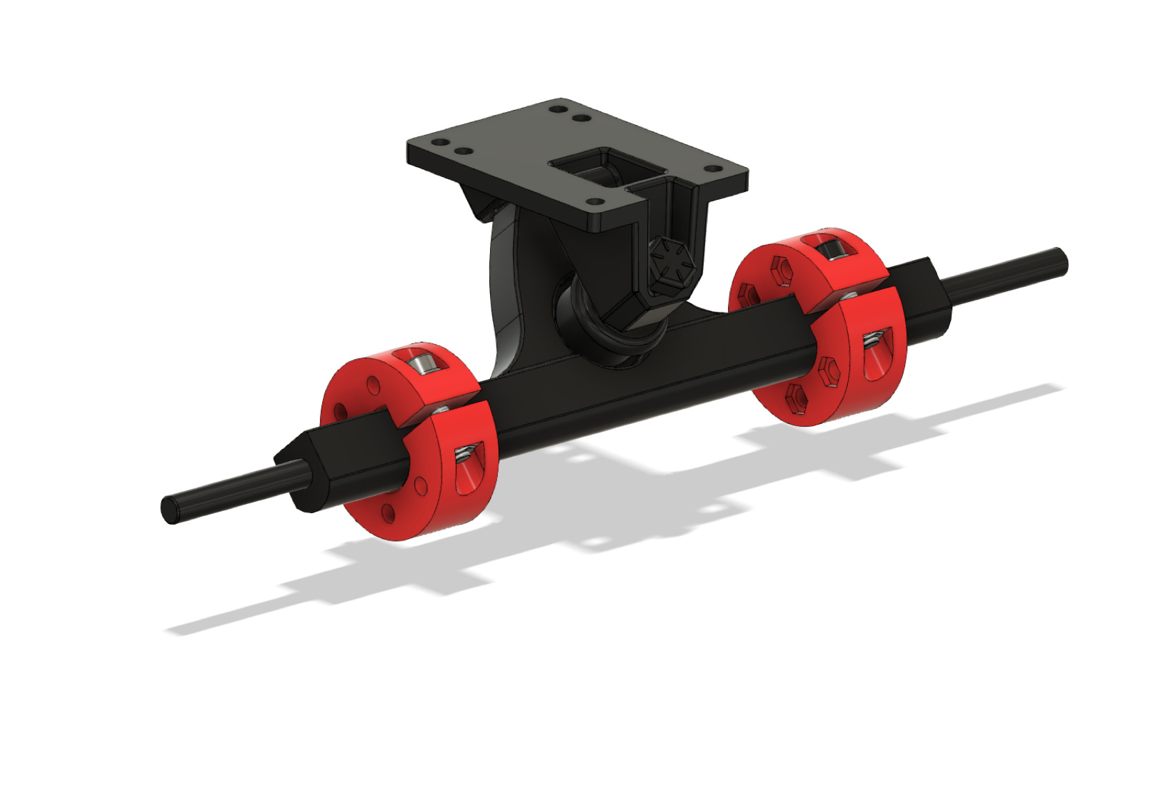

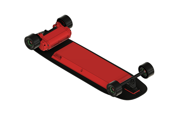

I am studying mechanical engineering and for my bachelor thesis I decided to build an electric longboard with as much use of 3d printing as possible.
This is the complete assembly.

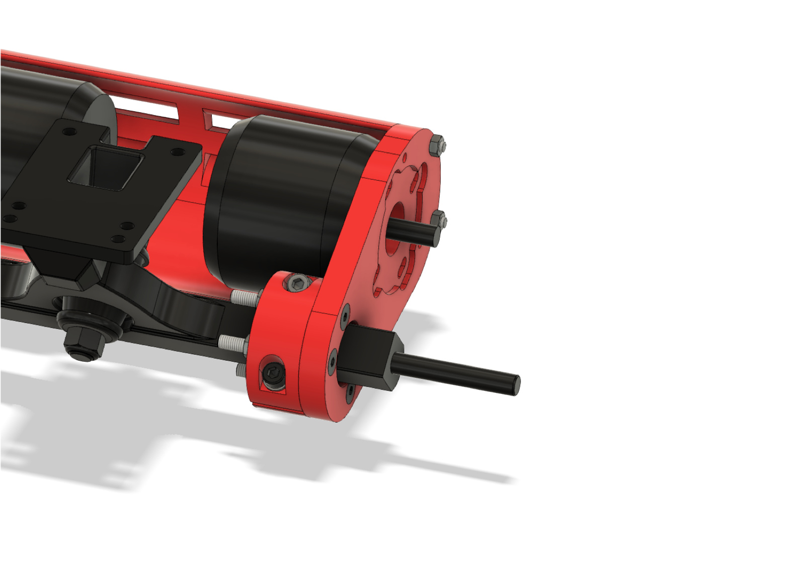

Now I need your help, for my thesis I need some strength simulations. However, I am not sure how to calculate all the input data. I know how to simulate strength of the enclosure through deck deflection and bend of the motor mount through torque. I would also like to simulate strength of the locking ring using clamping force. Does anyone know how to calculate these forces?

Vibration test on the mount and ring would be nice, that’s the most important forces the mount get
Torque tention on the mount too. Youd be surprised at how much our alu mounts twist when we gun it
Don’t forget that the climping is gonna slightly move your threads, possibly making the threads of the clamp not align with the holes of the mount itself.
You can simulate the bolts preload, and then add the motor loads as the following step. Make sure to account for friction. To cap up the preload force consider stressing the bolt to about 60% of the yield strength. This will be different for different bolts and you can find this info in tables.

I got the mount already printed out and have about 100km on it, so far it works fine.
I did this simulation on a single mount, it bent couple of milimeters, however the two mounts are joined together with crossbar, which prevents any flex.
