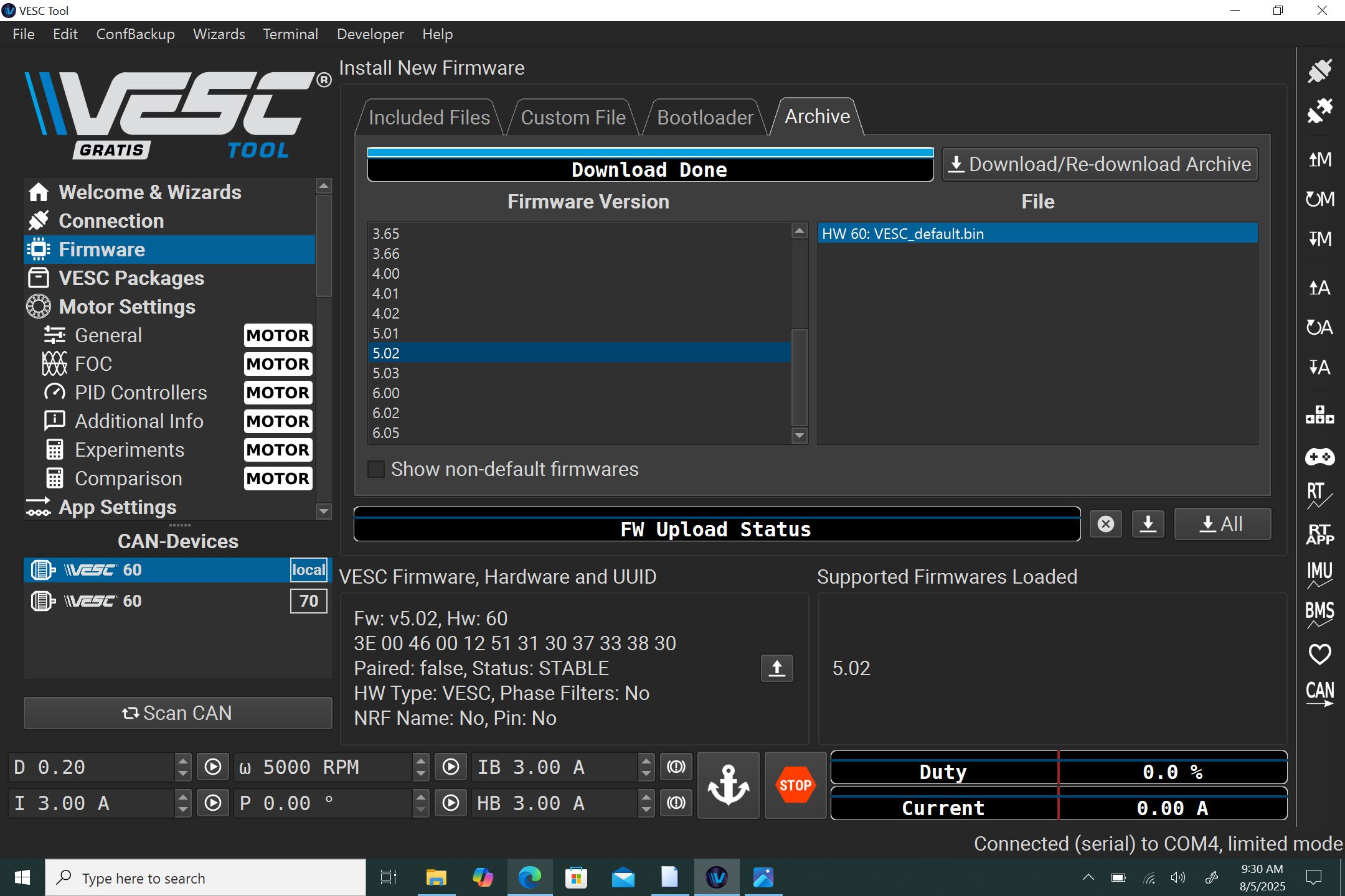

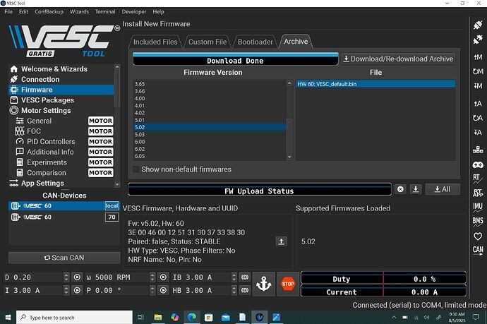

Hello,
I have the latest VESC and im trying to get my bluetooth remote flipsky to communicate for throttle reverse while connected via the UART cable.
My vesc is a dual mini 6.7 firmware 5.02 Hw: 60
Im running VESC tool desktop version 6.05
on prior Vesc version series 4 ive been able to do it via the setup input wizard as PPM but this version only allows UART connection.
Im also seeing that when i go forward the duty cycle hits 100% on the remote really fast with less than 15% throttle on the remote.
Does UART connection allow the same level of remote configuration as PPM?
