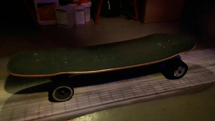

Im riding a FWD hub motor board and it was the best choice for me ever to do so, bc im an old street skater and we like to skate up and down the curbs. The biggest benefit of all is that i now can pop the rear truck against small curbs, by lifting up the nose in a simulated ollie movement similar as know from chinese ollie trick (simulated bc you dont need the tail to pop)without killing my hubmotors or motor mounts which i fucked up almost weekly in rear drive configuration. Thats more than awesome and i discovered electric skateboarding in a very new way.
Thats sweet,
So you’d say if someone who trick-skates wants a powered board, they should go with Hubs on FWD?
I know nothing about trick skateboarding
YES YES YES, NO COMPROMISE!
You wouldnt believe how hard i treat her without any issues since i ride FWD. Tricks are one thing, bc of the weight you will not able to do real ollies with FWD or a kick flip, but like i mentioned curbs are no more board killers by simply lifting the nose up like every street skater does.
lots of fun.
Double edit: I rocked my baby almost 5 hours today, bc i can swap my battery packs and i have lots of them :stuck_out_tongue_winking_eye:
Edit: the lighter the board the better, small packs of 20 cells are totally ok to get the fuck up in the air. Would not do it with a heavy board though, bc i think the rear truck would break sooner or later. Its the perfect solution for cheap chinese hub motor boards. Little city cruisers to get around the block having a fun hard short ride.
