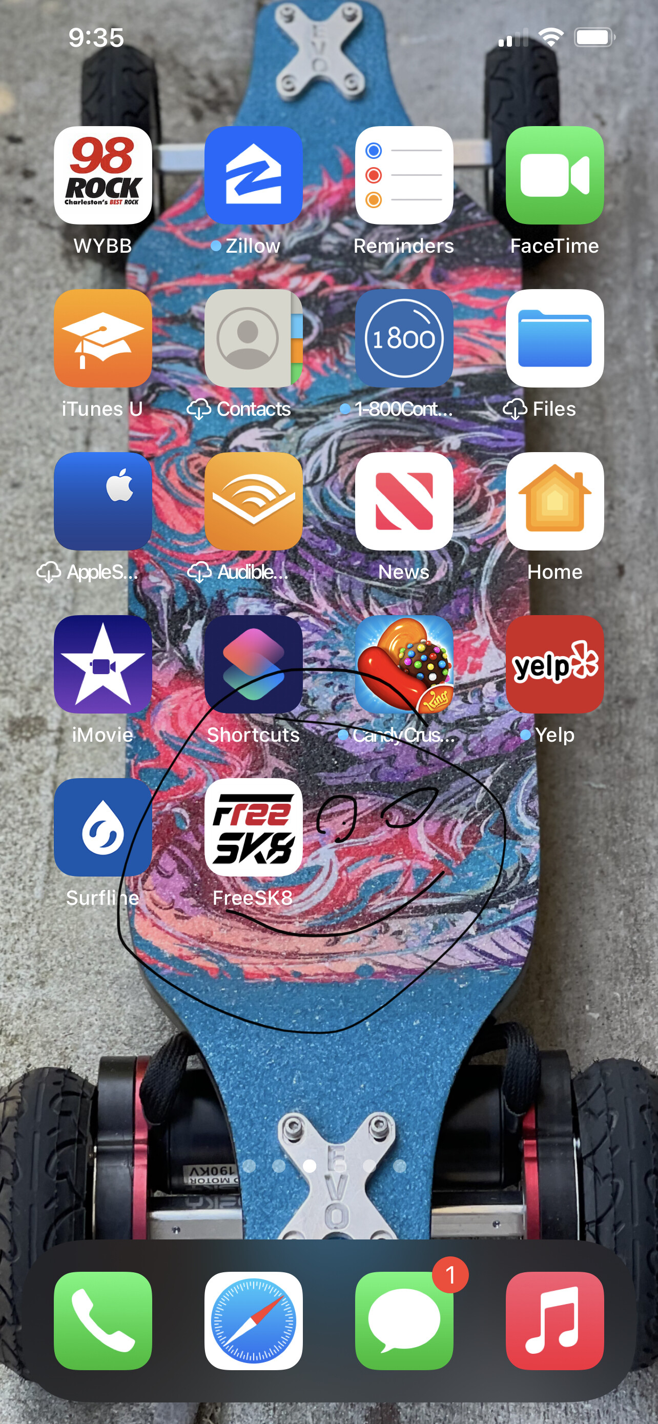

Omg it’s in the apple App Store :partying_face: I’m so pumped thank you @skate420 and @DerelictRobot
Thank you for making my life so much easier this is the best tech to come around in years

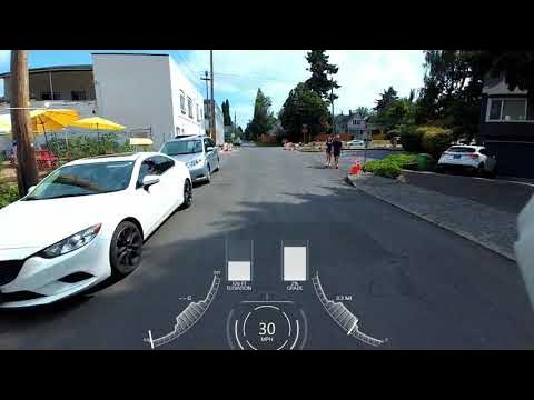

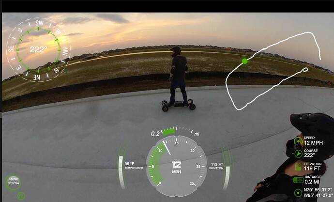

And if you guys don’t mind can we get that video of @SeanHacker Riding with the overlay OMG that’s so cool
You mean the overlay file you can generate from Robogotchi logs via https://overlay.freesk8.dev ?
Agree @SeanHacker post it! :kissing_heart:
