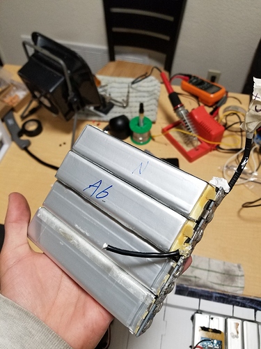

After taking the measurements for the packs and finding the dead cells, I decided the only way I was going to be able to use the packs was to disassemble them to the pouch level. These pouches were all soldered onto a mother circuit board, so it was simply a matter of spending a bunch of time to get them apart.
You can see in this picture that the pouches are a little bit distorted and they have some black stuff on them, that was the adhesive that was used to stick it into the enclosure bottom.
This part was also extremely difficult. Initially, I had no idea how I was going to take the pouches apart because they were all connected to each other with adhesive, and then ALSO soldered to the board. It was almost impossible to get the solder off each of the packs due to the fact that they were glued together and the flat tabs wouldn’t budge. I ended up searching around the internet for solutions to taking the packs apart and it took a while, but I ended up finding someone that used a pretty neat technique. In order to get all of the pouches apart, I wrapped a piece of dental floss around two screwdrivers and was able to slide it between the packs and sLowLY cut away the adhesive between each pouch.
This was an extremely painstaking process and I had to do it 30 times in total in order to separate the 30 cells. It was necessary though in order to get my soldering iron on each of the tabs and then get some leverage on the pack to slide the tabs out of the slots that they were soldered through.
Fast forward quite some time and I have all of the pouches separated and unsoldered. I lined them all up and measured each of their individual voltages to be sure I paired them all in the closest voltage pairs before soldering them in parallel. After measuring all of the batteries I remembered that I had several dead cells, which I had to remove in order to make a functional pack.
I decided that since I was unable to find any 9S BMS’s or 9S chargers that it would be easiest to just go with an 8S3P setup. I wasn’t sure how well the hubs would work with that much of a lower voltage compared to the original 10s, but I figured it would be fine.
The next hardest part came next: soldering the actual pack together. Before actually soldering the pack together, I individually charged each pouch to a matching voltage with it’s other two in the parallel set and placed them together so I wouldn’t forget. In order to actually solder each 1S3P set, I used my vise with a towel in the jaws to hold the battery more or less firmly. The actual soldering for this was pretty tricky, and initially, I thought that I was going to have to use aluminum solder or something special but I realized that the people over at Landwheel had spot-welded nickel tabs onto the aluminum ones that came out of the pouch. I was able to use these nickel tabs to solder to.
On each stacked up parallel set, I was able to solder a piece of 10AWG braided silicon wire. I didn’t have a better option at the time and figured since it would probably have a good amount of current going through it that the thickness would be worth it. I stripped about an inch off of the end of the silicon wire, used my flux pen on it to get a good amount in there, and filled it up with solder in order to make it possible to solder to the tabs.
Follwing preparing the individual wires for each parallel set, I pre-tinned every single tab with solder and flux. The reason for this is because I was still basically soldering straight onto the pouch, and having the amount of heat that it would take to fully heat up the wire and the tab on the pouch would probably destroy it. I set the wire onto the tabs and went at it, making sure to sparingly and quickly use my soldering iron to melt additional solder between each of the three tabs on the positive and negative sides of each parallel pack. Here is the pack after I soldered all of the tabs together. It probably took somewhere around 3 to 4 hours to fully solder everything together due to the sheer amount of work that went into each joint.
After soldering the parallel sets, I fiber taped each of the sets together and then taped the whole pack. After taping it up good, I soldered together the series set with more of the 10AWG wire.
Some of the solder connections look a bit weird but that is just burnt flux; I checked them all to make sure each pack was properly done. The next step was figuring out how I wanted to charge the beast that I had created. I had a bunch of 2S balance connectors sitting around, so I decided to break it into 4 2S3P packs. It took me a while to figure out exactly where to put the connectors so I did my research and it ended up like this:
I used Kapton tape on each of the connections where I attached the balance wires in order to make sure they stayed put. I additionally added fiber tape to reinforce all of the connections in total and provide a way to hold down the positive pack lead.
