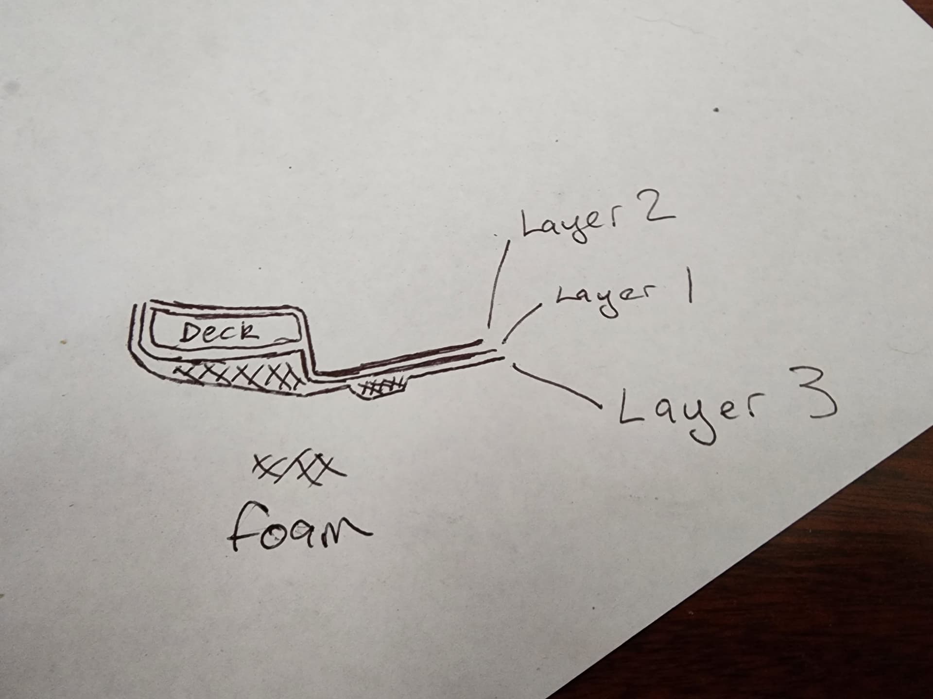

Need to glue these panels together and then shape them up to form the shape of the inside of the battery compartment.
Once that is done I can do the first of 3 stages of glass
1: form the inside shape of the compartment by glassing over the buck and the bottom of the deck.
2: remove the buck, tidy/shape the top of the deck a little and then glass over the top and into the compartment
3: shape the bottom of the deck and final glass/carbon over. I’m thinking i’ll use expanda foam for this step, squirt it on and then shave it back to shape.
I need to figure out a way to incorporate motor wire pass throughs and charge port/power button into this strategy… ideas welcome cos i’m a little stumped on that part :rofl:
Rough cross section
I made the channel for the motor wires when i cut the hole for the battery. So its a complete cut trough the deck wich gets covered by thin wood layers or fiberglas/carbon fibre layers.
Also i made a Wood frame instead of a foam frame just for some more stability but if you use enough composite it should be fine.

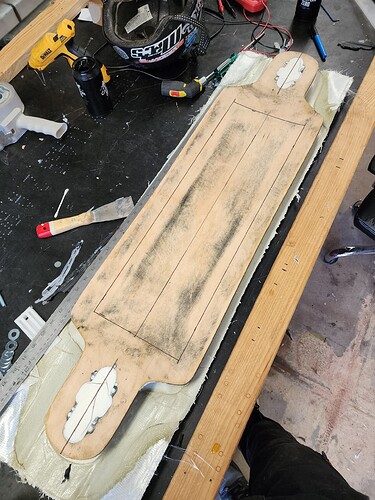

I had a busy weekend in the shed playing with resin and fibreglass. I should have done a lot more work on poor little frankendick, but I really have no solid plan so I procrastinated hard.
I added a couple of layers of fibreglass :rofl:
That is all until next time :rofl:

I feel so bad for Frankendick. He’s been patiently waiting in the corner of the shed while I fuck around with Semendeeds and other bits and pieces. I even started another build to add to the neglect.
But now the Semendeeds are done and I have cleared up a bunch of shed space, focus can shift back to Frankendick. I removed the buck from the center of the deck and cleaned up the inside and the edges.
I still need to do a little more detail sanding on the inside, but this is pretty much ready to keep adding glass. Gonna be a bit of a slow process, as I’m just gonna add a layer per day until I’m happy with it, but I can’t think of another way to do it and i don’t have large chunks of time to dedicate to it.
My Xenith returned from it’s trip to the US (thanks @jaykup!!!) and everything fits nice and snug inside. Not quite sure how i’m gonna do phase wires, or where I’m gonna put charge port and power button, but I’m hoping these things will present themselves along the way :rofl:
