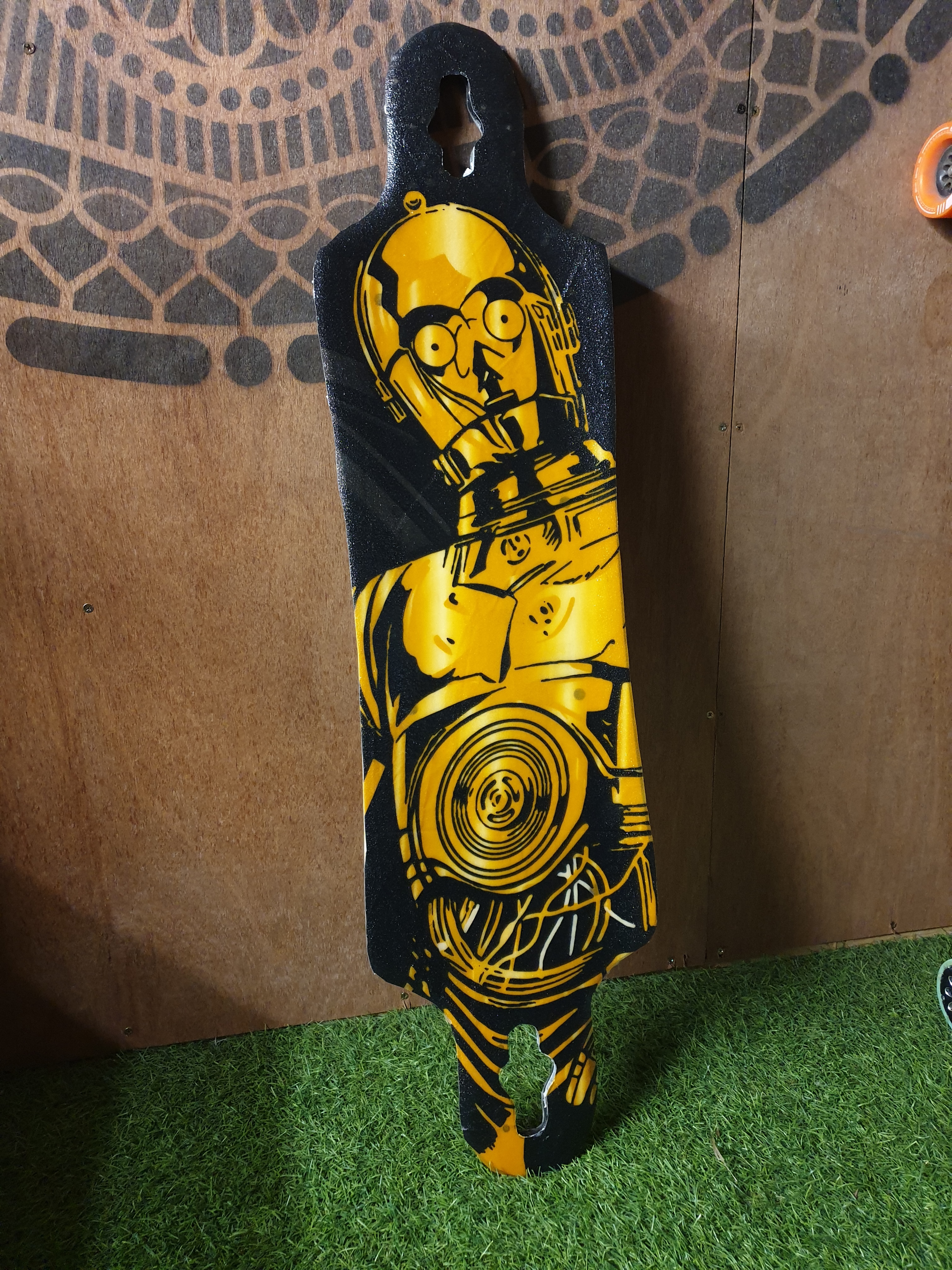

So I was reinforcing the GTX deck with fibreglass after routing most of the deck away and wondered about skinning it… I went to the local op shop and found a sweet star wars doona cover, now at least my stock gold motors will have some relevance.

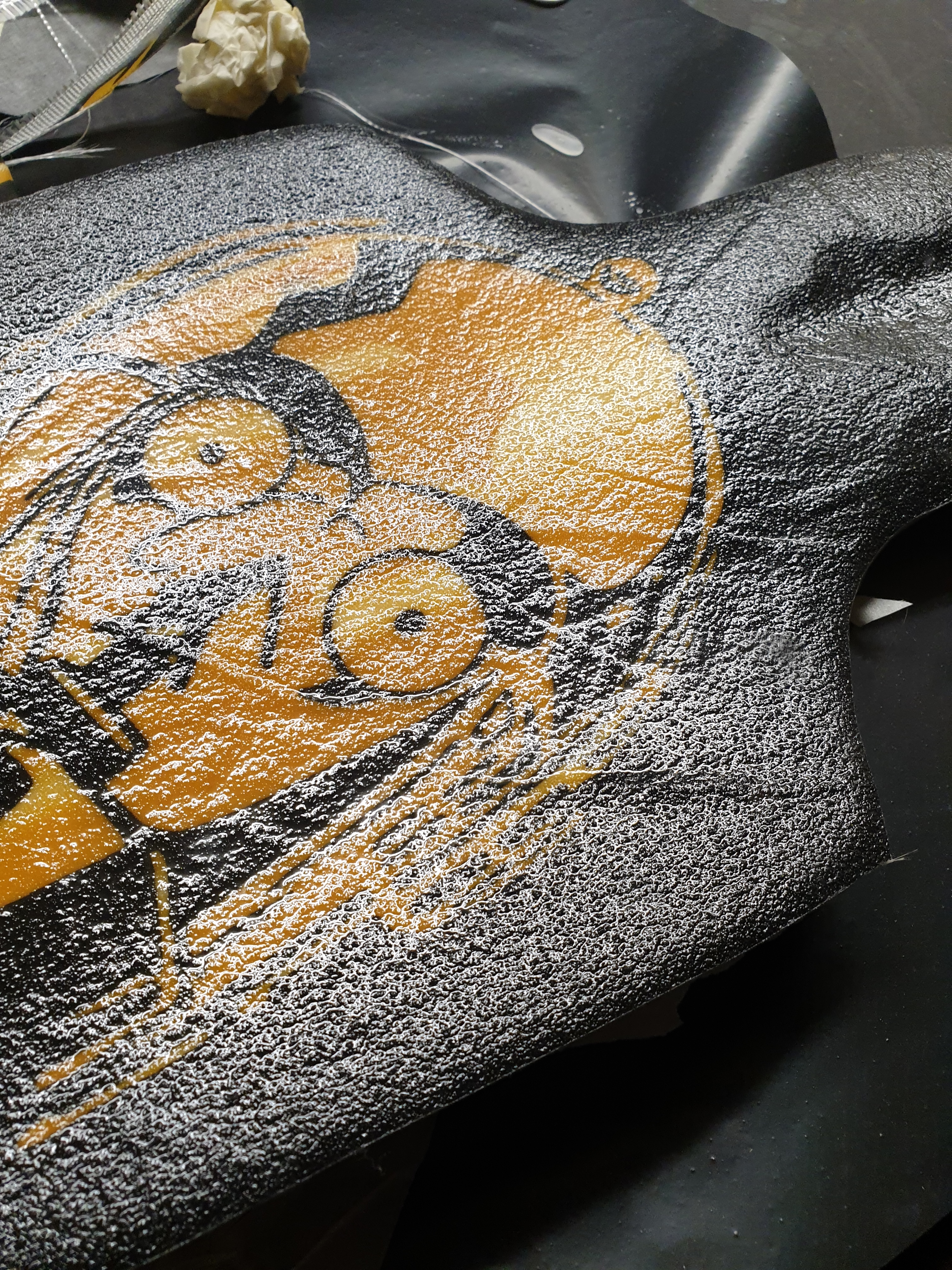

So I did a layer of resin and fibreglass cloth and let it go tacky before adding C3PO… then I stuck him down and put on another thin put fully impregnated layer of resin.
I’ve ended up with this really textured finish, that I actually really like, but have no idea how I accomplished it. Will be making some glass frit soon to complete the finish. Was thinking to epoxy the frit in and then do a few coats of polyurethane aerosol for uv protection and seal.

That looks awesome but what the fuck did 3PO do you to deserve to get cut off at the dick
Hahaha, was the best way I could make it fit!
So you got the wrinkles due to not waiting long enough for the first step to cure long enough before wetting out the fabric. After letting the first coat get tacking and adding the fabric, allow to pretty much fully cure before wetting it out. This ensures it is really locked in place before actually wetting it out.

Thanks for the tip! I can deal with the texture but those ripples do bother me, will keep it in mind for next time :call_me_hand:
That’ll fix that in a jiffy. I had some of that on my first one. This waiting step is key.
Awesome placement on C3P0. Stellar layout!
