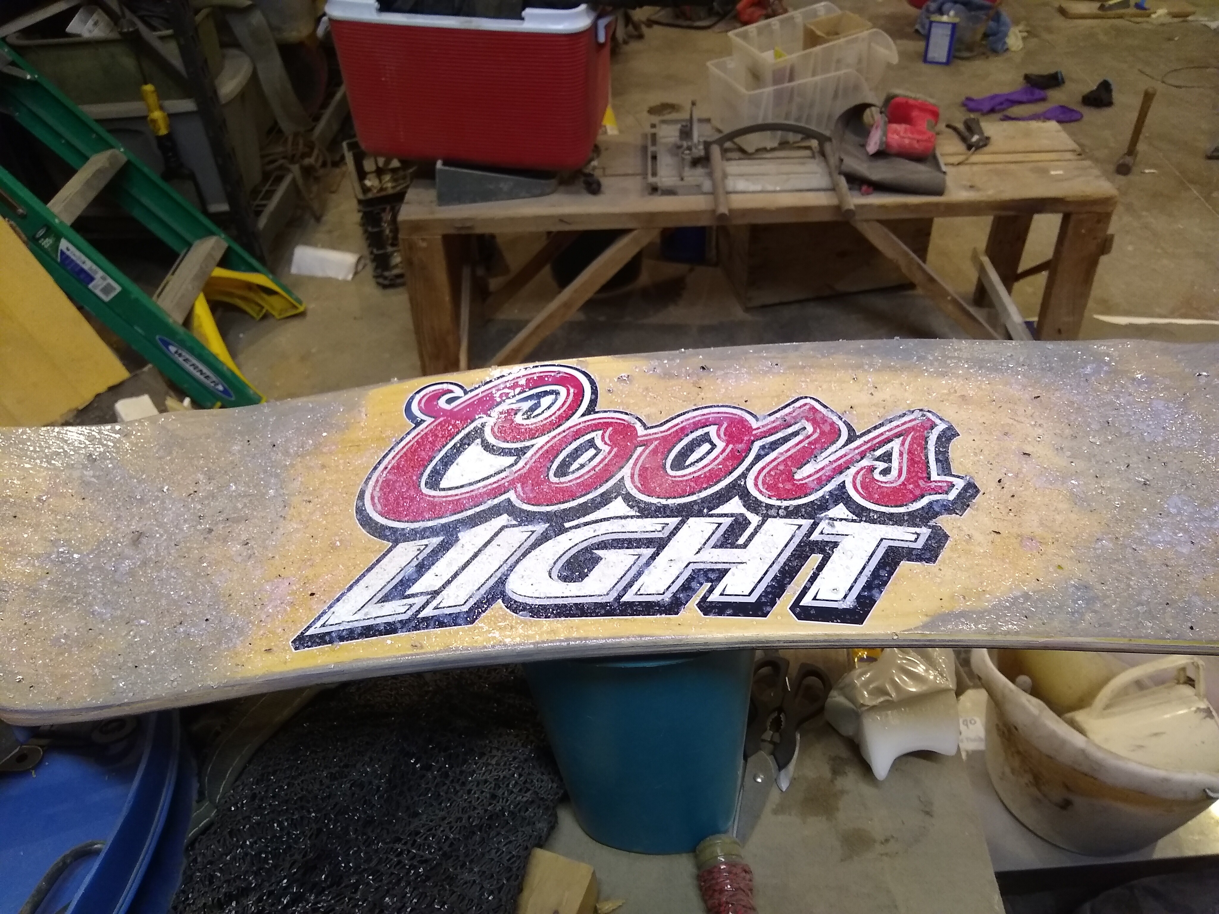

Forget the grip use Glass Frit
Don’t skimp out - grab a bag of low grade / low 4C lab-grown diamonds and shiiiiiine
Not completely out of the question
Edit: even better
I was more than half serious :smiley:
Cubic zirconia would be closer to glass frit prices, and stronger than glass.
crushed mirror. Literally from a ford F-150. Put the glass in a blender. Viola, frit.
you gotta call that build the “hold my beer”
Great minds think alike. I will give you 76% credit.

This one is skinned top and bottom and fritted (and I wrapped the side rails in retroreflective striping tape):
This one is just frit over the stock CF, with stained side rails:
I dont have the first clue what I would charge you, and I wont promise Sender-level results, but if you’re interested you know where to find me :kissing_heart:
Sliding my way in :duck:
What do you like to use for skinning? Cloth/epoxy
That first deck used polyester white on top and cotton plaid on the bottom. I dont recommend either of those. The polyester was fine, but it got really translucent when soaked through with the epoxy. The cotton was a total pain the whole time, and took like 3x the number of coats as the polyester to get a decent surface finish.
For epoxy, i dont use anything special. Tabletop epoxy from the hardware store has done me good.
