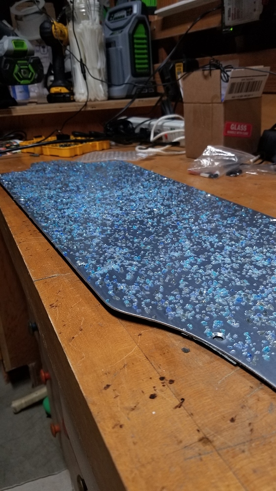

Forget the grip use Glass Frit
Same shit. Just a close up picture. Lol
tricks of the lens. Its like beer goggles

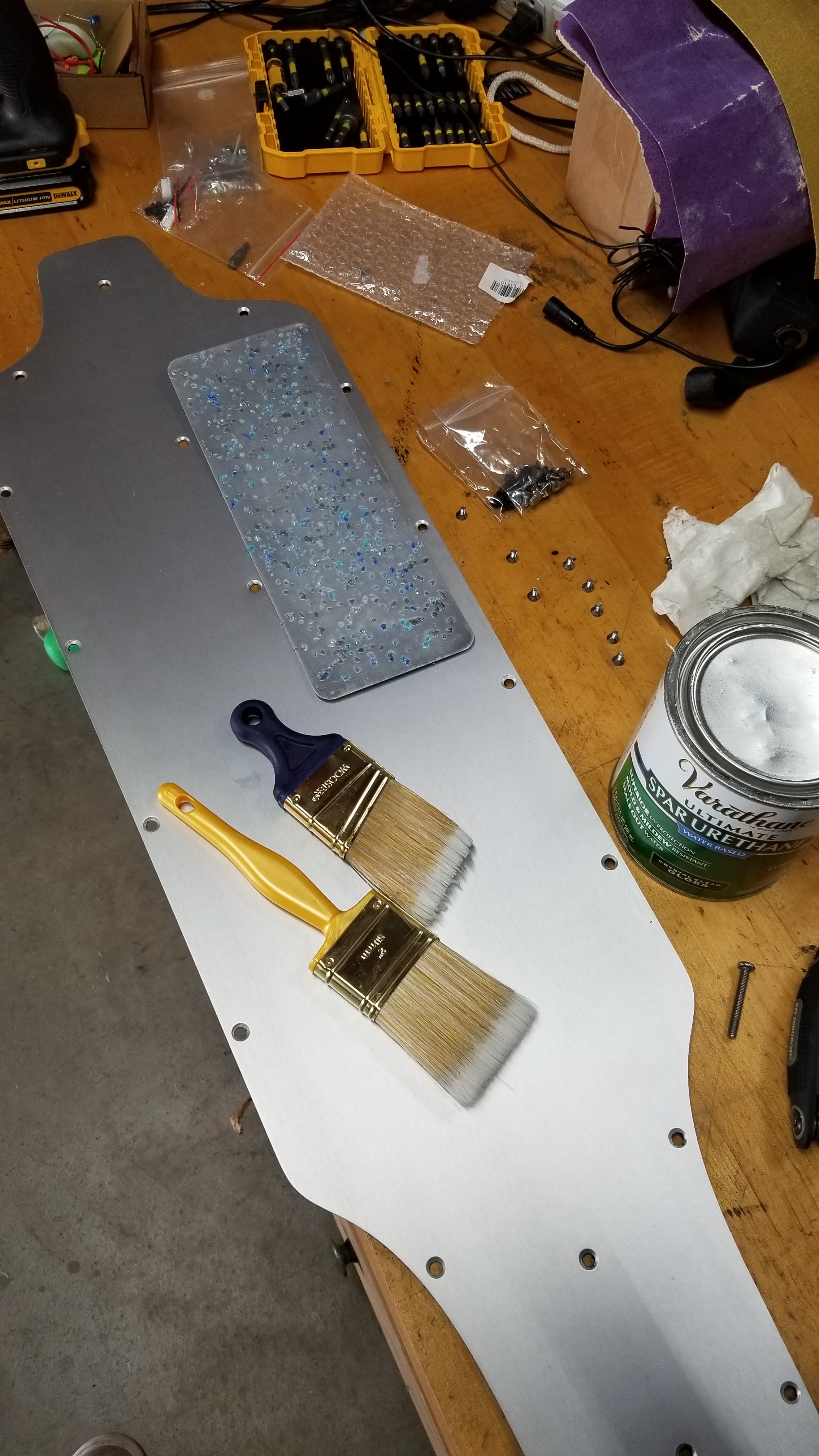

Can you recommend a fabric type that works better than cotton? First timer and I want to get the right thing!
Test piece was a success, time to do the real thing!
Quick question, should I put the haya cover on the wood or should I keep it separate?
Looking good, should be good to go later this week!
Pop Rocks are lookin good on that lid!

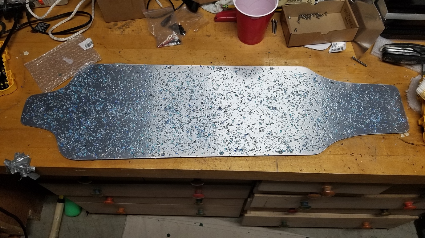

In the end I got this stuff
Should I go over the frit one more time after the glass step? I feel it is really sharp but idk… does it wear down after a while?
I suggest a thin coat over the frit. Will help it lock in and won’t be as sharp and pointy.
It will wear down over time but I have a board that has had the same coat that I put on a push board for 4 years and it still has plenty of grip.
Put a coat over it and it will be fine.

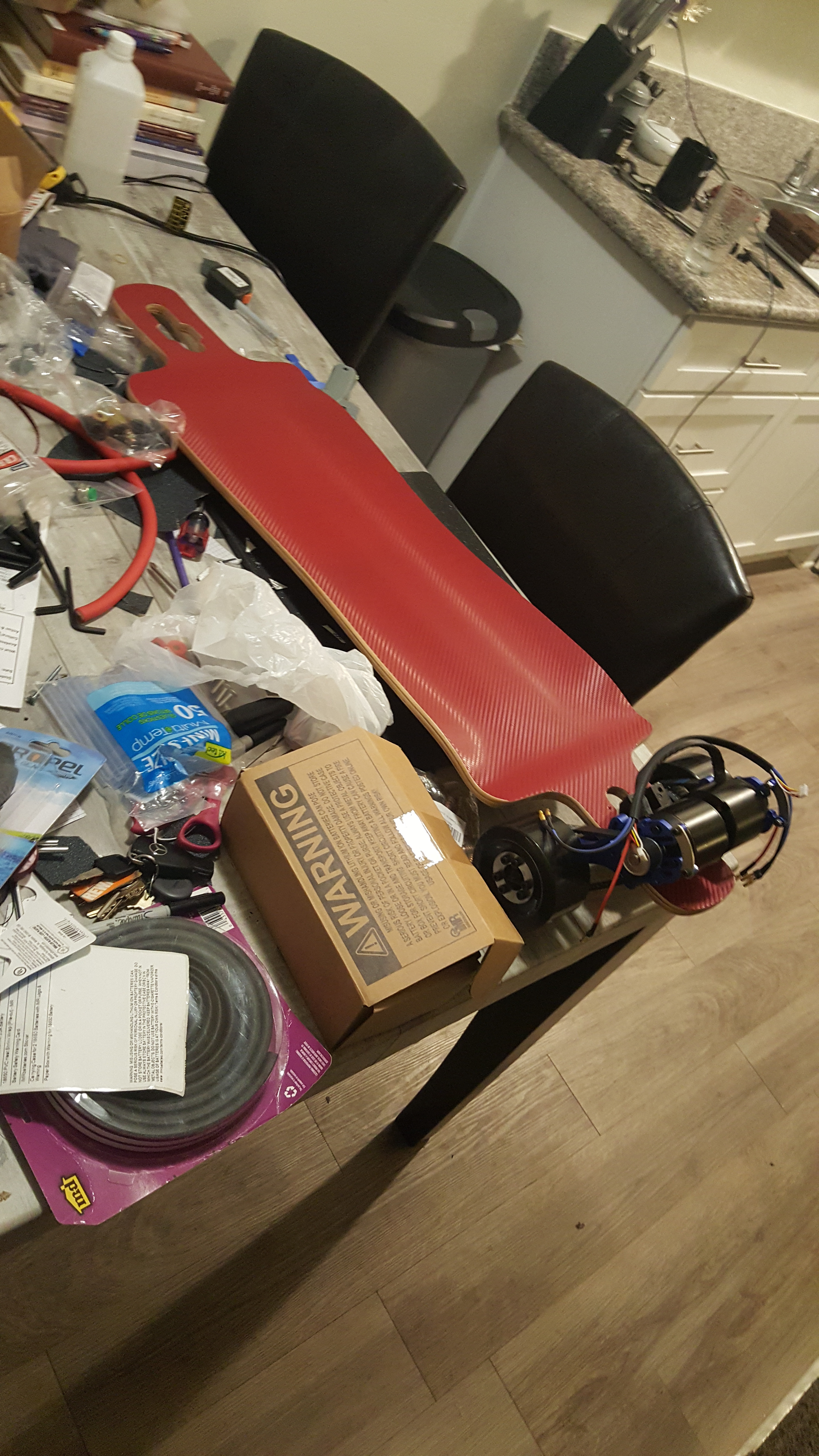

Soooooo… I’ve got a shit ton of loctite clear weld laying around, and some clear glass bottles…
Don’t see why it wouldn’t work, anyone else? I Want to coat on top of this red carbon vinyl wrap
Dude… don’t risk that marvelous demonseed with an unproven method… try it on something else first!
ho yes, like @glyphiks said !
See, just how @dougpage do :
Hoping you still get some of this vinyl or at least some remaining righteous.
Yeah I would try it on a spare piece of wood first
Whatever you use keep in mind that you’re basically doing glass frit on the vinyl not on the deck. it’s only going to stick to the board as well as the current vinyl is because the epoxy or whatever you use isn’t going to soak through the vinyl and into the wood.

Hey, that’s a perfect idea. I’m going to do a test square on some vinyl wrapped wood and report back
