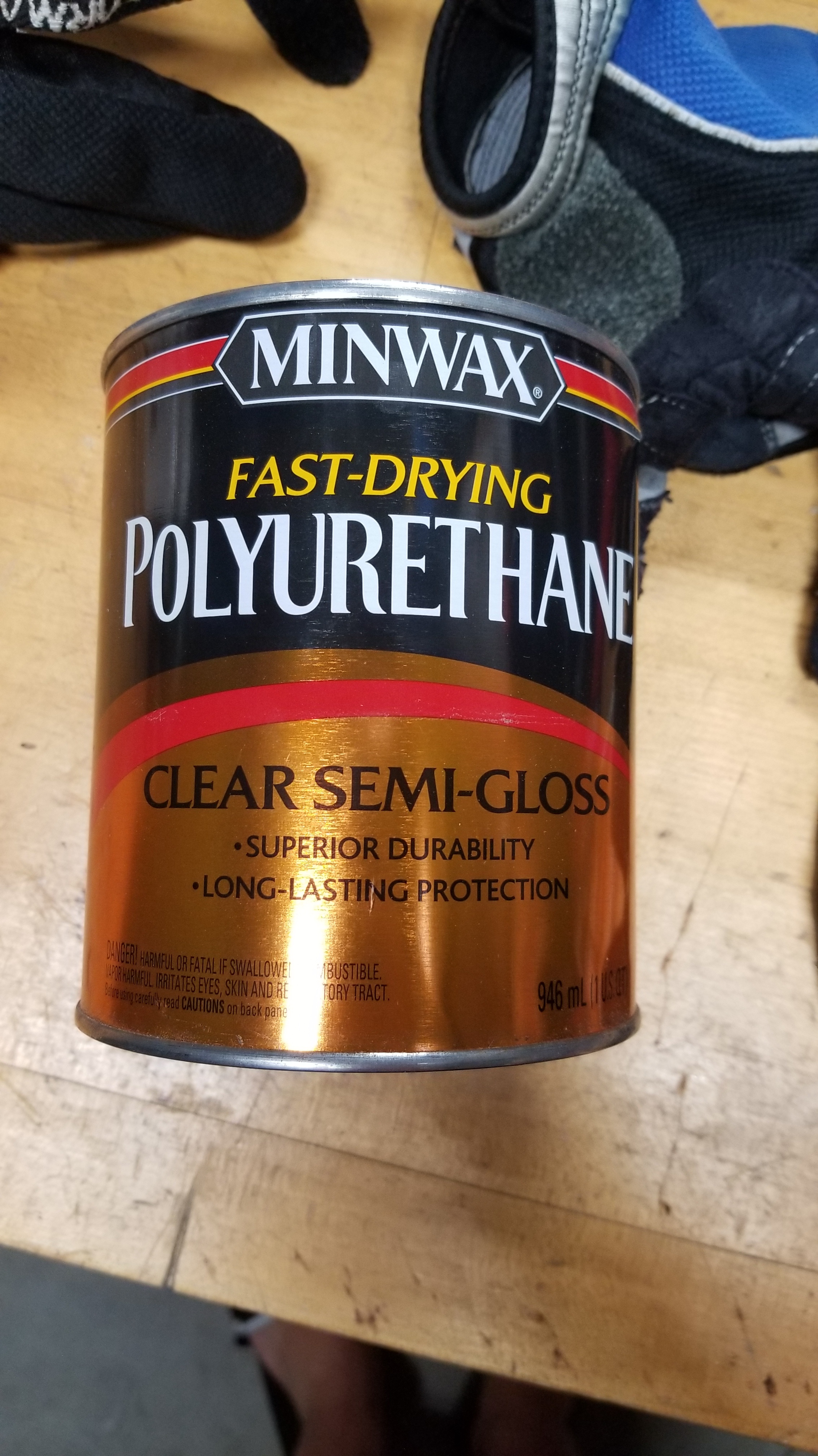

Which urethane should I use? Or should I go with some sort of epoxy?
I believe spar urethane is the common choice when using poly. Personally I love the glossiness you can achieve with epoxy. Clear as glass
I’ll test with both and will try epoxy before I actually do the boards. Thanks for your input
I am going to use a haya for my first time and I recently picked up some thin aluminum that I can bend into the shape of the deck. I can also test the actual material I will be using as well which is nice. Do you think this will work?
I have used the oil based poly but I prefer the spar urethane I buy the gloss because I like the way it looks

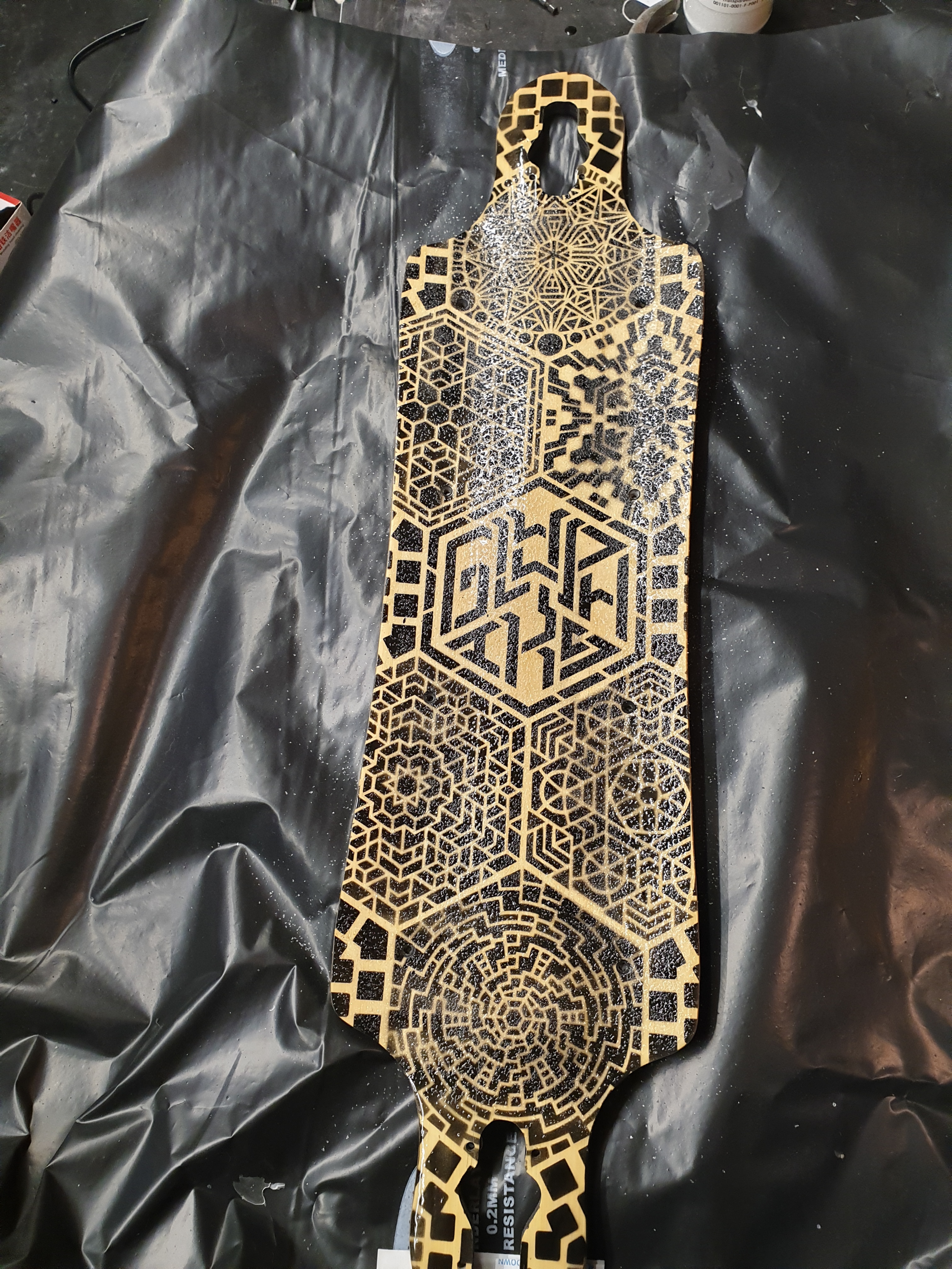

Fine frit this time, gotta put the layer coat of epoxy on tonight.
I prefer the fine frit as it doesn’t show up as much when taking pictures of the deck and you can get more coverage.

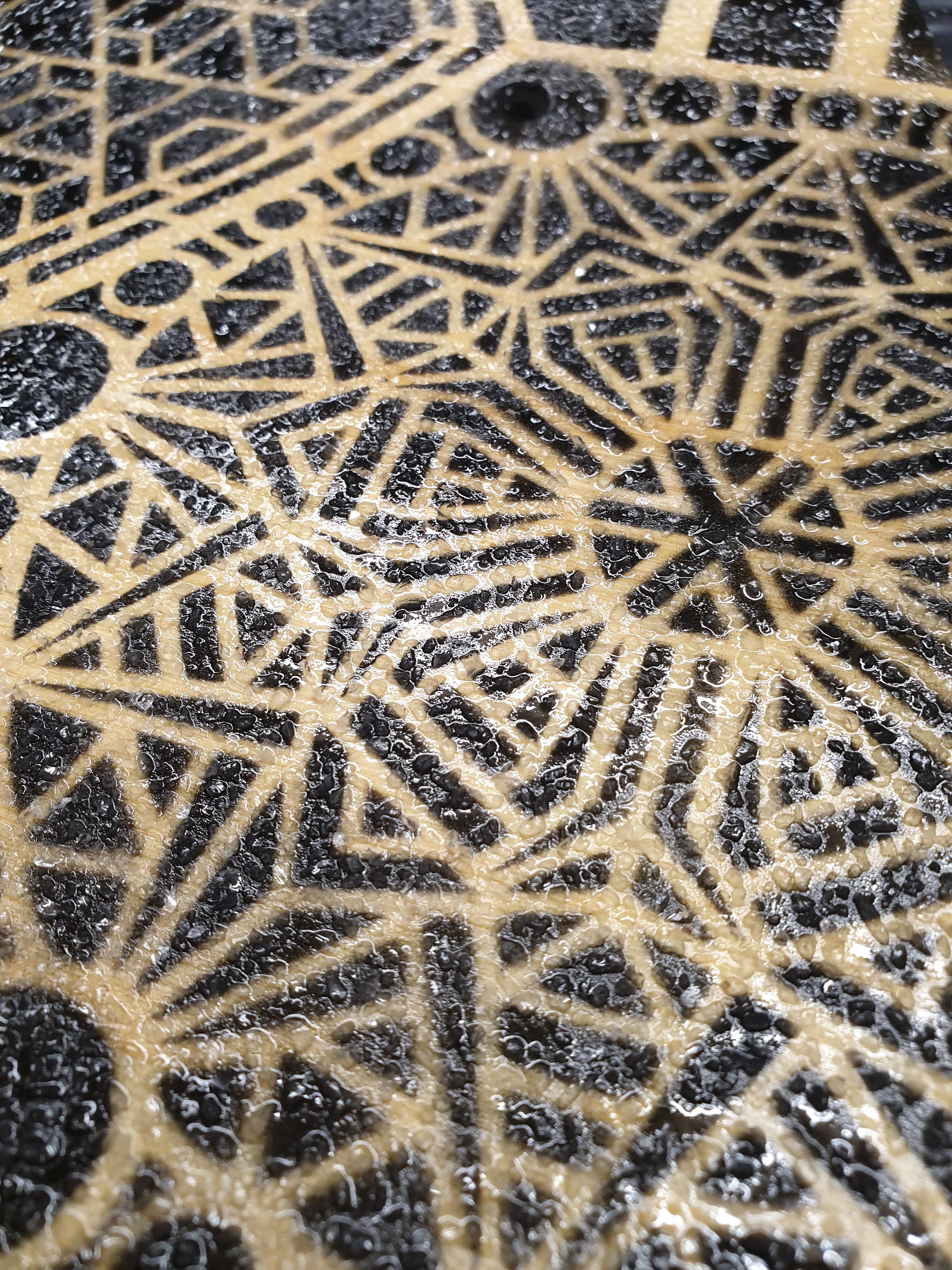

@Sender how many coats of epoxy do you put over frit? I feel like one is enough…
One coat. Actually on fine frit I don’t. It encapsulates the frit too much and you lose friction.
I was worried about that so I went really thin on both layers. Not dry yet but still feels nice and sharp :+1: cheers dude :call_me_hand:
Which fine is that? Looks a bit chunkier than the fine I have.
