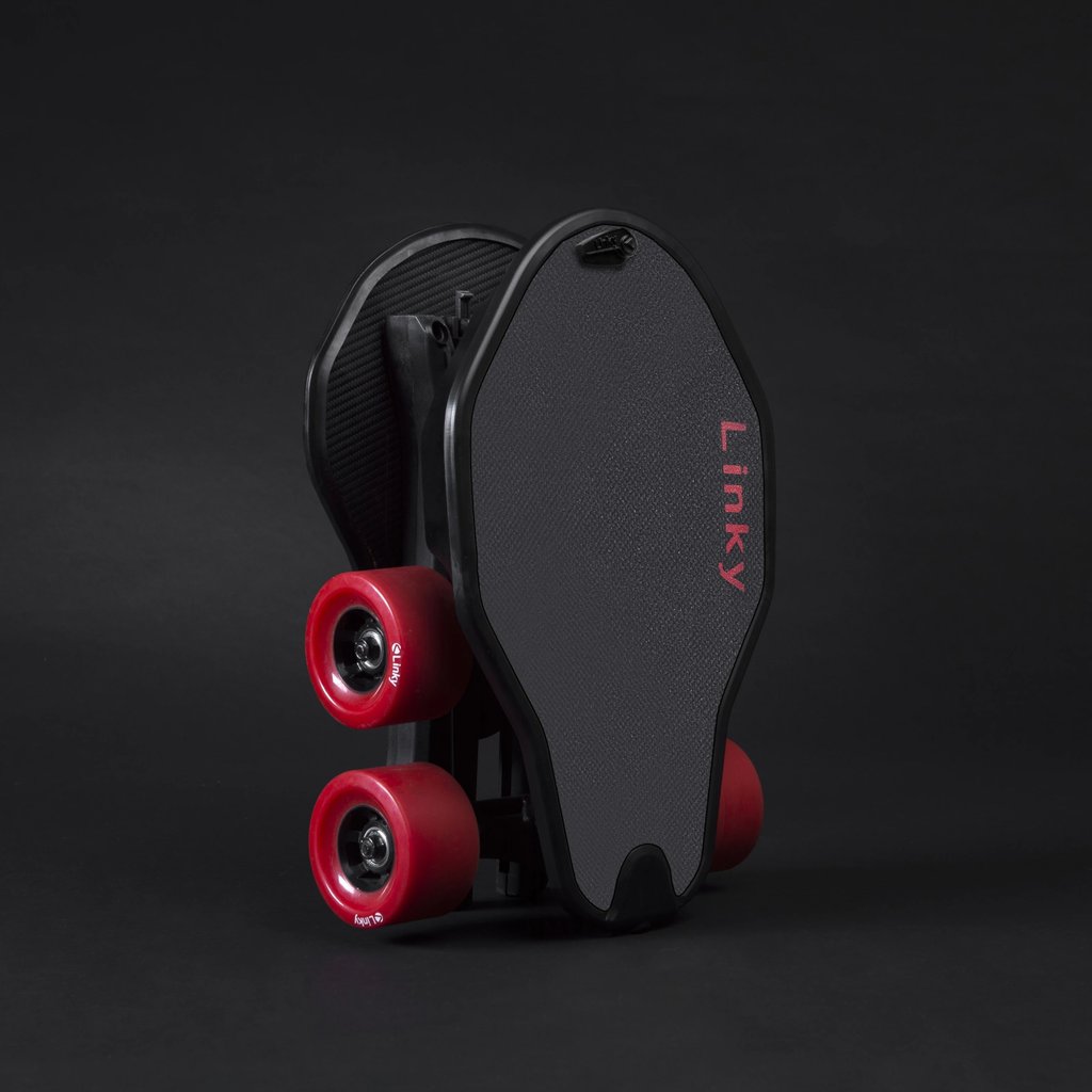

Is it something like this?
I’ve seen this.
It’s really cool and nicely engineered.
As far as I know it doesn’t have a removable battery and I heard that the folding thing isn’t latching all that well.
Also, the bases are flat, which might not be an ideal.
Anyone has an opinion on this one?
