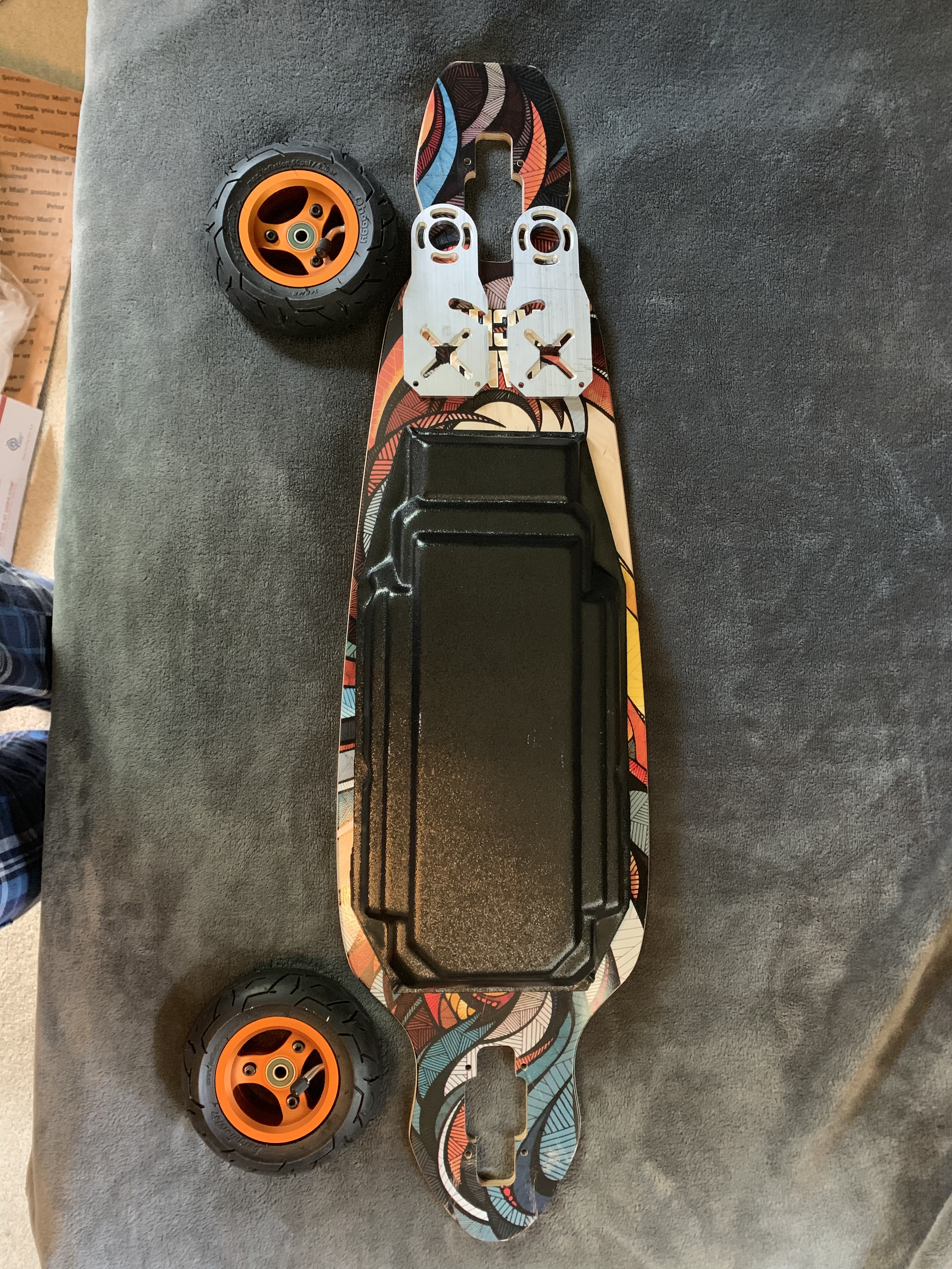

I have a custom pulley I made for the wheels that should be a little more compact and not interfere with anything, first print will be solid PLA an then I’ll outsource it to print in PETG or something later with some other stuff if I’m happy with it
Oh fuck yes!! Shout-out to skunk, Timo, and mmaner for these parts!!
She’s gonna be a dense one
The mounts will be replaced with cusom shield mounts down the line, for now it will get a sheet of Jessup original black because its free and its all I have on hand…its a little short so it will have a line of wood in the middle, will try for frit later

Wow, the layout is pretty sweety ! I love this graphic illustration !! ANd perfect with the gorgeous Breg :+1:
It’s gonna get some red/orange dynamic underglow eventually, its gonna be HOT :fire::fire:

Damn. That’s a good fit
I took off a decent amount of material from the enclosure with a band saw compared to when you had it, I’ll just barely have enough edge to stick the lights down and add the handle. I love the small size of it though

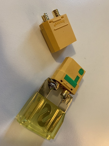

I now have what I think is the first 100A loop key? If I can’t risk a fire, I plug this in and if the ESC or something shorts then this will blow first. If anyone has 2" of 40mm heat shrink the wanna mail me…
I think you’re able to but fuse wire or fuse nickel (as used for cell level fusing), could give a better form factor
I want to be able to replace it on the go though, on campus I cant risk a fire but on speed runs I can’t risk loosing brakes
But how will you solder / desolder on the go?
