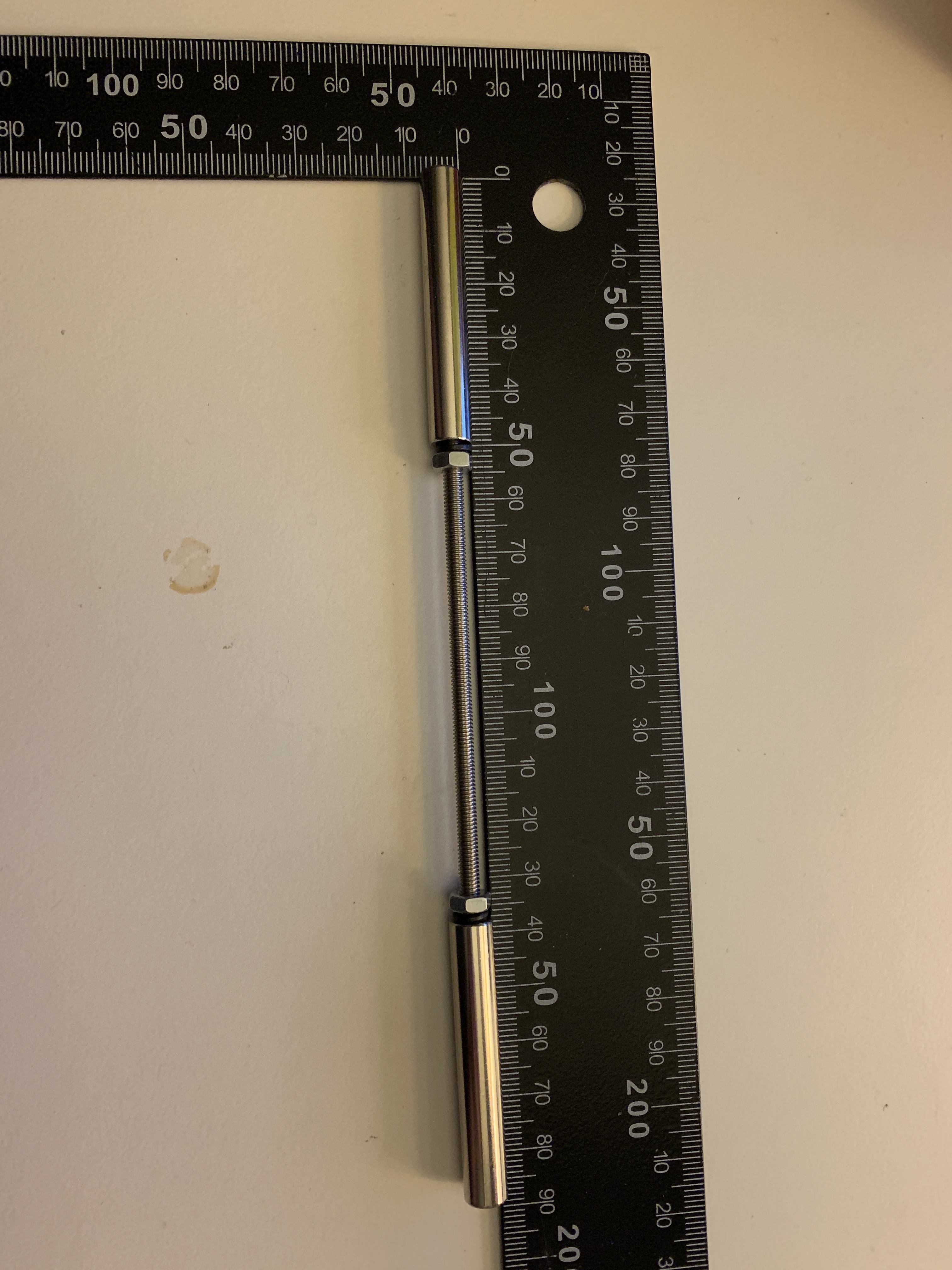

Cross braces to keep it all aligned and protect the motors because why not
Just some threaded rod and nylocks? I can definitely add a few M4 ones
How many were you thinking?
3? 5? Definitely an odd number
Sounds good, I think dickyho has some adjustable ones and I’m getting an order from him anyways

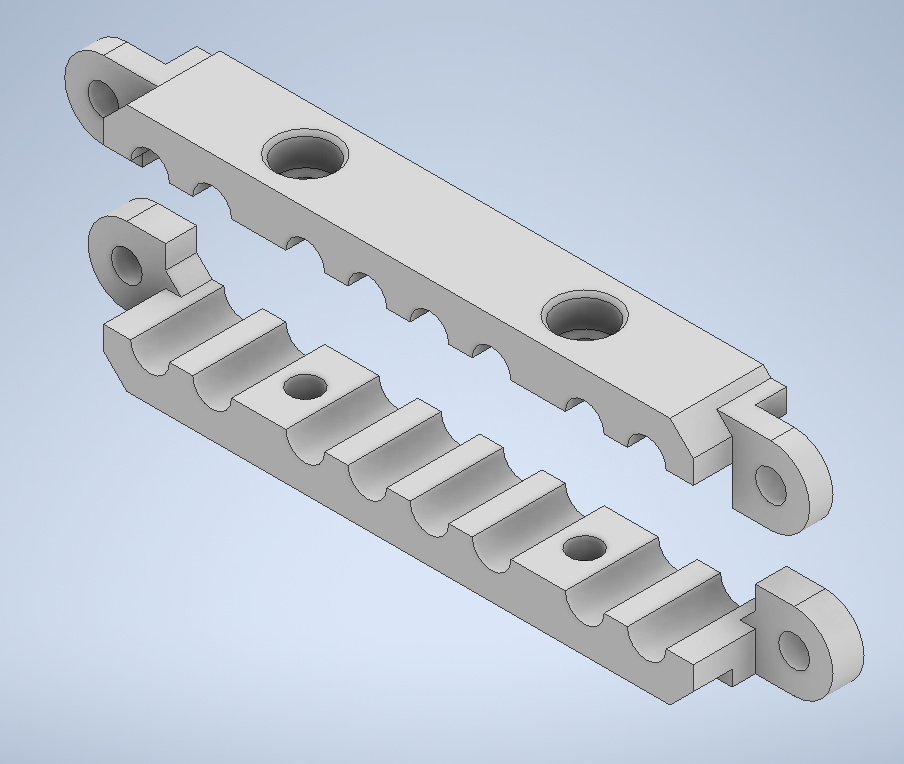

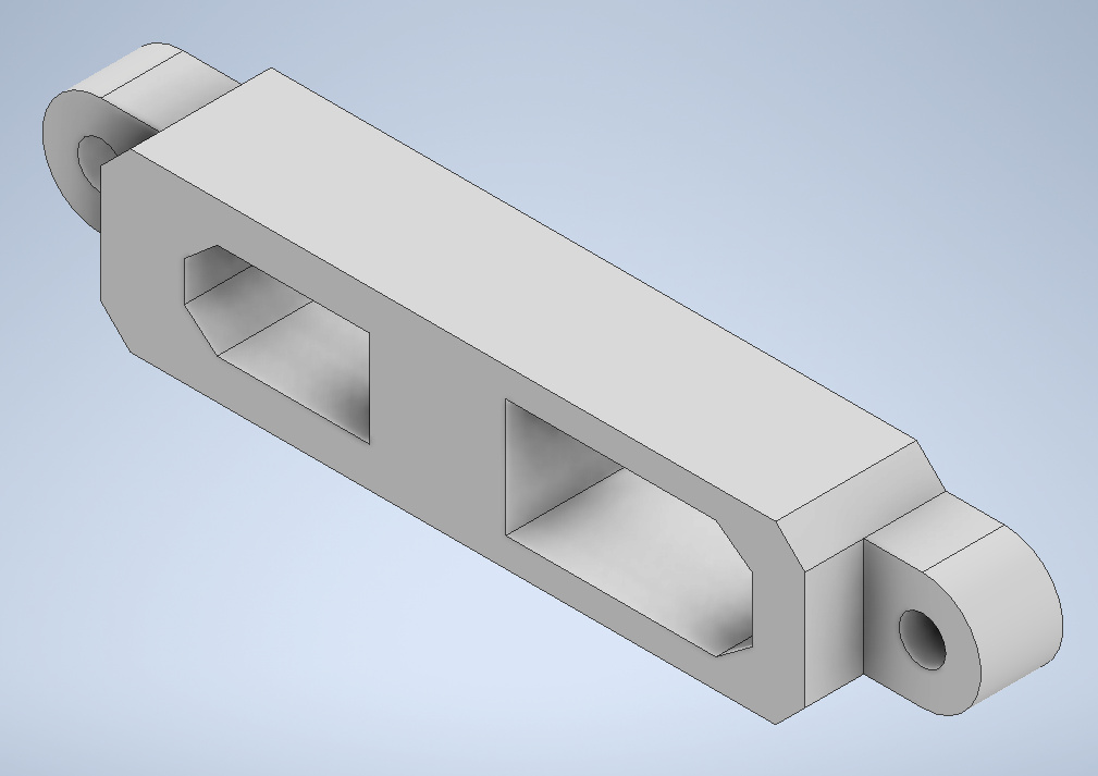

Made some prints for the charge port/loop key XT ports and the phase/sensor wires, they will bolt in from the inside with a pair of M4s and be sealed with some JB weld…its not conductive right?
