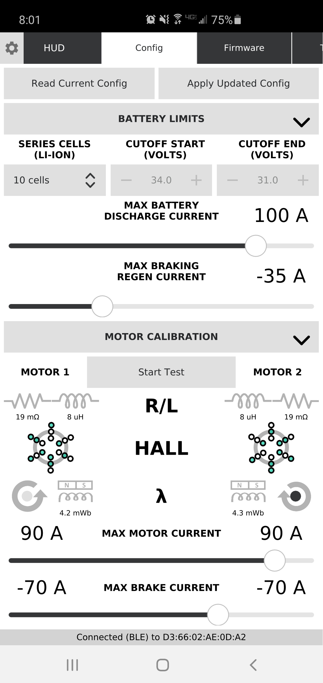

Please post your motor detection results from the focbox UI page if you were able to get that far
Android version, unable to upload config
With the tool upload possible but smooth start issue
Aside from your inductance and resistance values being a bit higher than I usually see, it looks normal to me. Hall sensors are detected. I’d try reflashing the firmware and see if it still happens.

Anyone knows why in the focbox UI battery current is limited to 120 A ? I have 2 motors in 80A and 12AH 15C Lipo. So i generally use 160a but i could only configure it with the tool.
Motor setting on the unity is per motor. I set 90A to each motor just fine.
Yes, for motors, but for battery discharge current ?
Battery is total for both sides, not individual
This is the point, focbox UI does not accept more than 120A for battery discharge, not enough for both 80A motors
You will likely not ever pull that many amps but yes the computer tool is the only way to go above 120A.
