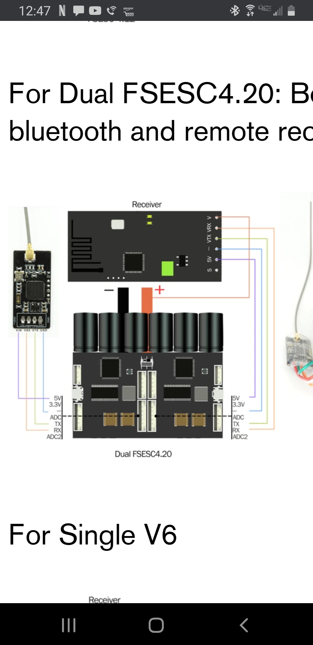

Yeah seems like that would be a good move for them. I think I’ll stick with my Mini. I’d like to try the vx1 but the receiver I have is made for VESC 6
iirc u can just get the correct pin layout cable, and u will be able to use the same receiver on V4
And where might one find the correct pin layout cable. And perhaps I can rearrange the wires in the v6 just that came with it.
its just matching the receiver to correct pins on the unity, depending on if u want to use ppm or urat mode
If I use urat I would use COMM port right.
So i guess I would use the receiver diagram off this and the unity diagram
I’ve been using the VX1 and VX2 with unities for about a year now with no issues. Just don’t use the push to start feature on the unity with them, there is an issue there.
Correct, COM port for URAT.
all u need to do is make sure the correct pin match the unity diagram, then it should work like normal
this method just saved u from buying a new remote lol
only cost was few mintues to rearrange those cables.
