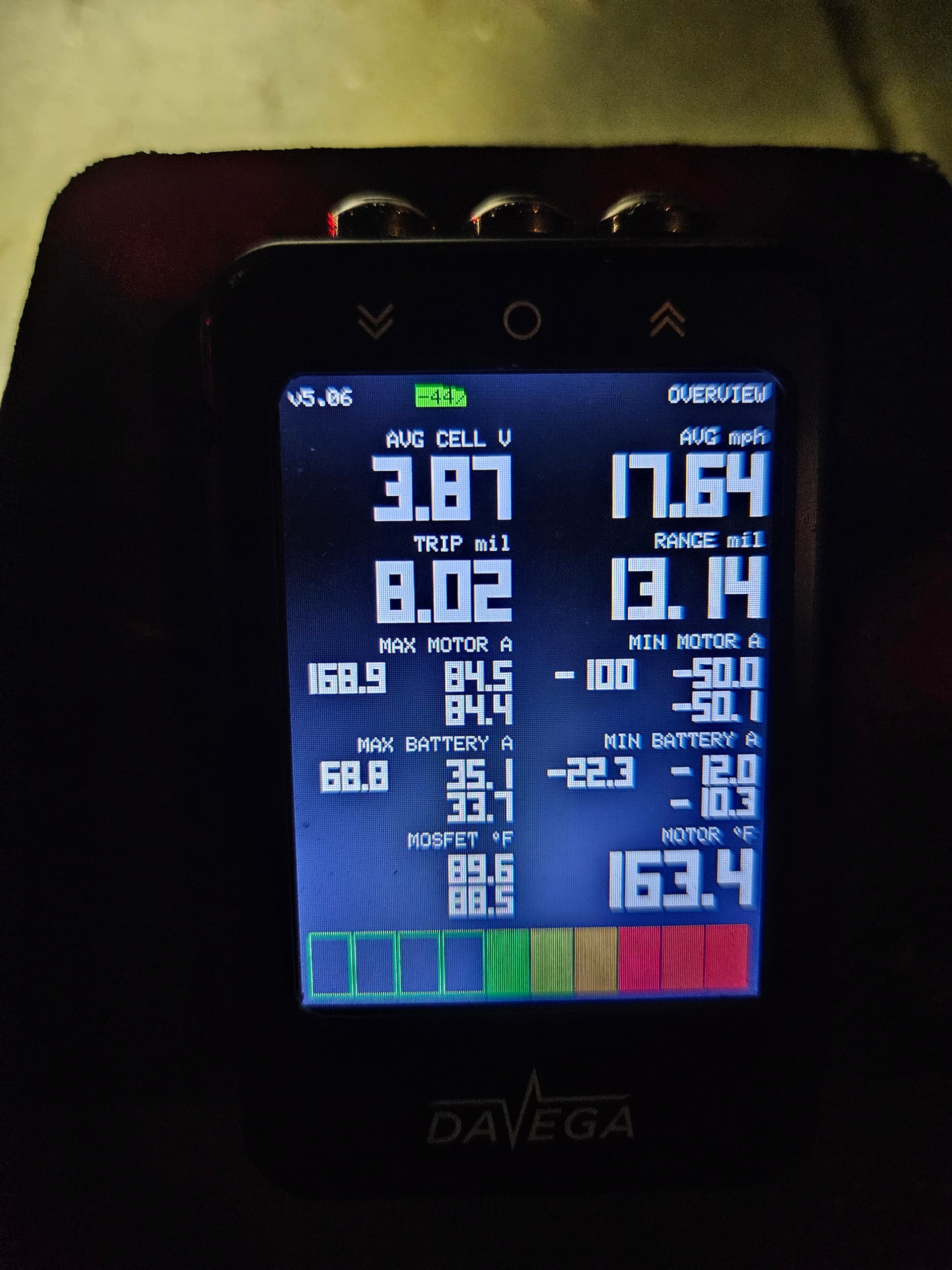

Noticed my board was throttling going fast up hill. I checked the info on Davega and it reached max mosfet heat. Motors are also getting hot. My settings might be a bit high, just trying to get the max out of it.

bigger motors will help your motor temps due to the additional thermal mass, but won’t make a difference for your ESC temps
do you have a heatsink for the ESC that’s exposed to airflow?
ive heard that people lower battery amps to get their ESC to run cooler, haven’t tried it myself tho
i was thermal throttling my ESC even in winter temps… added a heatsink and it stays cool even on hot summer days :ok_hand:
edit: just noticed the temps in your pic are in farenheit, so those numbers are nothing to worry about… is that peak temps?
89°F is not even that hot for the esc temp
that’s, like 30°C, you can go up to like, 80-100°
your motor temps are however, pretty toasty, you can eek out more by raising the limits but it’ll probably not do much
bigger motors might work, but you’ll likely still run pretty warm, probably round 60°C if i had to take a guess
Motor temps are causing the bottleneck here as others have said. The 1:3 ratio on 6" tires isn’t doing you any favors here, neither are the maytech motors. Easiest solution here is to pick up larger, better motors

I took that picture when I blasted up a long hill and felt the board act weird.
It does have a heatsink for the Unity.
That is the hottest I’ve seen it get, it has done that weird thing a couple other times.

your esc only reaching ~90°F like ever is like
really cold
(btw motor temp ≠ esc temp)
3DS doesn’t offer spare motor pinions based on their website so your best option is changing out your motors.
reacher 6385 is good, you just need to double check that it will fit, iiiirrrrrccccccccc the overall length is 92mm? i could be weong tho someone’ll have to fact check that value
you can also double check your esc settings, maybe the temp cutoffs are too low and can be raised a little.
also double check your gear drives, they could be assembled without any backlash, causing more wear, friction, and heat. your seals can also lose lubrication, causing more friction
