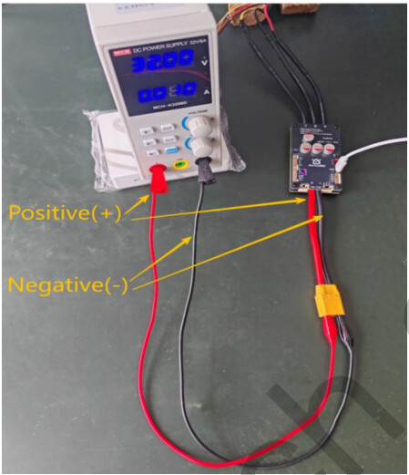

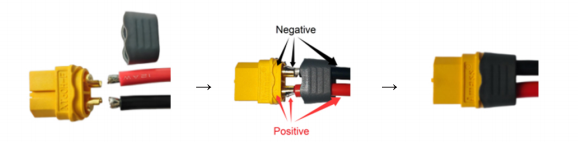

Hardware Check: Polarity is life. Red to (+), black to (–). Reverse it and your ESC is toast before you even blink.
Voltage check. Don’t exceed your ESC’s max input. Permanent death.

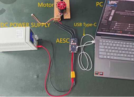

Hook up motor phases → USB-C to PC → battery last (polarity check x2).

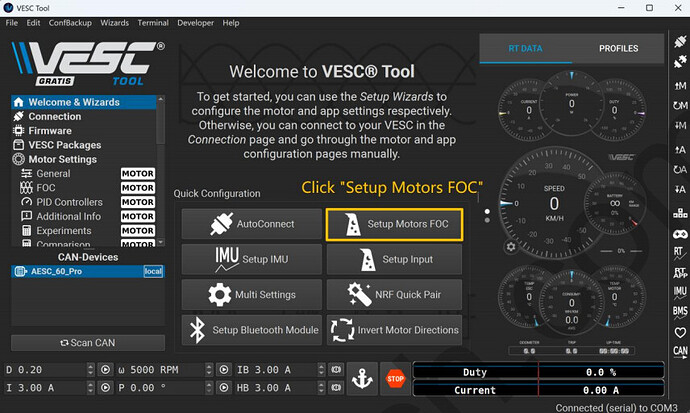

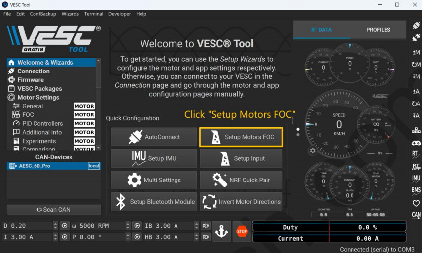

Open VESC Tool, hit AutoConnect.
Click “Setup Motors FOC” . Say YES to factory defaults unless you’ve got a reason not to.

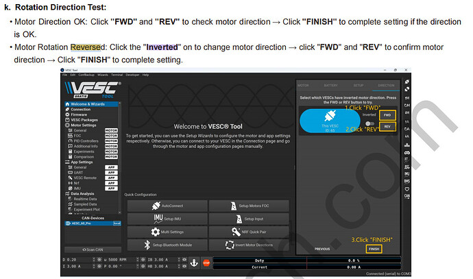

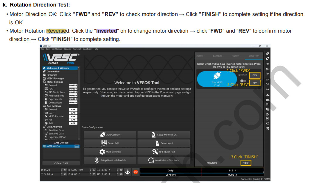

Test FWD/REV – if reversed, toggle Inverted, re-test, FINISH.
