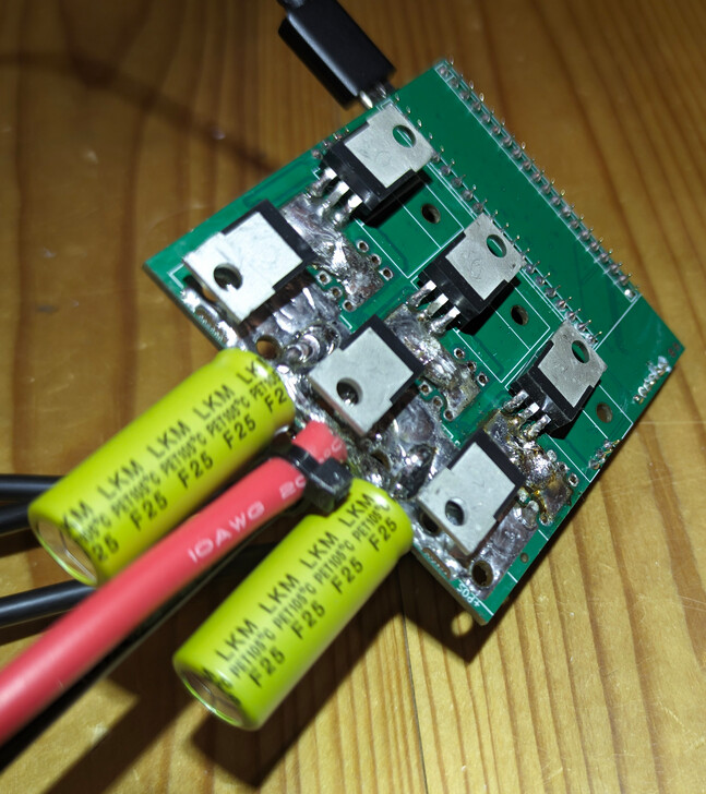

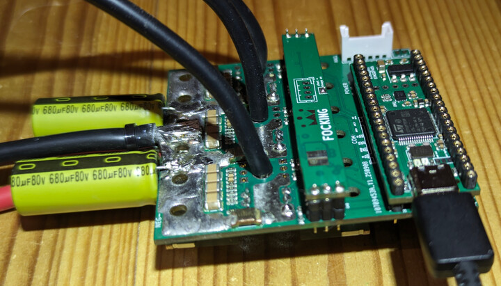

I have soldered my first board and it seems to work! Didn’t test higher loads yet.
Could someone help a newcomer with a few questions?
  1. 6 vs. 12 mosfets - what is the max current in each case?
  2. I would like to test MESC for quiet HFI - does anyone have the header file?
  3. Is there VESC bldc source code somewhere? I see a patch for the BMI270 IMU in the nordstream3/FOC repo but it references vesc’s hwconf/FOC_KING/hw_FOC_KING_core.c file, which not present upstream.
  4. The photos in the assembly guide are quite outdated, is there any interest to have them updated?
6 vs 12 FETs depends on the FET and also on you cooling. I use 12 crst030N10N in a onewheel. I set max phase current to 160A but I never really reach 160A. I think it would also work with 6 FETs. Cooling is also important. My FETs are screwed to a 3mm aluminum heatsink, the vesc is mounted to an alu die-cast box. Runs smooth for over 1000km so far. Also stays below 50 degrees C.

I had some trouble bending all the mosfets exactly the same way, so one of them does not want to go 100% flush against the heatsink..
This forum has informed me I can now upload pictures, so here is where I am at:
hard pulls=full throttle-full brake :grinning_face_with_smiling_eyes:
No, i didnt noticed any problems with shunts, working fine.
