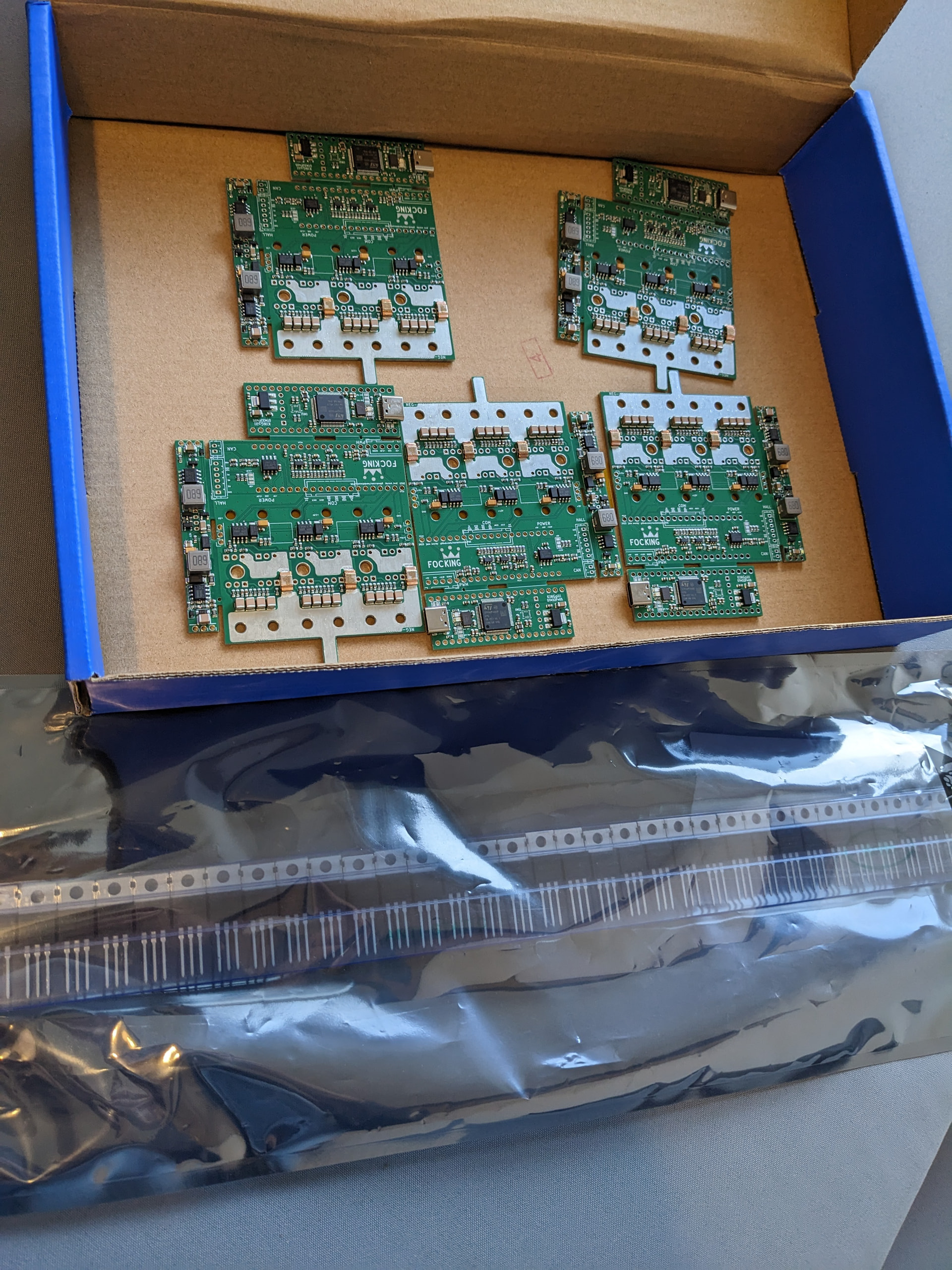

Got my PCBs and Mosfets today :star_struck:
You cannot buy FOC King vesc as a product, you need to build it, unless you get one from soneone who built some extras.
