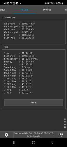

finally after my vacation, I got it to work . Momentary switch is to twitchy so i needed to turn on the board with a different lock switch. I destroyed one freedrive prototype because i got a short with the heat sink screws against the mosfett through hole. i used nylon screws on the other board this was working. During the assemble i had another issue with the power board for some reason the small cap on the power board on the vin shorted out and destroyed the trace on the board so i needed to connect the current sensing with a wire. It was with 20s. I hope the cap died because i reused the power board from the other board with the new power board this seams to work. Here is a short video after I managed to calibrate the complete board I am going very slow this board is fast. The only issue i have at the moment is a wrong speed calculation i need to fix the wheel parameters in the VESC settings:
Sorry for the bad video but it is getting late today:
Here is a better video from today after fixen some vesc parameters and small hardware issues.
Max Speed i tried was 30.4kph with around 45% duty cycle :smiley: . This thing is a monster. 30kph was easy like a walk .:slight_smile:
@jens_overby I will test how good it works with 20s but so far i have like 5-6 km on this board and everything seams to work flawless.
… but I am still a bit stressed till i get confidence in the overall build ,-)
Here another video i did a 9 km run on the street, dirt road and even grass and forest roads. All in all there was challenging terrain but the fets were 50° C max.
I charged the board to 100% and did the test:
https://www.instagram.com/p/C9hT7V0Iudt/
i still taking it slow , still need to build trust in the board :smiley: so today i went 25.4 max. I keep you posted on the perfomance of the free drive. At the moment it is doing very well!

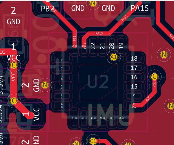

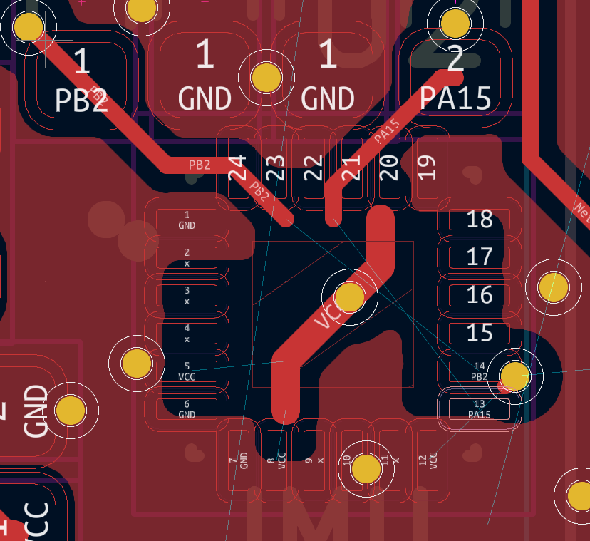

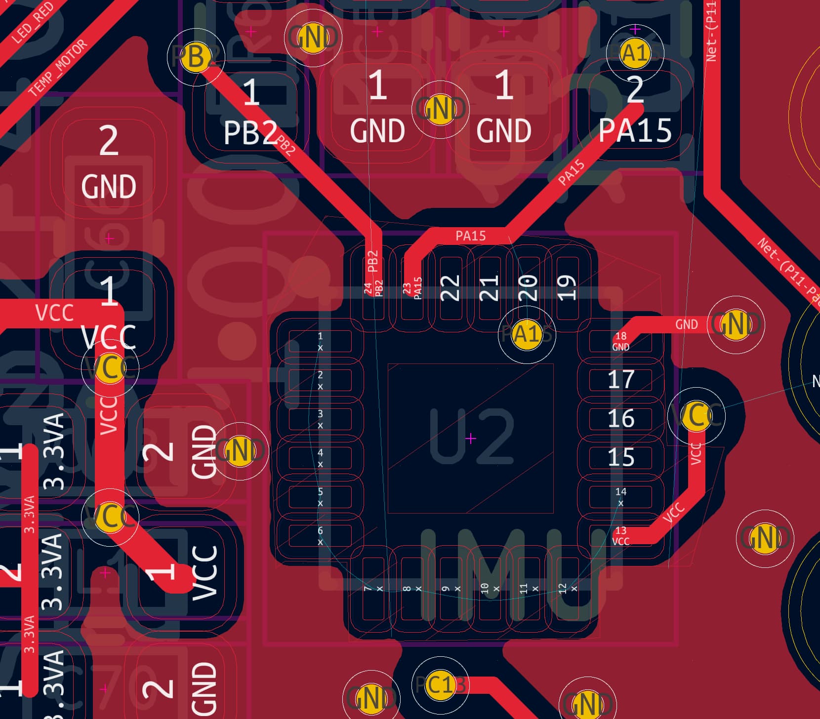

Also I guess we need to change to a different IMU. Its getting harder and harder to order with a BMI160 i guess.
Maybe we should use ICM-20948 (with some adaptations to the board it should work to implement this footprint)
@jens_overby are you still on the project?
So i tried to change it to the new IMU. I am not really a PCB designer so don’t judge :smiley:
Sry fixed some issues. I dont know if something like this will work but with that we should have some alternative to the bmi160.
