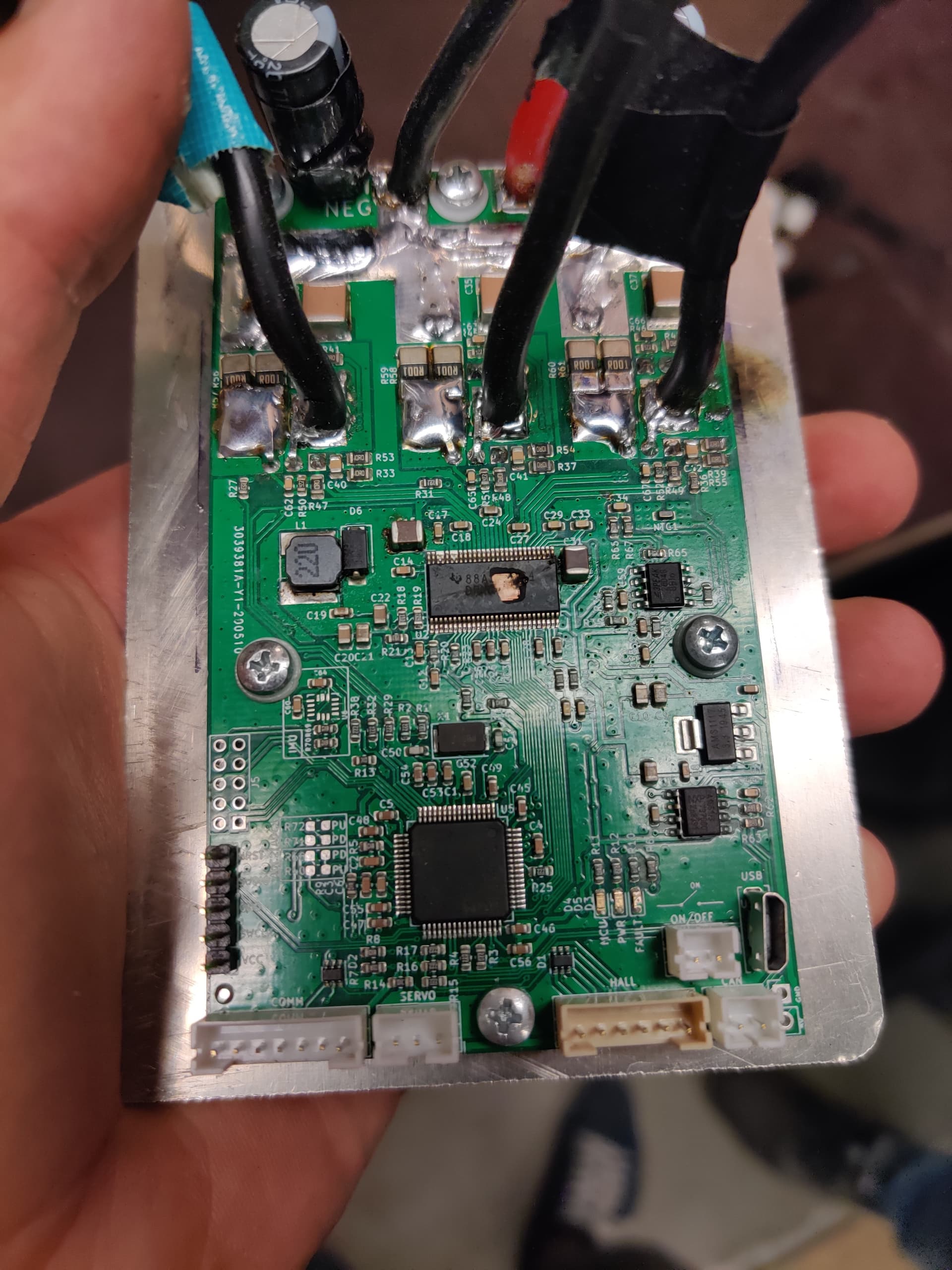

No more green leds, so I took yellow instead.

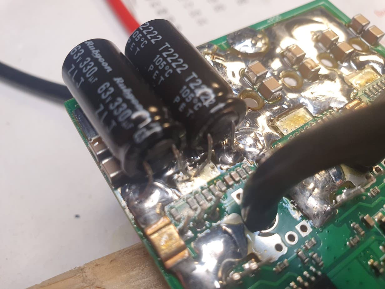

I looks perfect man… :slight_smile: What about large capacitors? I don’t know if you’re using those from the BOM, but I just found an error yesterday in the LCSC order number. It should be C443085, and the BOM and documentation is updated. However, if you don’t plan to go to 75V, you can find some that are cheaper with 63V spec. You should go for D=10mm (diameter), then you can mount 6 of them - it will fit the spacing on the board.
I think it is more or less random. If you don’t order a lot at jlcpcb, maybe they go more in detail with the review, because you’re more likely to make an error if you’re a novice. I think you just wait for the next shift to start working, and it will pass through.

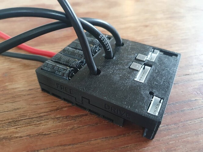

Six capacitors of diameter 10mm will fit the board. Don’t let the capacitors pass through the holes in the board. Just solder them to the surface.
(here I actually used 63V 330uF. Those in the BOM are spec’ed for 80V (5 mm longer)
Bending the caps at the right spot is an advantage, if you want to use the screw holes at some point.
Even when the power module is attached, you can get to the screws with a small screwdriver. But the accessibility of these holes is something I need to fix in another version.
Just a side note guys…those ceramic caps are being drowned in solder and that can crack the caps. They hate that much heat.
Same for any components…minimize the soldering time and don’t trap them in piles of solder that will expand/contract when thermally cycled. That’s another way those ceramic caps can get cracked.
Don’t try to lower pcb trace resistance with solder. Redesign the board (larger planes, heavier copper, etc) or use “bus bars” (solid wire, whatever).
Don’t use that much solder!!
