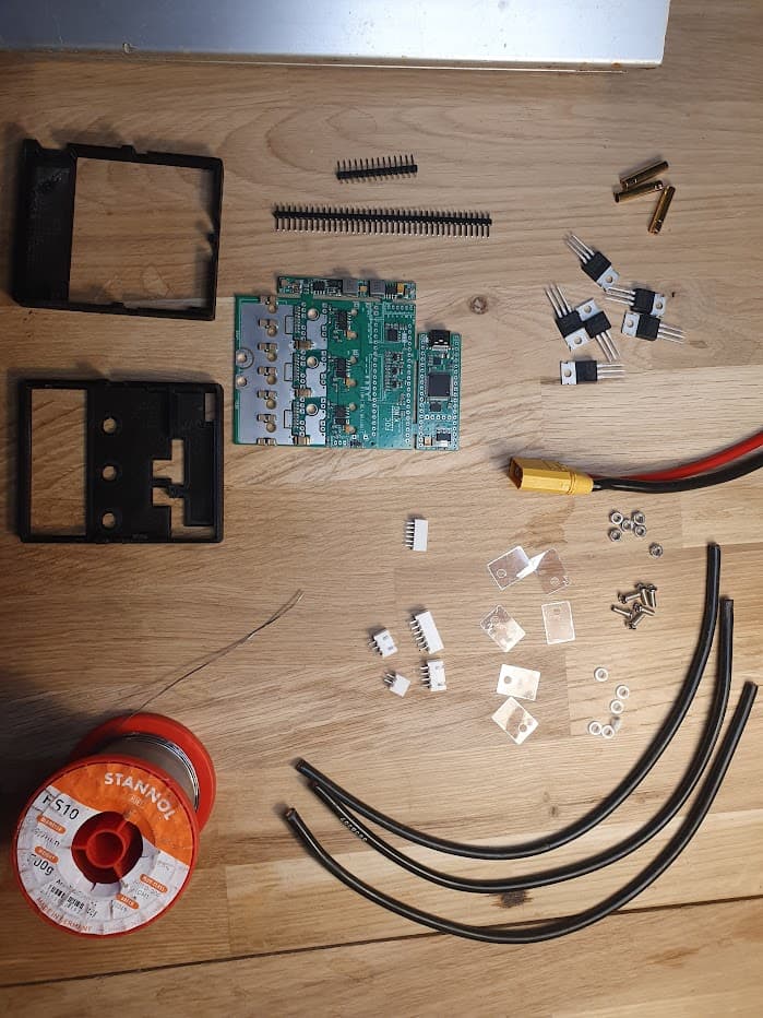

FOC_KING - 84V 150A, open source vesc6 board V2.0.1. JLCPCB order
Btw, this is all the components you will need for a complete assembly:
(+ aluminum plate for sinking heat)

works great! . Today I also got the caps and fets :slight_smile: So i try to finish it this weekend.
I recently ordered 10 board - all assembled (incl. shipping to EU but excl fets and 330 uF capacitors) for $241.08
Remember to put solder on big planes on bottom side BEFORE mounting fets.
And the same thing on the top side before mounting capacitors.
