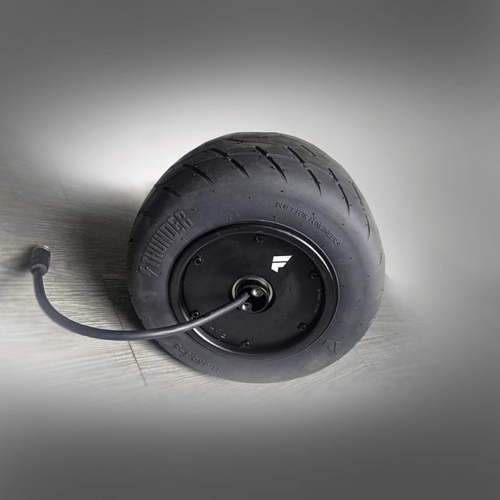

Don’t buy those Ali motors. Try this:

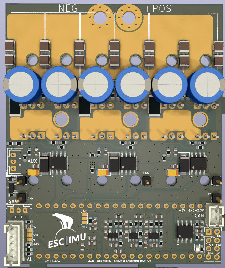

Waiting for the updated main module to arrive…
Are you thinking this one could be ready for release?
I would try separate those battery terminals abit more, Might just be the pictures but they look too close for comfort. They seem to be in the middle of the current carrying polygon tho, which is good.
Whats you’re isolation and creepage distance?
I’m testing it at the moment. It needs a few pull down resistors.
