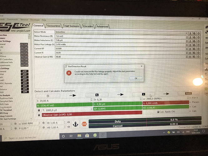

Flux linkage detection failed (Motor detection)
Hey, I came across this issue, where when I am running motor detection, I got a message saying “Flux linkage detection failed”
I have made some researches on other forums and all I found is that I should make sure nothing is obstructing the motor while having it turn.
I have found something quite odd, when my board is on, the “broken” side has the motor applying resistance on it, when it’s powered off, nothing happens and the wheels could freespin.

Set your current a little bit higher in the motor detection and try again to run the detection.
When I turn on my board, that side feels like if it is braking, without any input from my side.

Hmm after this, I just can’t have it detect the flux linkage.

Any idea why is there that error?
Edit: when turned on, it just brakes without any input, I don’t know why is it doing this behavior.
