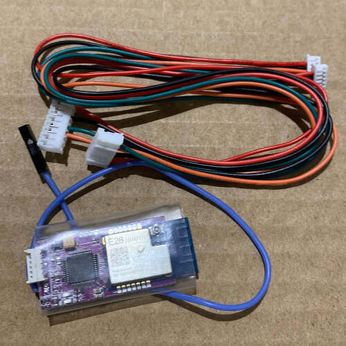

Are spare receivers available somewhere?
The firmware to update the gear lock is on the remote, not the receiver.

The changes we have made so far are reduction of the hardware deadband. So they you can adjust the deadband if your liking in the vesc tool. Originally there’s a deadband that can’t be reduced further as it is fimware implemented.
We’ve also got gear lock option in the settings so you can toggle speed mode lock so that there’s no chance of the low speed being engaged on a landing or crash by mistake.
And of course the apex startup screen.

You can dial the remote in uart mode too, just not as intuitively. You dial it in in the “Vesc remote” tab. However, if you reduce deadband here. Before the update, you still couldn’t get the remote to start from the first micro push of the throttle. @Jeep pointed this out to us.

There is a point between 0 and 1 that the brakes almost lock up… If you just touch it, can be dicey… I’ve tried many different adjustments and it’s still there but if I simply just pull back it’s fine. You only really notice this on the board at speed, not on the table.
I don’t have this with ppm.
I explained this to flipsky after the update but they just blew it off and I changed to ppm.

My first one started experiencing some flutter though at a very specific throttle point but idk why yet
The potentiometer unit has changed since the earlier models. Perhaps there’s an underlying reasoning for this.
Maybe that’s it also. Mine is one of the first sent out.
I have a second one that I bought recently. Might try it on uart see if there’s a difference, I’m using a davega on both boards also so uart is kinda pointless for my setup.
